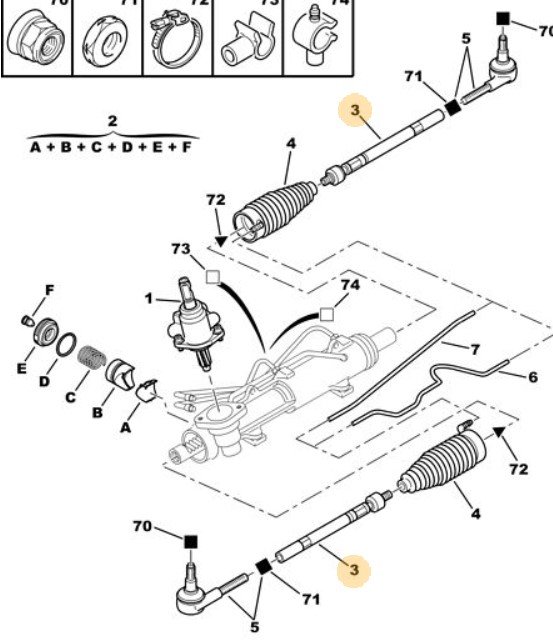

I have not looked yet, but, is this adjustable or will it be new rack?

Looks like the tie rod is available separately.

Thanks, was hoping for adjustable, but hey-ho, tie rod it is, looks like they'restill available!
