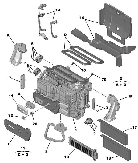

Hallo i change my cabin filter, and i could feel some kind of radiator, behind them on the i side of the flow indtake.
Is it the heat or something els?

Be very careful around there, there are some sensitive components, but I think you are referring to item (10), which is the Air Heating Resistor.
This is used to help heat the cabin in colder temperatures whilst the engine is heating up and helps with demisting.
Hopefully the diagram will show you where the pollen filters are at (17) & (18).

Okay i thought it was the heat matrix. Maby i can feel if the right side is colde, after a drive.
Can tell med if the matrix is cloged.

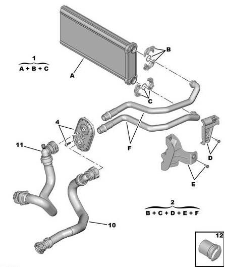

It could be, but I obviously can't t see what you are looking at. Matrix:

I can only se the electric heater thats located infront of the heat matrix, from left side.
So i was juts wondering if there where more then just thoes 2 in the kilmabox.
Couse i could feel 1 from the cabin filter whole, on the right.
