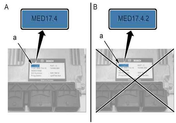

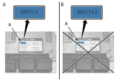

Ok, so I need you to identify which version of the Bosch MED engine ECU you have. It will be either a (A) 17.4 or (B) 17.4.2 as shown on the engine ECU label. This makes a difference to the fault codes

17.4

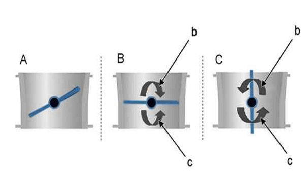

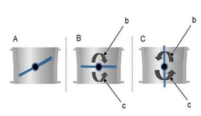

So looking at these fault descriptors should give you some troubleshooting guidance, but the common factor would seem to be the Motorised throttle assembly or the accelerator pedal.
Here is how the throttle assembly operates, depending on the situation:
"A" Position of the butterfly at rest (ignition off) or "limp home" position in the event of a failure.
"B" Position of the gas butterfly with the ignition on or at idle.
"C" Position of the butterfly at full load.
"b" Force of the butterfly motor.
"c" Force of the spring.
With the ignition off, the "limp home" spring holds the butterfly open (Position "A" ).
When the ignition is switched on, the engine management ECU controls the butterfly to the idle position, countering the force of the "limp home" spring (Position "B" ).
When the engine is idling the throttle butterfly moves to supply the airflow required by the engine (Replaces the idle regulation stepper motor ).
From 1500 rpm the engine management ECU controls the throttle in the opposite direction to assist the "limp home" spring (Position "C" ).
The position of the throttle is monitored by the engine management ECU (potentiometer incorporated in the butterfly unit).
The engine management ECU cuts off the supply to the butterfly housing if certain faults are present.
Note: Do not attempt to adjust or dismantle a butterfly unit (safety).
