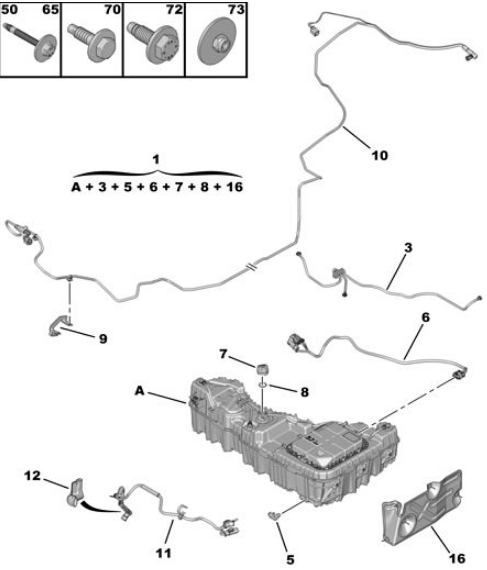

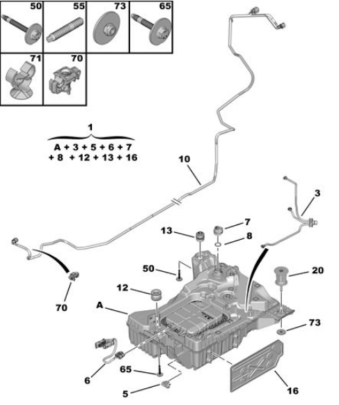

Re: P20E8 code cost if its AdBlue Tank failure
There are 2 possible types of UREA tanks that could be fitted, so you need to know which one you have fitted. The cost of these is the same, but they are totally different shapes.
They each cost the same (£1,056.11) including VAT but excludes labour and diagnostics to code / prime.
The countdown is accurate as it is a digital countdown, so as it stands, you will not be able to restart the vehicle when it reaches zero.
Your fault code relates to low pressure in the adblue system, possibly as a result of the hole in the exhaust. However, it's possible the Adblue level is too low - when did you last top up the adblue tank?
I suggest you follow the guidelines in your owner manual closely for topping up the system, but once the warning is on, it is essential to add at least 3.8 litres of AdBlue to the tank. Then wait at least 5 minutes before switching on the ignition!
After this time, check to see if the warning goes back to the standard 'starting prevented in 1500 miles'. If not, I would not be risking taking the vehicle on holiday to be honest - especially if you still have power loss as a result of the engine ECU going into limp / backup mode.
The DPF issues will be separate, but that can also trigger limp mode if the filter is blocked.

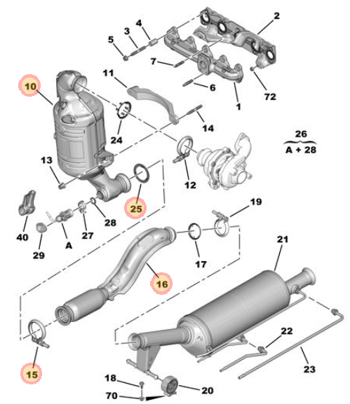

- Is there an Exploded Diagram for the Catalytic Converter or part number i posted above, I am try to understand if its hard to remove & if i can weld around the Neck with Mig Welder. As there are smaller holes on top too
- Size or part number for the Clamp.
Ok, so here is the diagram with the parts that I have indicated:
(10) Catalytic Converter, part: 9823467180, £1094.90
(15) Exhaust System Fixing Clamp, part: 171366, £11.36
(16) Exhaust Front Pipe
OEM Original, part: 9810706580, £348.11
Cheaper Citroen Alternative, part: 1688263180, £136.75
(25) Exhaust Bracket Seal, part: 9827452680, £3.05
All VAT Inclusive direct from Citroen.
