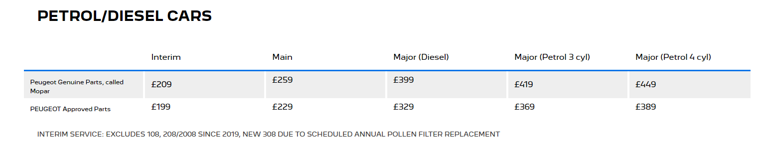

These are Peugeot's fixed price servicing - as a guide, but beware the note that this excludes the 2008.....
Click / Tp Image to Zoom May be worth a call to get a quote.
Your choice of course where you get it done, but just ensure it's done within the annual limit.
