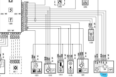

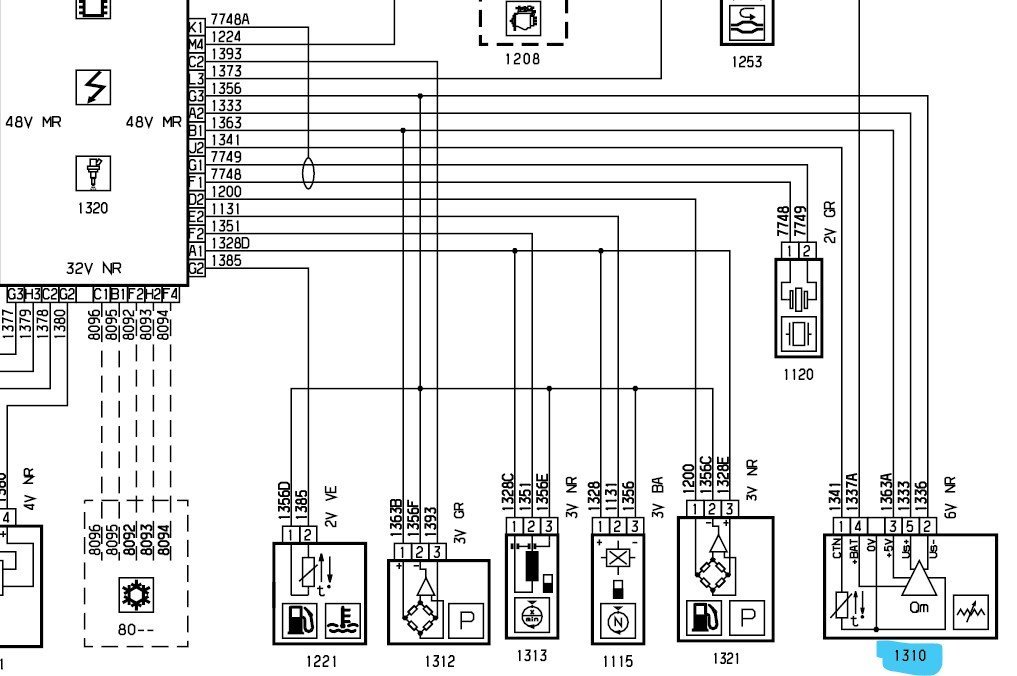

Mom's Citroen goes into limp mode at higher revs and (sometimes) beeps 3 times while going into limp, after inspecting under the bonnet I've found out that the maf sensor plug was damaged so I've rewired new plug using this schematic and changed the maf for a new one.

no reading, checked all the connections to the ECU and one from pin 4 to the 16way connector in the engine bay fuse box and all of them seem to have a continuity
