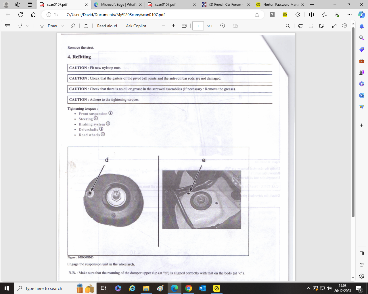

Is there a correct fitting / replacement guide or proceedures for the suspension top mounts on the DS3? want to make sure they go the correct directions

Hi, I would think there is in service box but I had strip my front struts on a 2016 C3 1.4 HDI this year which may be the same. I used the attached page to line them up but found it would have been easier to mark then before removal.
[attachment=0]Screenshot (297).png[/attachment]
