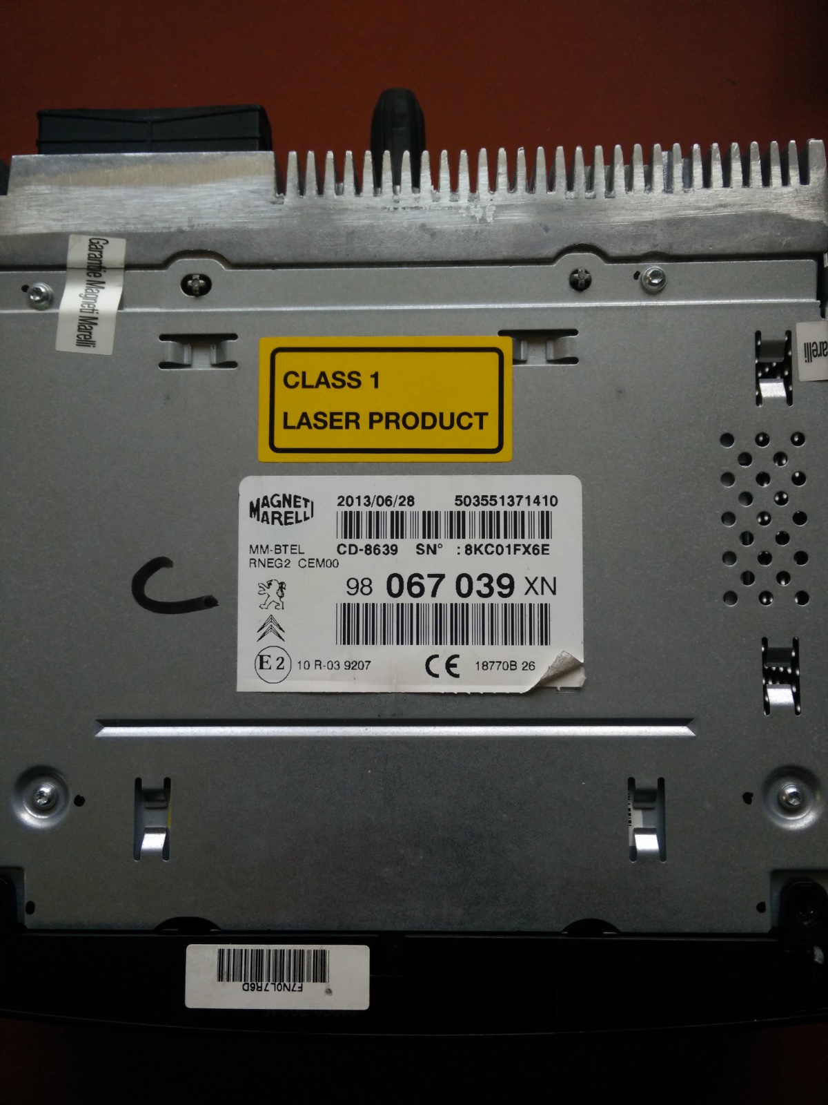

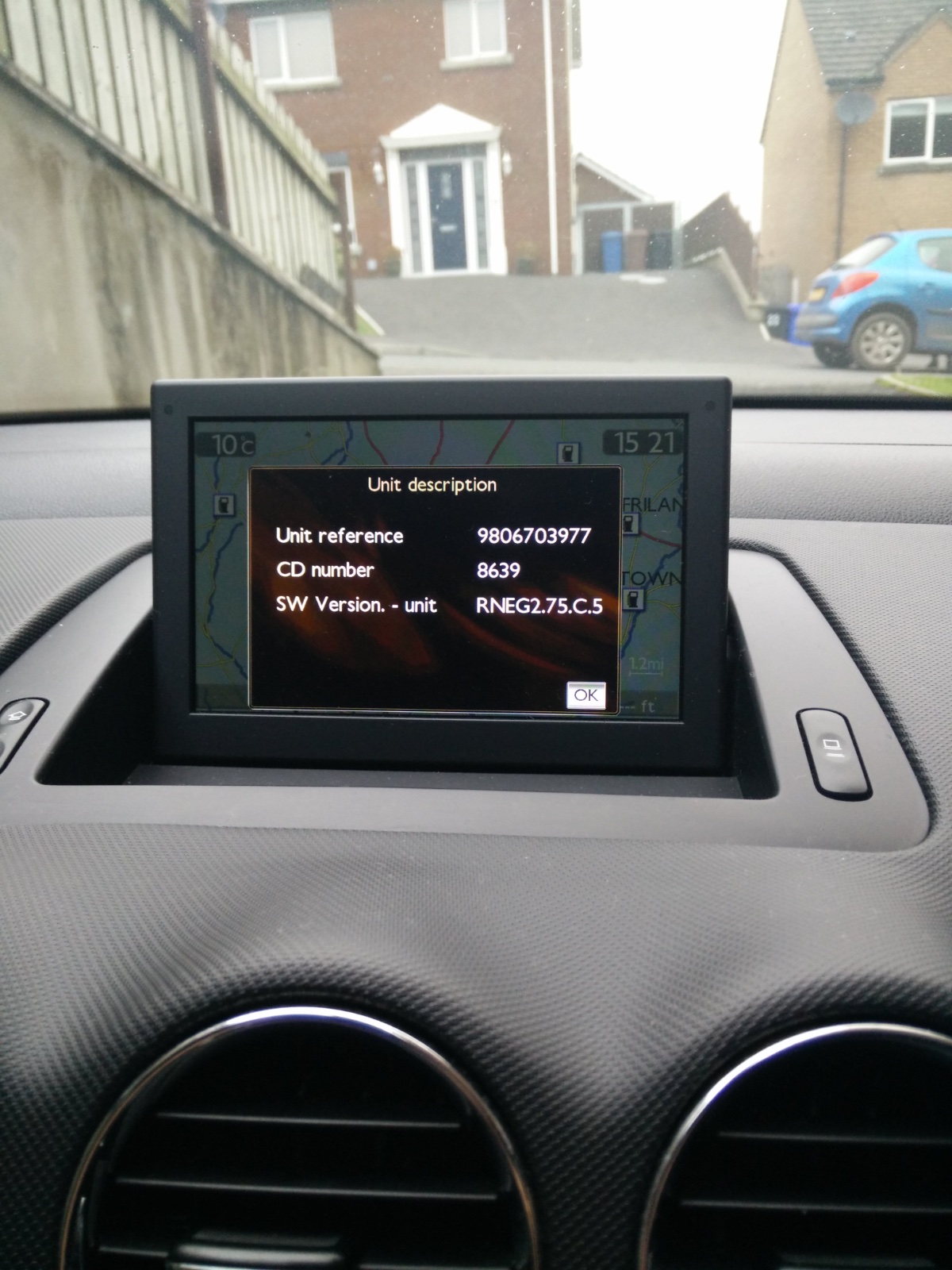

Hi all,
I have this unit and I messed it up. Initially it was working except it was showing o satellites and obviously sat nav did not work. I tried a new aerial but to no avail. Then got a new map update from but after following all instructions my unit just shows blue sky and and still O satellites. Here is the model
