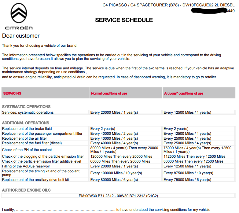

Hi
Could I please request the same information (service intervals and "what") for our 2.0HDi? VIN is VF7**************[VIN obfuscated, can be read by forum staff]. I've decide to service it from now on as its easy enough to change the oil without being charged £200. I've ordered the correct oil filter and have ordered some 0w30 to the correct PSA spec. Just keen to see what else should be done and when? Currently on 75k
TIA!
Paul
TIA!
Paul
- x 6945
Re: Citroen C4 Grand Picasso Service Schedule
Here you go, I've blanked out first part of the VIN. Servicing is annual or 20k miles, whichever is sooner.
Click Image to Zoom
Click Image to Zoom
Amazing, very many thanks!GiveMeABreak wrote: 24 Jun 2024, 16:00 Here you go, I've blanked out first part of the VIN. Servicing is annual or 20k miles, whichever is sooner.
