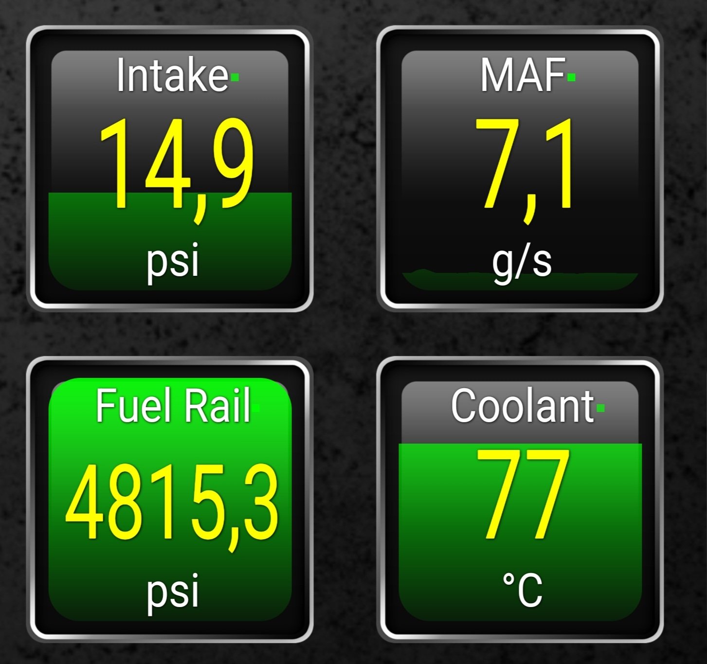

Still on the chase for the culprit of the strange behavior (roughness at lower RPM's) and with Torque , i've been looking at MAF readings. At Idle , they are around 6 - 7 g/s most of the time , but after the car Idle for a while i've seen them going up to 9 - 10 g/s. Could that be a normal reading?

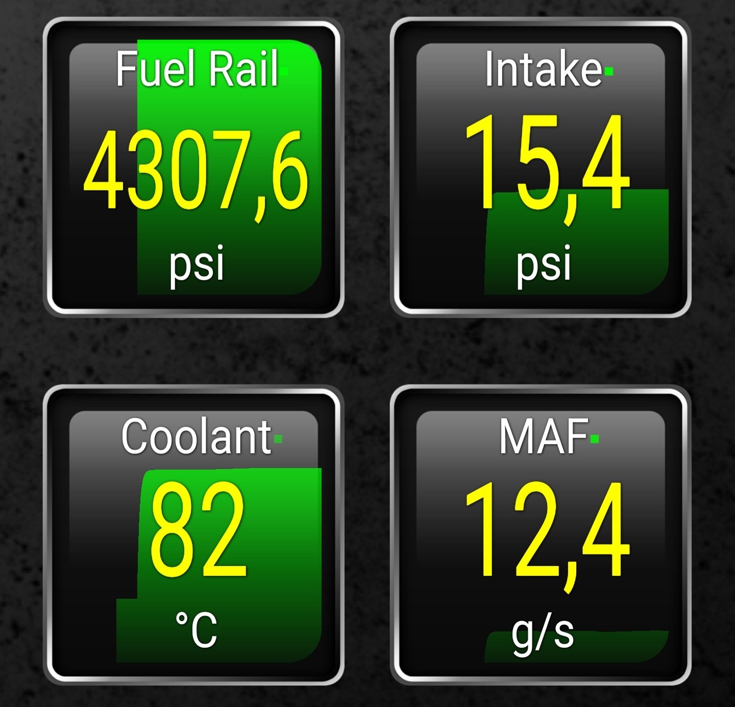

On the company car (Same engine, but distinct MAF - Unsure why) the readings at idle are quite a bit higher , normally around 12 g/s. I wonder witch one is ok?

Your maf for the first car looks ok assuming it's at idle the second one is high for idle. Typical maf readings on any car is between 2 and 7 at idle higher than that indicates an issue but is relative to rpm. The higher the rpm the higher the air flow rate. Your fuel rail pressures look more problematic to me and could be the route of your issues. The second car seems like it has a much lower fuel pressure so it might have a leaking injector or two. You need to get a proper diagnostic session with lexia.

darbuck wrote: 18 Dec 2023, 07:54 Your maf for the first car looks ok assuming it's at idle the second one is high for idle. Typical maf readings on any car is between 2 and 7 at idle higher than that indicates an issue but is relative to rpm. The higher the rpm the higher the air flow rate. Your fuel rail pressures look more problematic to me and could be the route of your issues. The second car seems like it has a much lower fuel pressure so it might have a leaking injector or two. You need to get a proper diagnostic session with lexia.
Thanks for pointing the Fuel rail pressure. Didn't spot that one. There's a a lot we can read in numbers when we know where they should be , and that's not my case yet :D
That's a print-screen , so the numbers were "at that moment". There's a bit of oscillation on both cars. First one's MAF once in a while goes up quite a bit, sometimes up to 10 (Rare, but happens) , so what i mentioned are the average values at idle. The fuel rail on the second one also goes a bit higher sometimes.

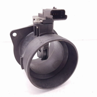

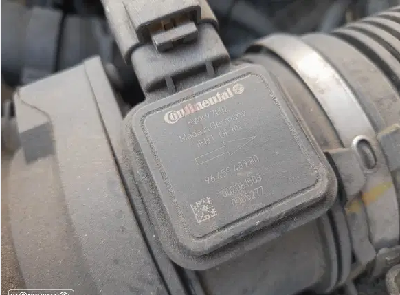

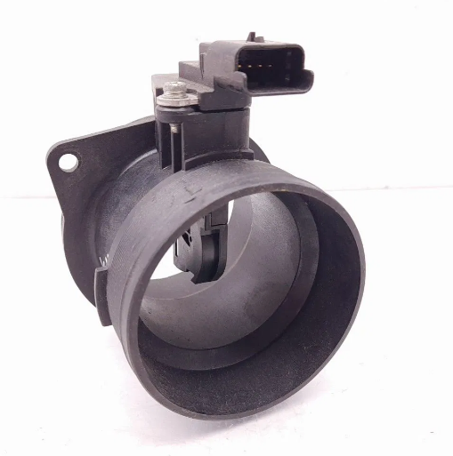

As a curiosity, one car is from 2011 and other from 2010 , both with the 2.0 Hdi 163 engine , but MAFs are different in brand and design. Could that be a replacement or can be like that from factory?
2010 has one like this:
2011 has one like this:

Our 2007 C5 now has a Continental make MAF. With the engine not running and the dash lit up it gives a reading of about 4, I thought it was faulty and bought a new one and that is the same so if you find this just ignore it. Searches found other cars were similar so not just on our car. Our 308 shows 0 with the dash lit up . The original C5 one was a Siemens and the new one Continental who seem to have taken over the business. On idle it starts up about 11 dropping to about 7 once warmed up.

Just to clarify Continental is now VDO formerly Siemens. these cars are very fussy. even a few milliamps can make a difference to how the ECU interprets the signal received from the instrument. in my experience it's best to stick with original parts when you buy sensors especially mafs, they can cause all kinds of running issues. Siemens are the most reliable sensors you can buy so if they are available and affordable I would be buying them. Just to be clear I am not and have never had any affiliation to Siemens I'm just speaking from my experience I presume they are the same quality. As you say stick it on a Lexia, I too wish I could get a blue tooth lexia.
