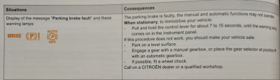

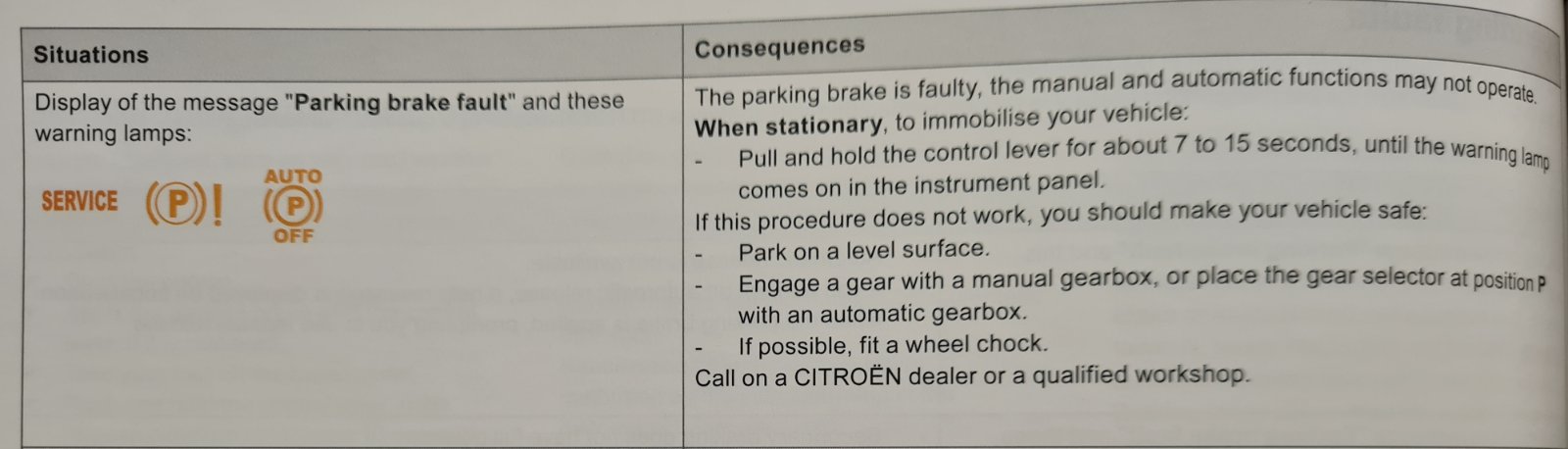

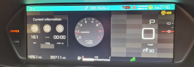

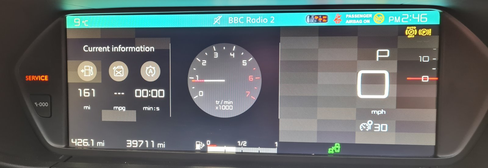

When I drive my car, a dashboard panel shows 3 warning lights as shown below and the car does not move at all even though the parking brake is released
According to the Handbook, it seems that the issue is serious.

It's likely that one (or more) of the wires to one (or both!) of the handbrake motors has rubbed / rotted through on the inside of the ducting. As these are electric if it has failed in the 'on' position, then the only way to get it off (unless you fix the wire!) will be to remove the motor from the back of the caliper, and then wind the caliper back manually.
