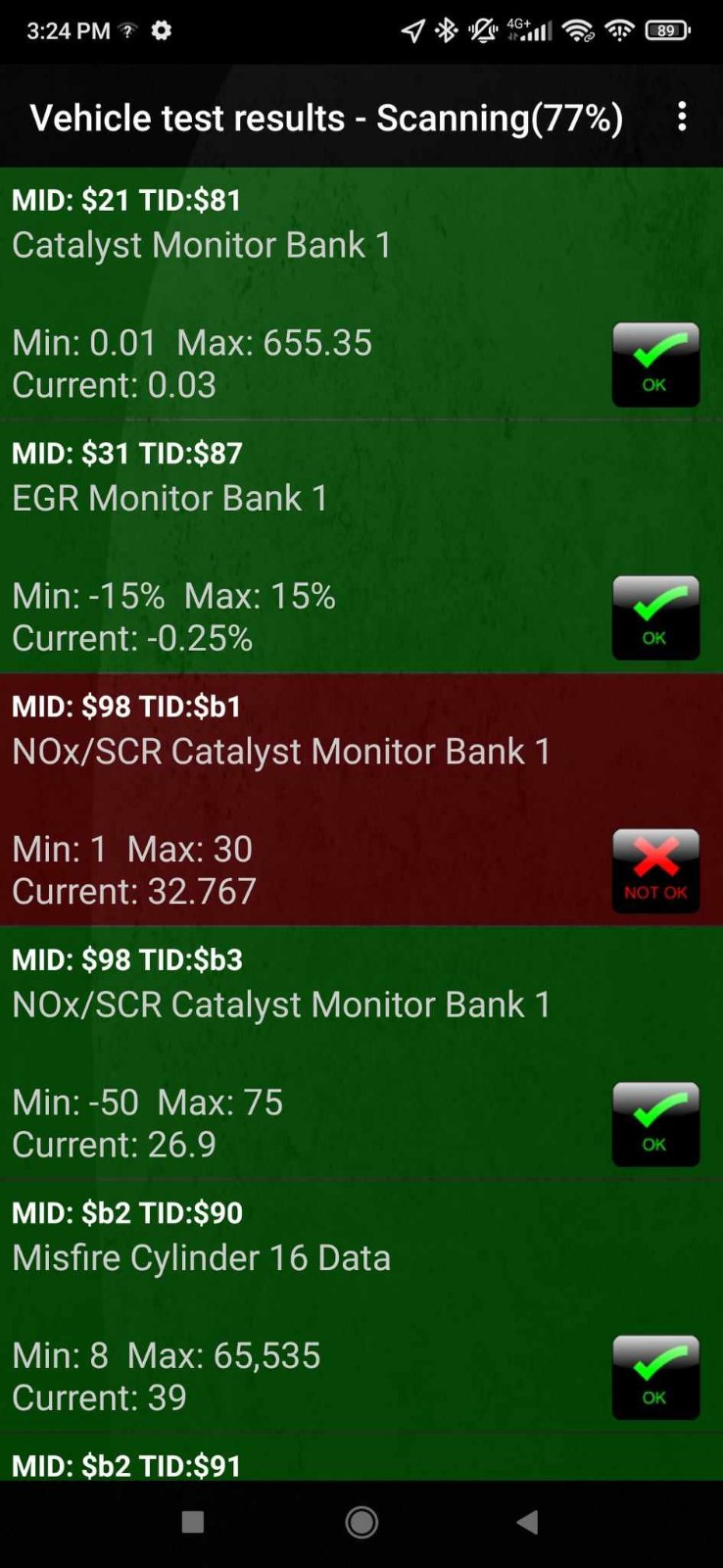

So had the car in the garage, connected to the obd reader and said it could be a sensor, new ad blue tank or possibly a nox sensor. On one of the other readers it said blockage detected and leakage detected but didn't know if this was because the ad blue had ran out. All codes reset, added a forte treatment for the ad blue and running it now. Not had any error messages come up but done another scan with my obd reader through the torque app and its showing the same fault as before. The ad blue cap looks like a vented one. The car was registered end of November 2005 so just over 8 years old.
What would be the best course of action now?
Just keep running it? Contact Citroen head office and see what they can do?
Most recent log below.
Thanks again.
Mode $06 report generated by Torque for Android
Vehicle VIN: Not present
Vehicle Manufacturer: Unknown
Vehicle Calibration ID: 9807589399
Test report:
MID:$21 TID:$81
- Catalyst Monitor Bank 1
Max: 655.34998 Min: 0.01
Test result value: 0.02
PASS
MID:$31 TID:$87
- EGR Monitor Bank 1
Max: 15% Min: -15%
Test result value: -0.35%
PASS
MID:$98 TID:$b1
- NOx/SCR Catalyst Monitor Bank 1
Max: 30 Min: 1
Test result value: 32.767
FAIL
MID:$98 TID:$b3
Max: 75 Min: -50
Test result value: 16.5
PASS
MID:$b2 TID:$90
- Misfire Cylinder 16 Data
Max: 65,535 Min: 10
Test result value: 74
PASS
MID:$b2 TID:$91
Max: 1,000 Min: 0
Test result value: 12
PASS
MID:$e3 TID:$86
- Vehicle manufacturer defined
Max: 5.04% Min: 3.36%
Test result value: 3.93%
PASS
End of report.
