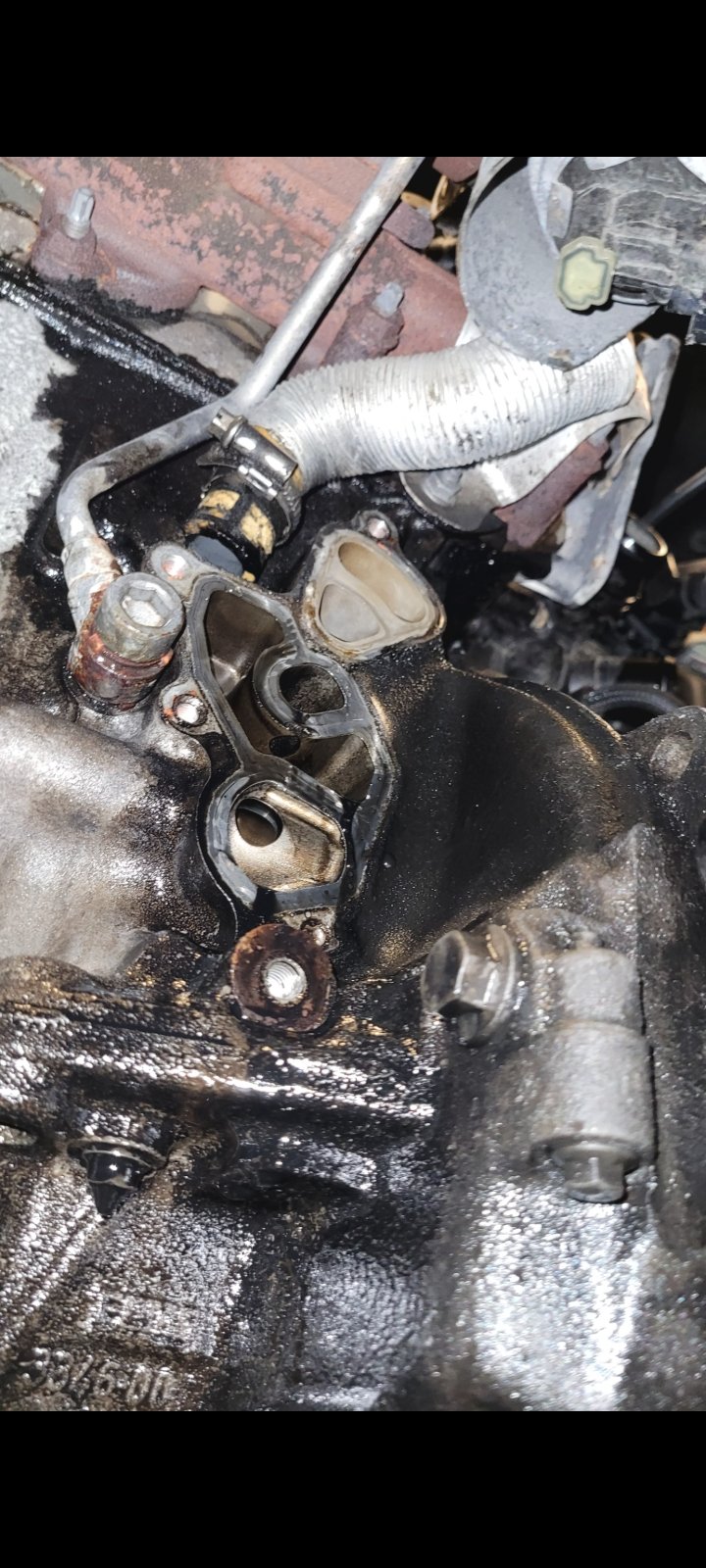

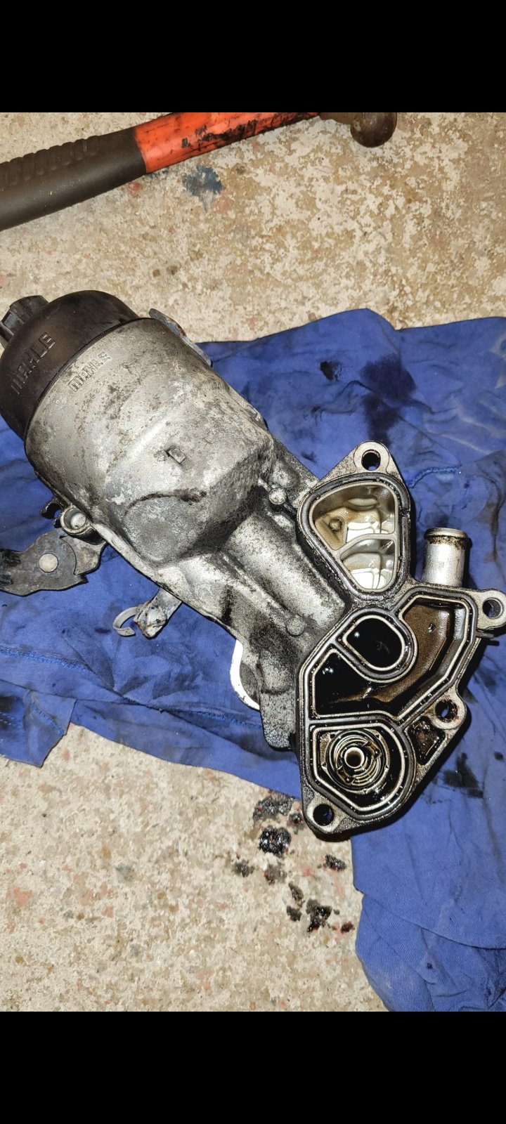

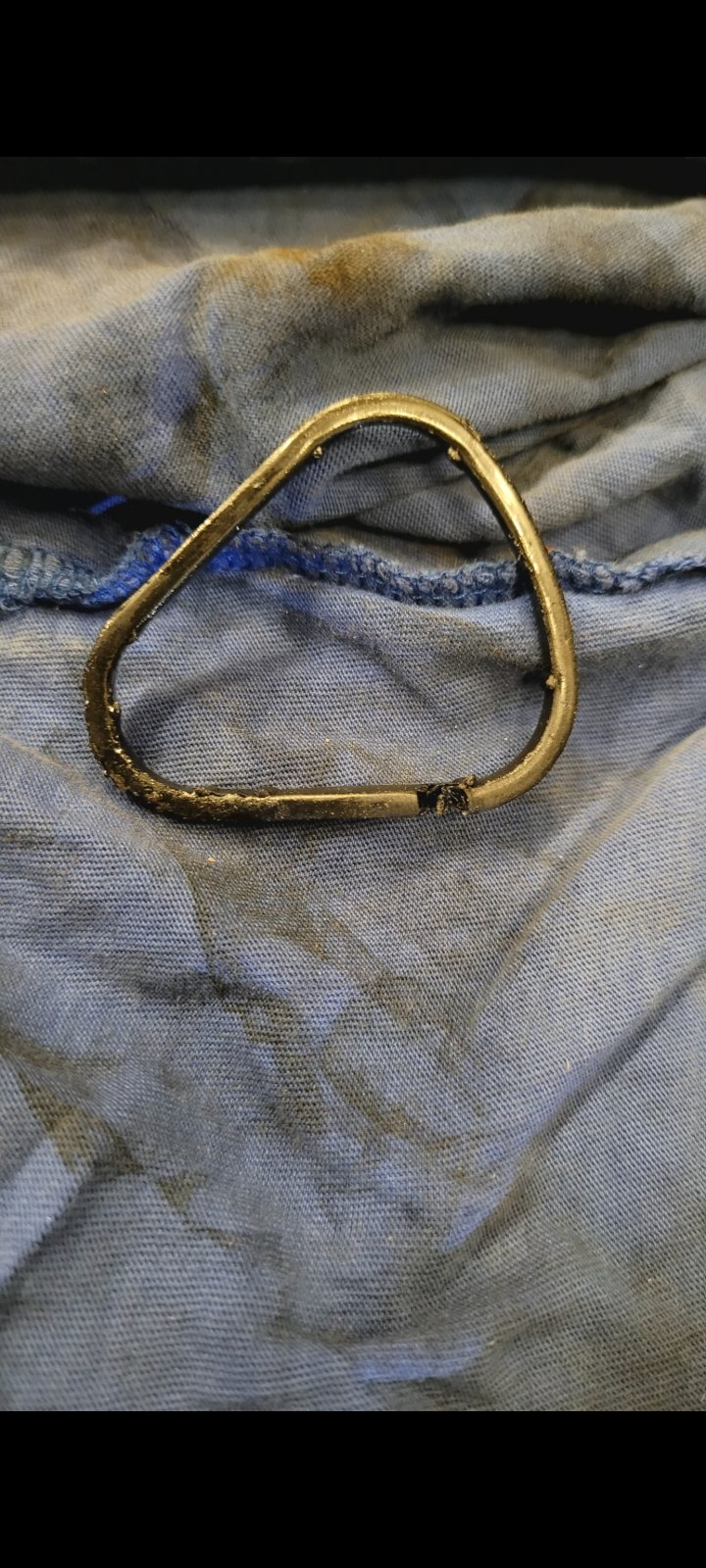

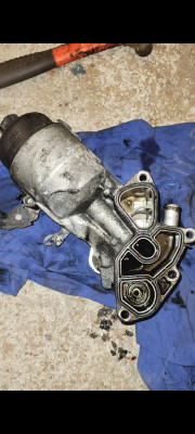

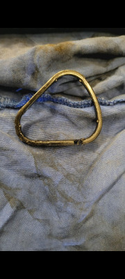

Bloody water seal on the oil cooler, no way of seeing it till exhaust was off.
