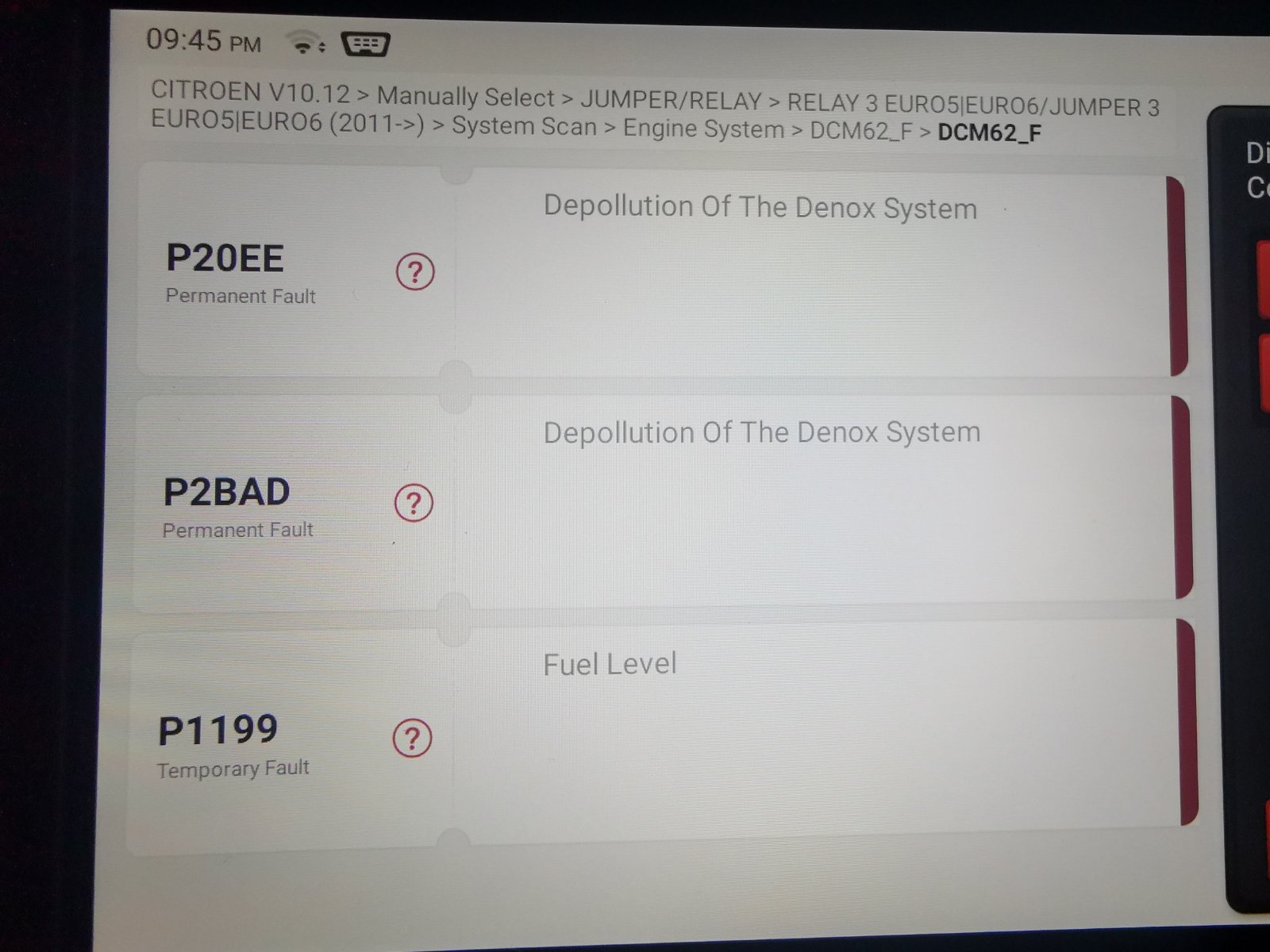

I used a fault code scanner to find that my codes are: P20EE and P2BAD. Is it possible to read into these fault codes to find the specific problem?
With the scanner, a KINGBOLEN K7, I am able to clear these fault codes, which has removed the amber engine warning light from showing up on the dash, for now... Hopefully this has bought me some time to drive back to Portugal where I can have the van looked at by a Citroen garage, potentially under warranty.
