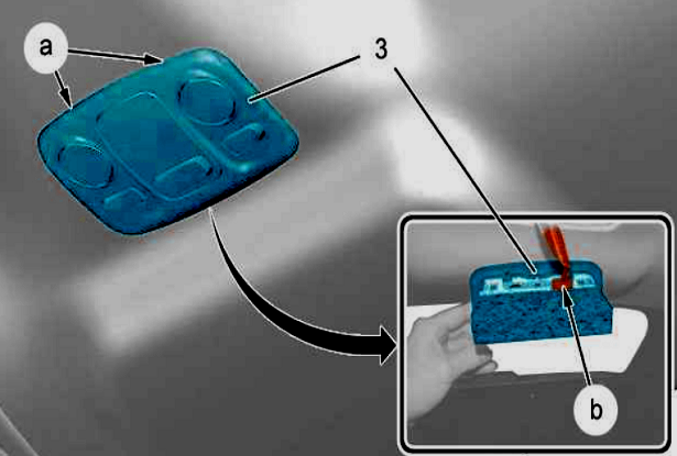

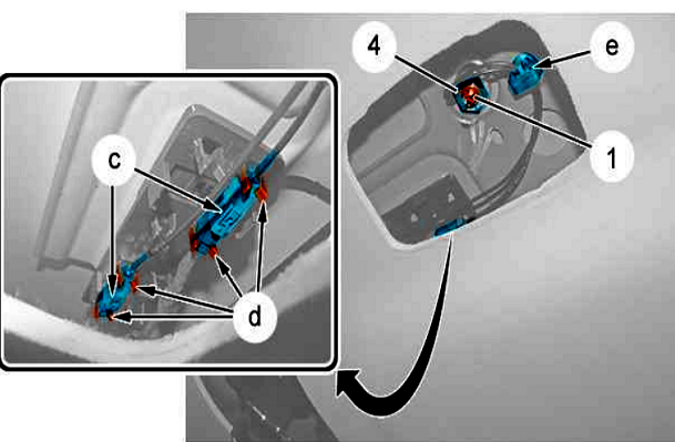

You need to completely remove the rear light cluster from the headlining to reveal the nut.
Detach the lamp (3) (at "a") using trim removal tools.
Detach the lamp (3).
Disconnect the connector (at "b").
Remove the light (3).
So use a trim tool where is shows at 'a' to push in the clips and gently lower I suspect.

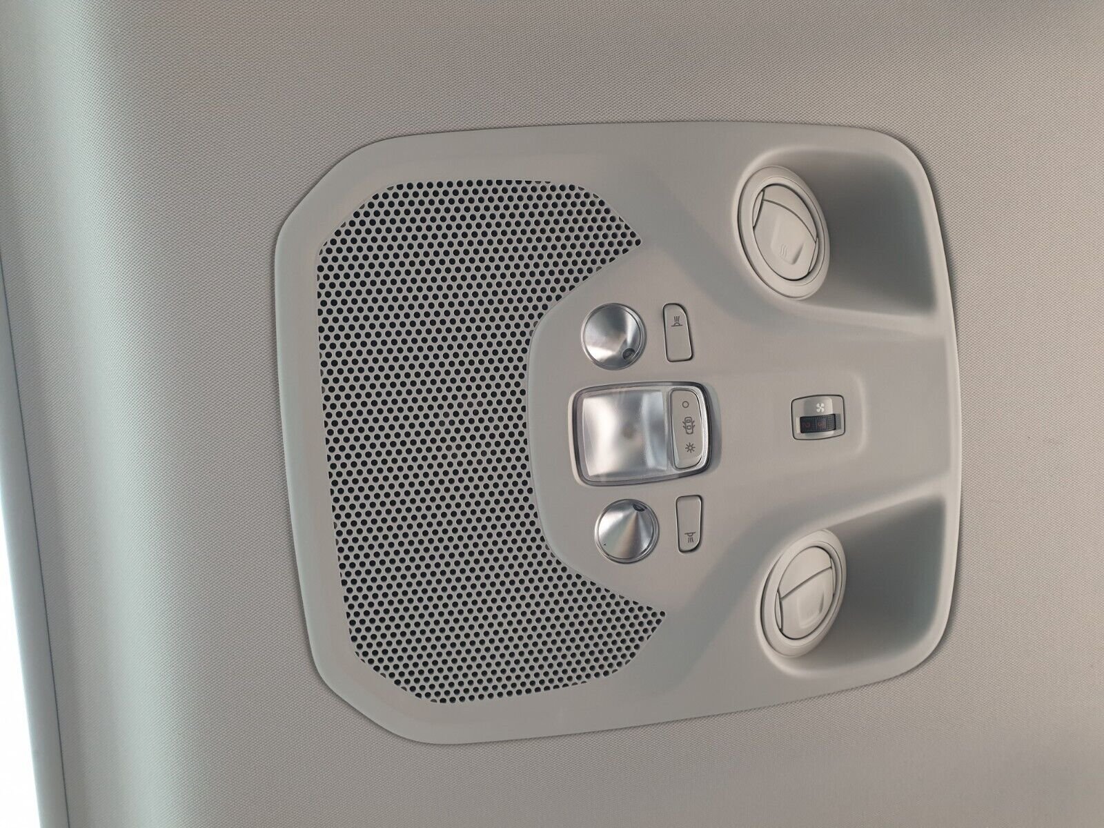

Unfortunately my panel differs see attached photo
- x 6955

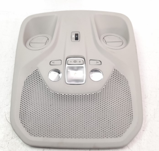

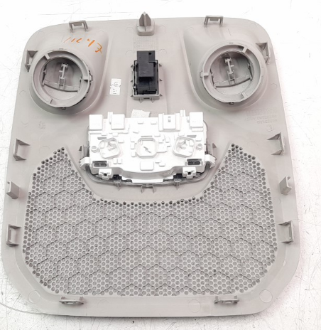

Ok, so parts are showing a different type of light module as these have changed multiple times, but this is the one below and I've also provided an opposite side review so you can see where the trim clips are to be released which should help you:
So I think it's a case of gently sliding in a flat trim tool at each of the plastic tabs and gently releasing them all the way round then pull down where the stud is at the top and where the guide pins are 90° & 270°. Just be careful of the thin connecting wires behind!
