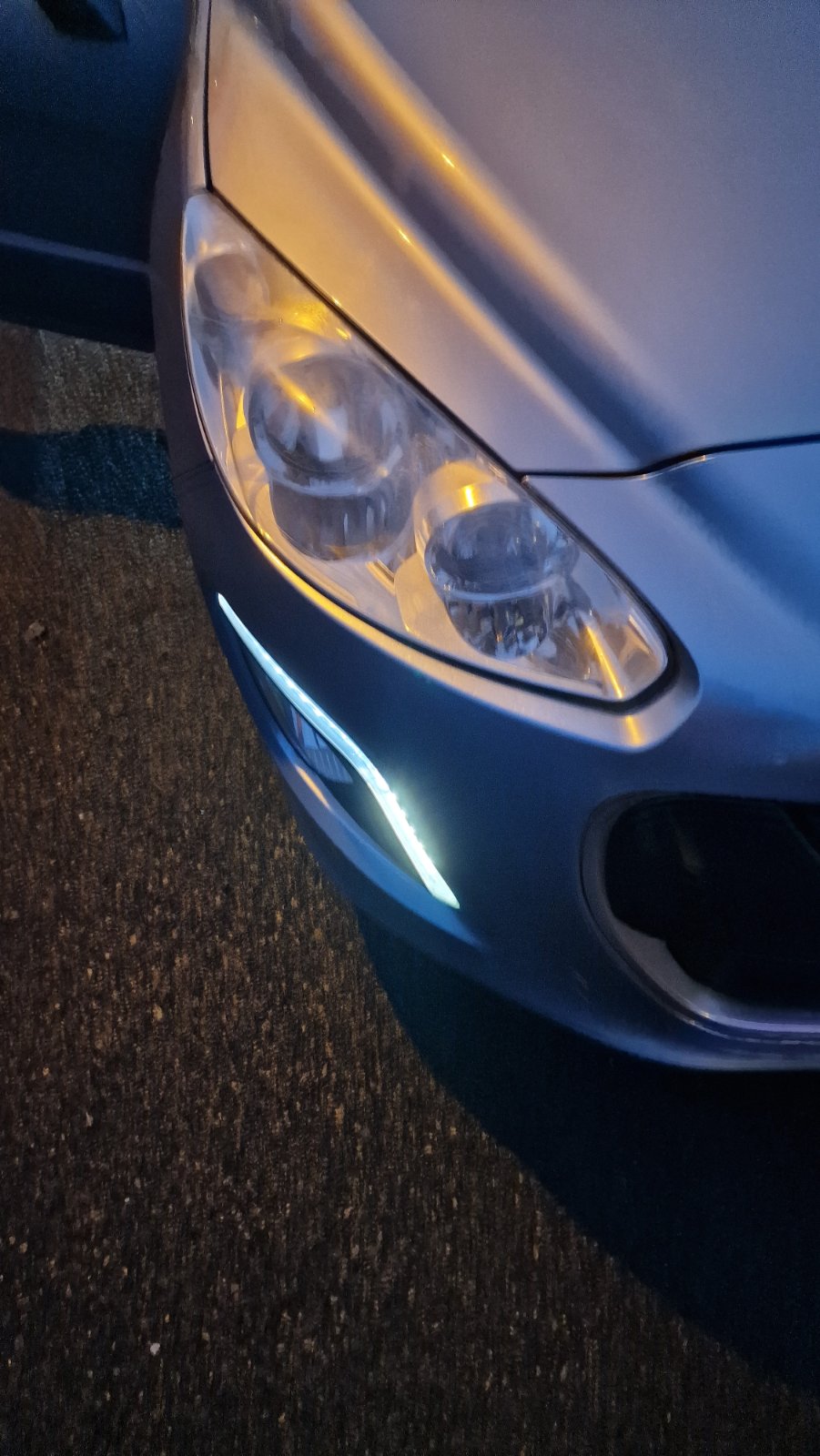

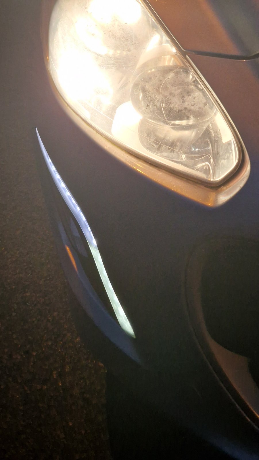

I have a peugeot 308sw 2012.
I've literally just had it pointed out to me today that the side lights aren't on despite being selected on the stalk but doesn't seem to do anything. All other lights are fully functional.
The bulbs are fine and the daylight led strip doesn't seem to get brighter to compensate. Which is what i had thought.
Inside the rubber access cap everything has wiring going to and from the locations.
Any thoughts?

The mk 1.5 C4 Picasso added DRLs, but they left the sidelight bulbs (unconnected) in the headlights to confuse everyone. These may well be the same.

I think Richard is right, the bulbs are there but don't operate, i saw a similar issue on a citroen a few years back, i don't recall the model but i seem to recall you can go into the cars on board menu/VDU and play around with the settings & the DRL settings are in there somewhere.

Some DRLs were fitted but not activated in the UK before it became a requirement in February 2011. BUT this only applied to NEW vehicle models manufactured after this date, so as yours was an existing model it wasn't a requirement.
On some vehicles where there actually is an in-car menu to toggle the option on and off, like the C5 X7 for example, the DRL option will not show up until the system has been configured in the BSI first using Lexia / Diagbox. Where applicable and once that is done, then the menu option will appear on the in-car menu / LCD. Some vehicles will not have an in-car option for DRL configuration though, as once configured at BSI level, they will just operate according to the option set for the specific country requirements,
