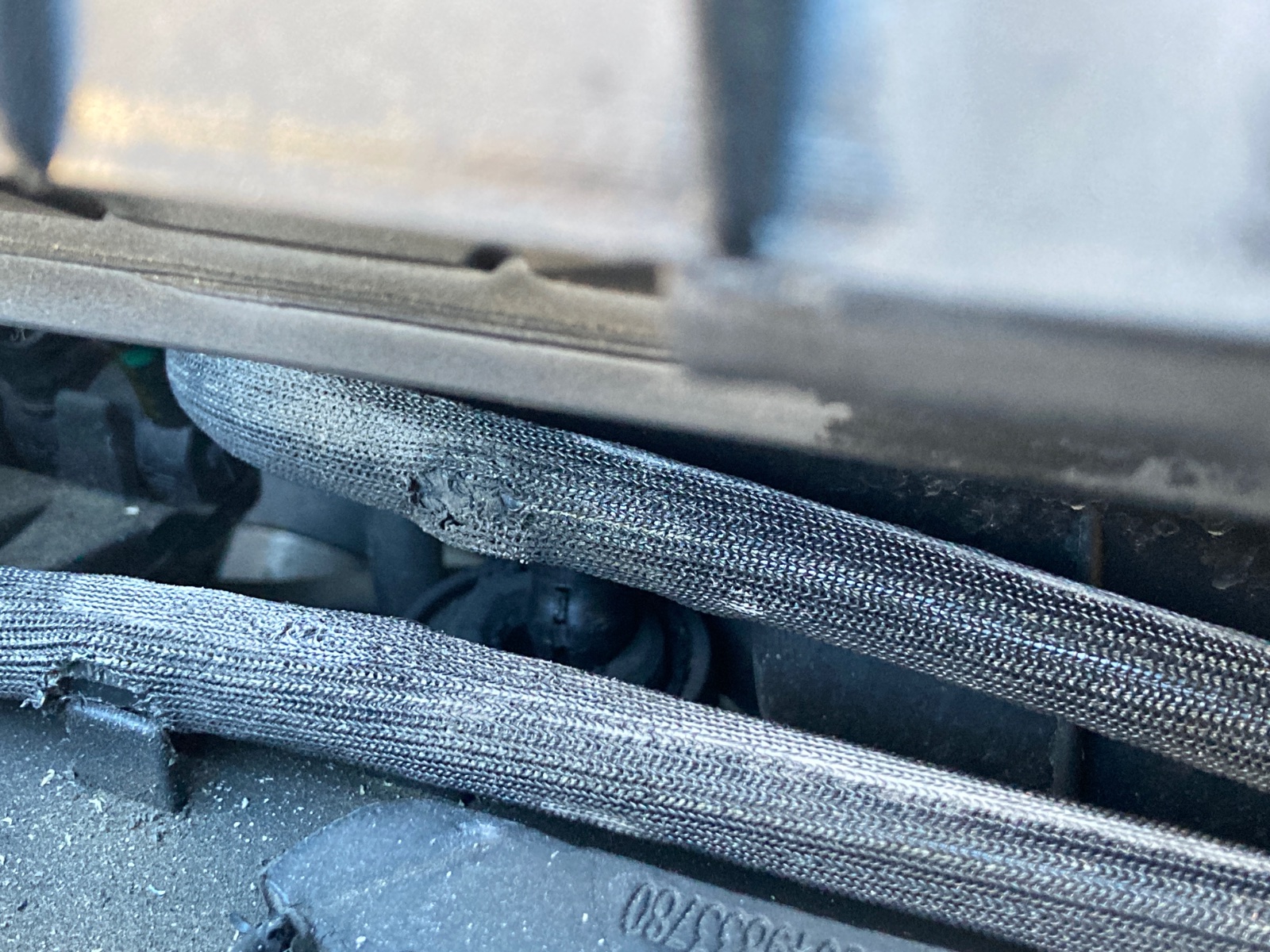

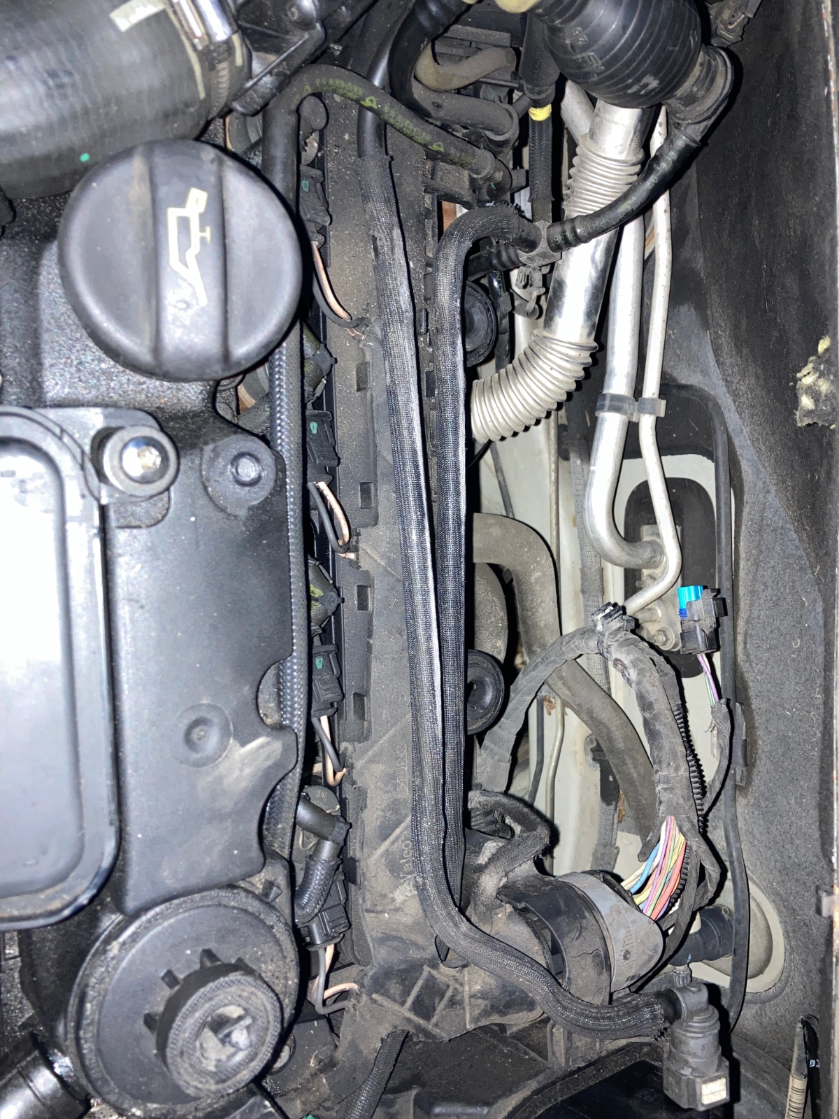

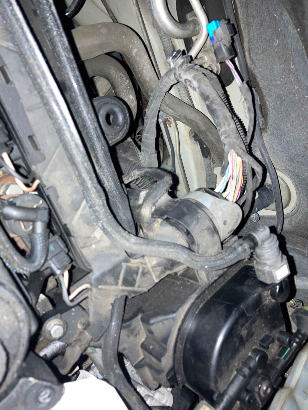

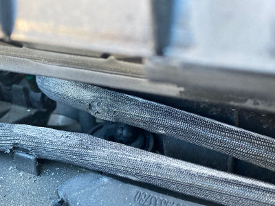

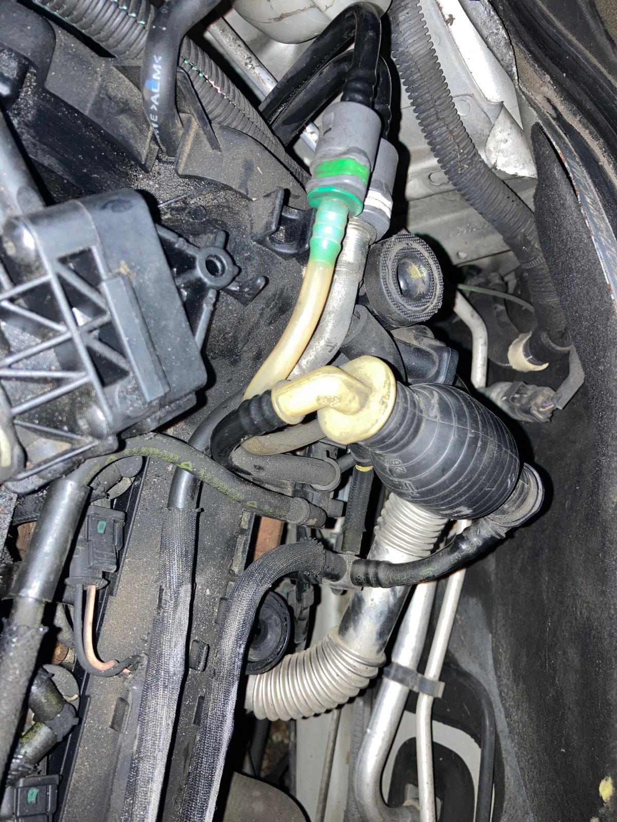

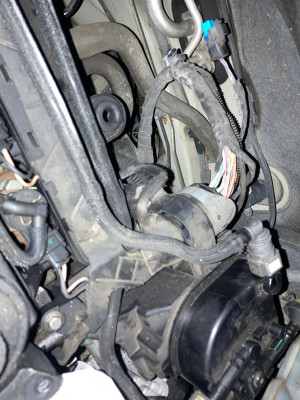

I borrowed a diagnosis unit from my mate and it showed up the P1351 fault which is pointing to the glow plug module / relay or glow plugs. However, I think this could be a red herring as I understand that due to the normal ambient temperature, starting wouldn’t be reliant on the glow plugs and I believe the issue lies with air in the system.
I’ve taken out the battery, battery box and air filter box to have a proper look at the fuel pipe harness and there is some evidence of wear and tear so so think I need to find a way to bypass this harness and get some fuel into the system? Have attached some photos for reference.
I will definitely carry out the checks you mentioned once I’ve put the battery back in and can crank the engine.
Thanks.

I doubt those fuel lines are causing any issue, there's no evidence of leakage. P1351 is a very common error but won't stop it starting. Do the visual check on the cambelt first, then get it on the scanner for live data.
