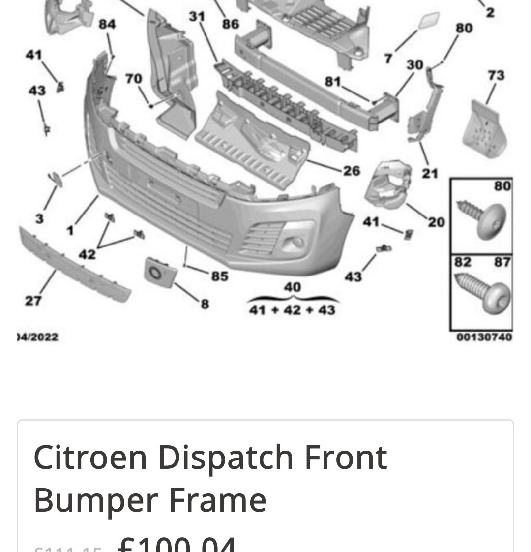

Hi Jock, living where you do, it maybe worth you trying to get hold of a cold weather sheild for the front of your Despatch, or just cover the lower part of the grille with polyethylene /Tin foil like your folks used to do. (item 27 I think). My Citroën handbook recommends fitting these when ambiant temperature is below 10°
the idea, is to keep the cold air away from the bottom of the radiator, helping to keep your engine it's temperature up.

Hi Sloppy.Sloppysod wrote: 07 Dec 2023, 09:39 Hi Jock, living where you do, it maybe worth you trying to get hold of a cold weather sheild for the front of your Despatch, or just cover the lower part of the grille with polyethylene /Tin foil like your folks used to do. (item 27 I think). My Citroën handbook recommends fitting these when ambiant temperature is below 10°
Thanks for that suggestion about fitting a cold weather shield, it rather makes sense as to how the problem arose in the biting morning freezing fog and why the car ran fine when the mechanic gave it test run later in the day when the weather went above freezing.
