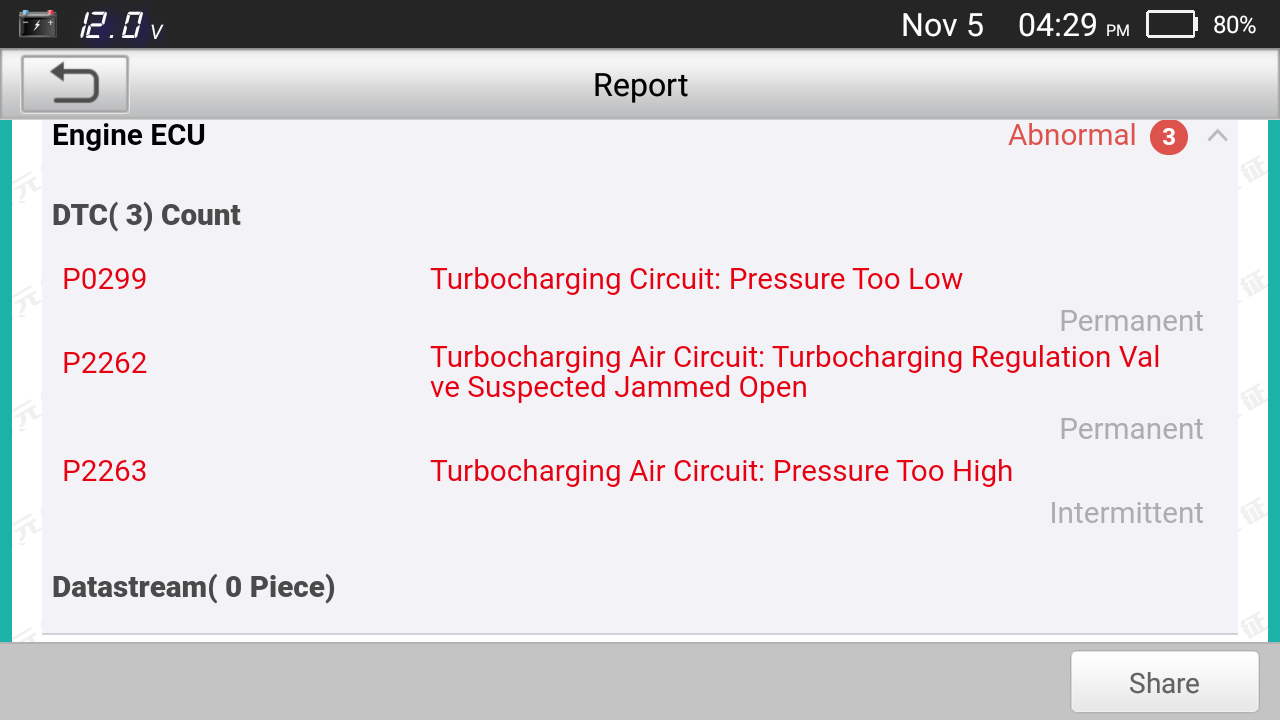

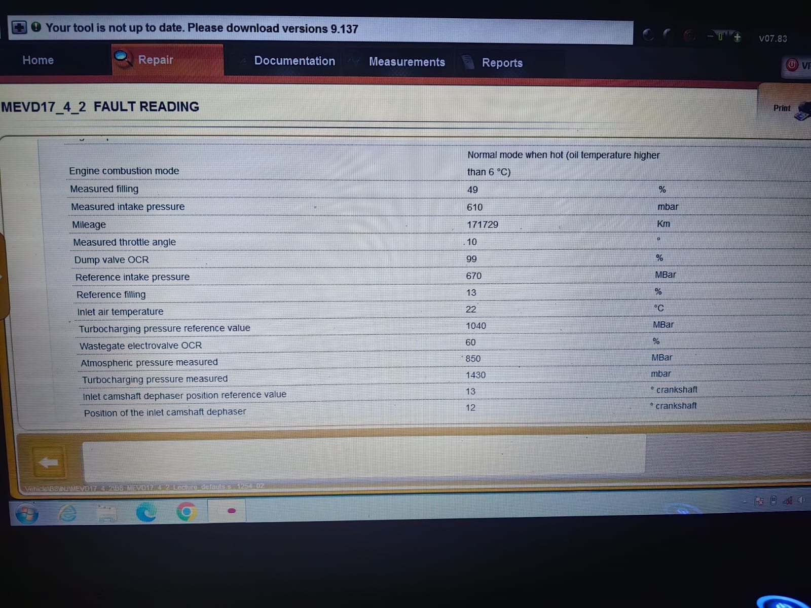

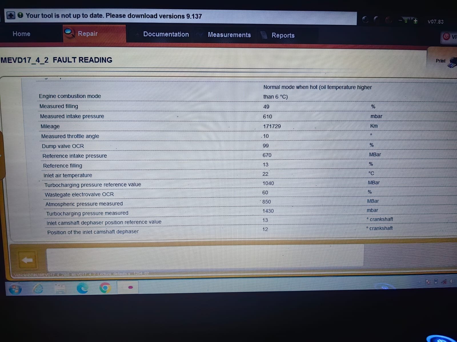

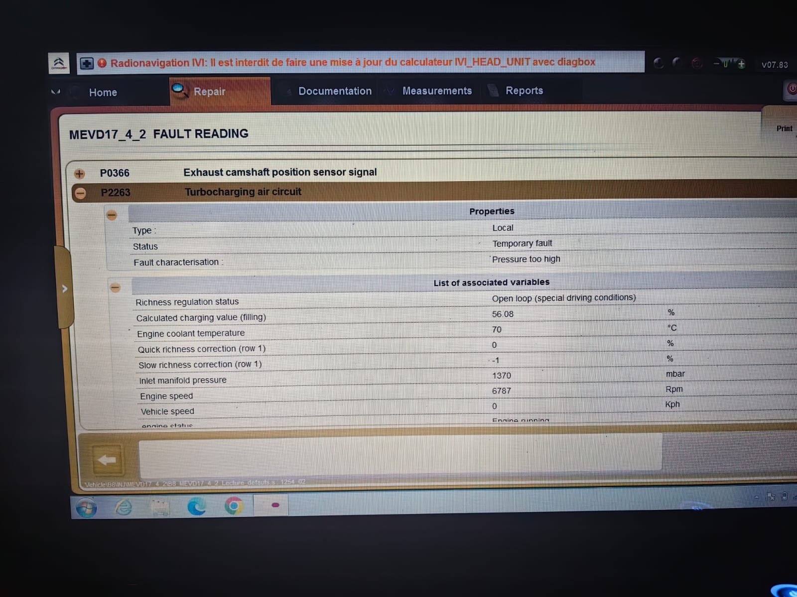

Hi All,
I also have a Boost issue on my DS5 200THP.
P2263 according to Diagabox.
I have changed the solenoid valve underneath the intake, also replaced the solenoid mounted to the turbo and also have a DV valve between the solenoid and turbo to keep things lasting longer.
But still no luck with getting boost, if i exceed more than 3000rpm or need full boost it takes boost away immediately.
I will attach pictures from scan.

That is similar to the symptoms I had when the atmospheric port filter on the boost control solenoid was blocked, but it would only throw the fault code occasionally.MarkusSA wrote: 10 Jan 2024, 09:19 Hi All,

Could an over boost error be caused by a Faulty turbo?
Because if the turbo was faulty, it would not build boost at all.......
Another concern, Reference intake pressure vs measured intake pressure.
The one on my car stays almost close to 800 whilst the other one changes as I REV the motor.

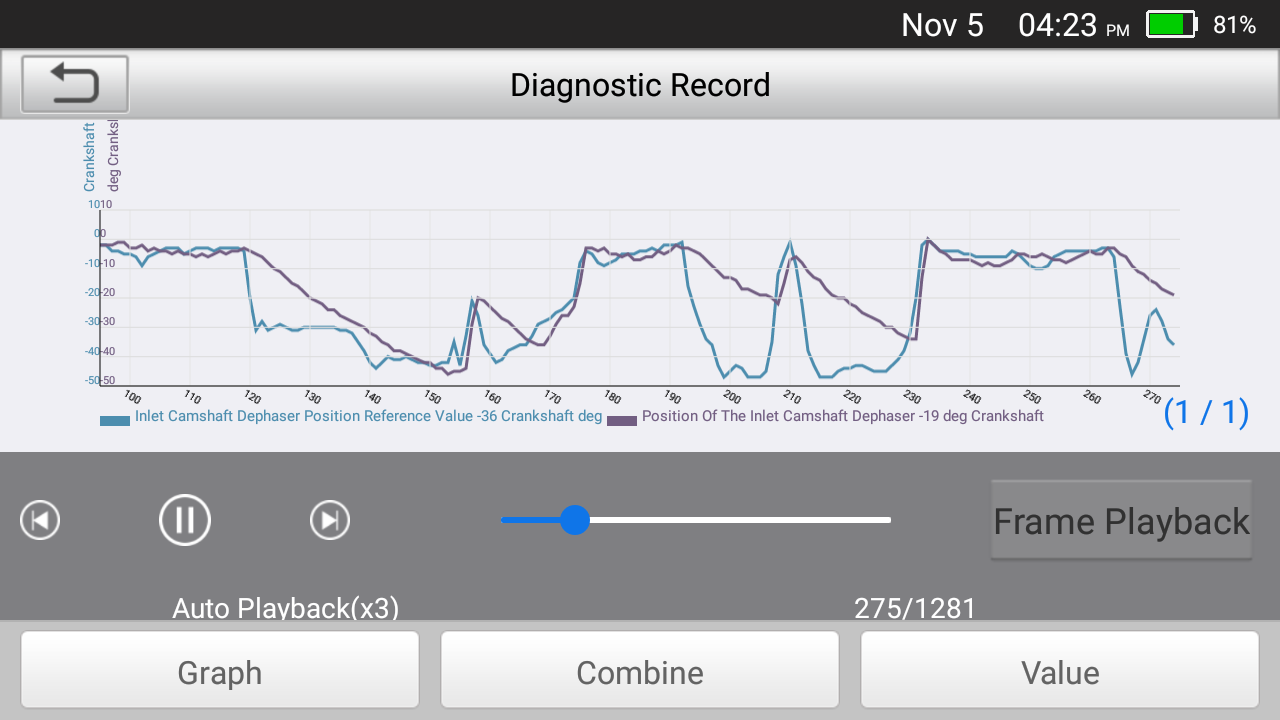

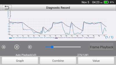

Problems with camshaft timing can often throw up spurious turbo fault codes, as happened recently with my RCZ THP200. But you need a code reader that lets you collect and plot live data (Launch 123e was used ). On a previous scan I had a P0012 timing fault.
This was traced to a 'lazy' camshaft solenoid valve. I have solved these problems in the short term by standing the solenoid valve in a jar of kerosene placed in an ultrasonic bath, and changing the kero until it stayed clean. Merely spraying the outside of the valve is unlikely to be effective.
