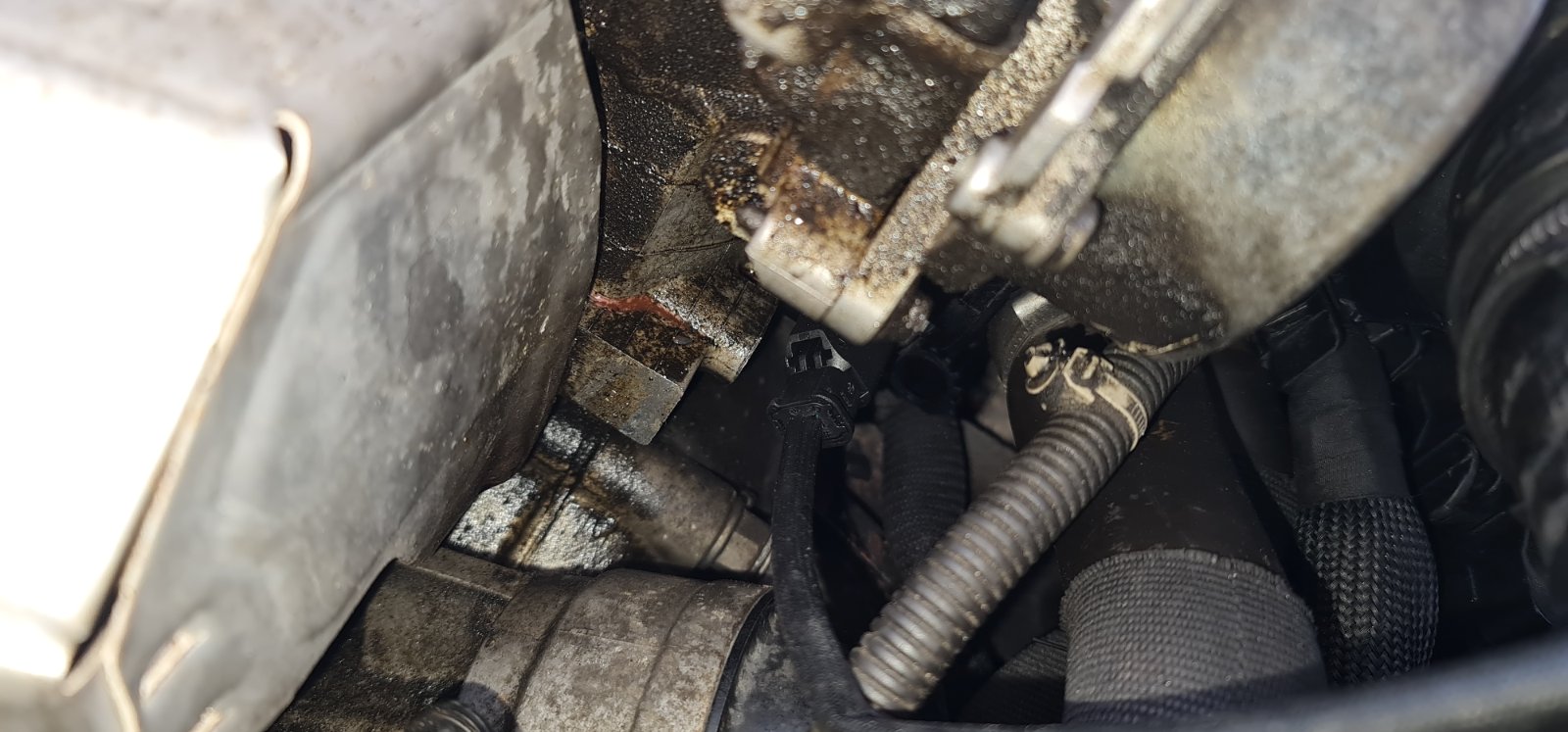

Re: 308 thermostat woes

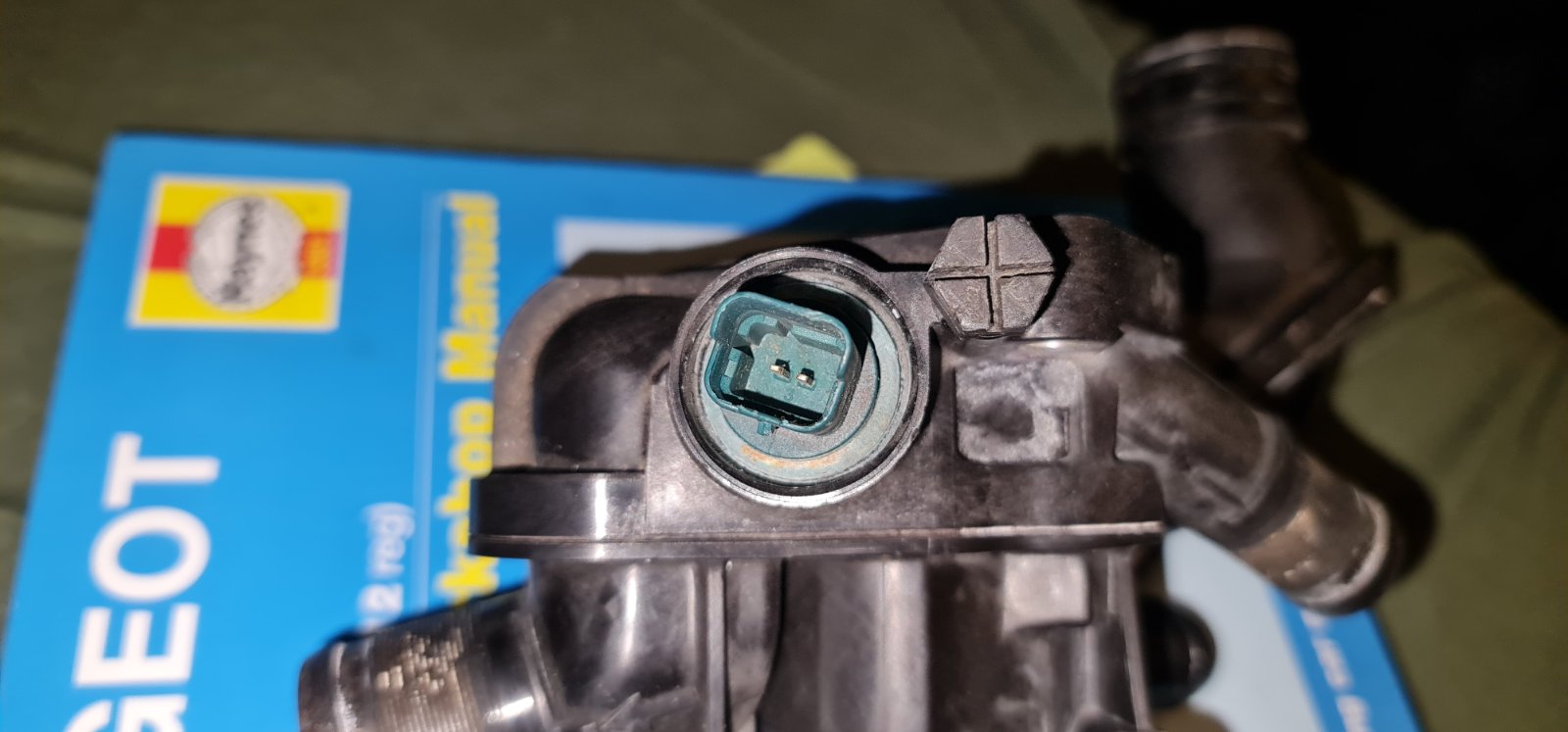

Attached picture is old part, simple two pin connector as is the new one, just the location has changed so the existing wire won't reach.
I'll get a picture of the new one tomorrow in the light and you'll be able to see what's left of the terminal block .

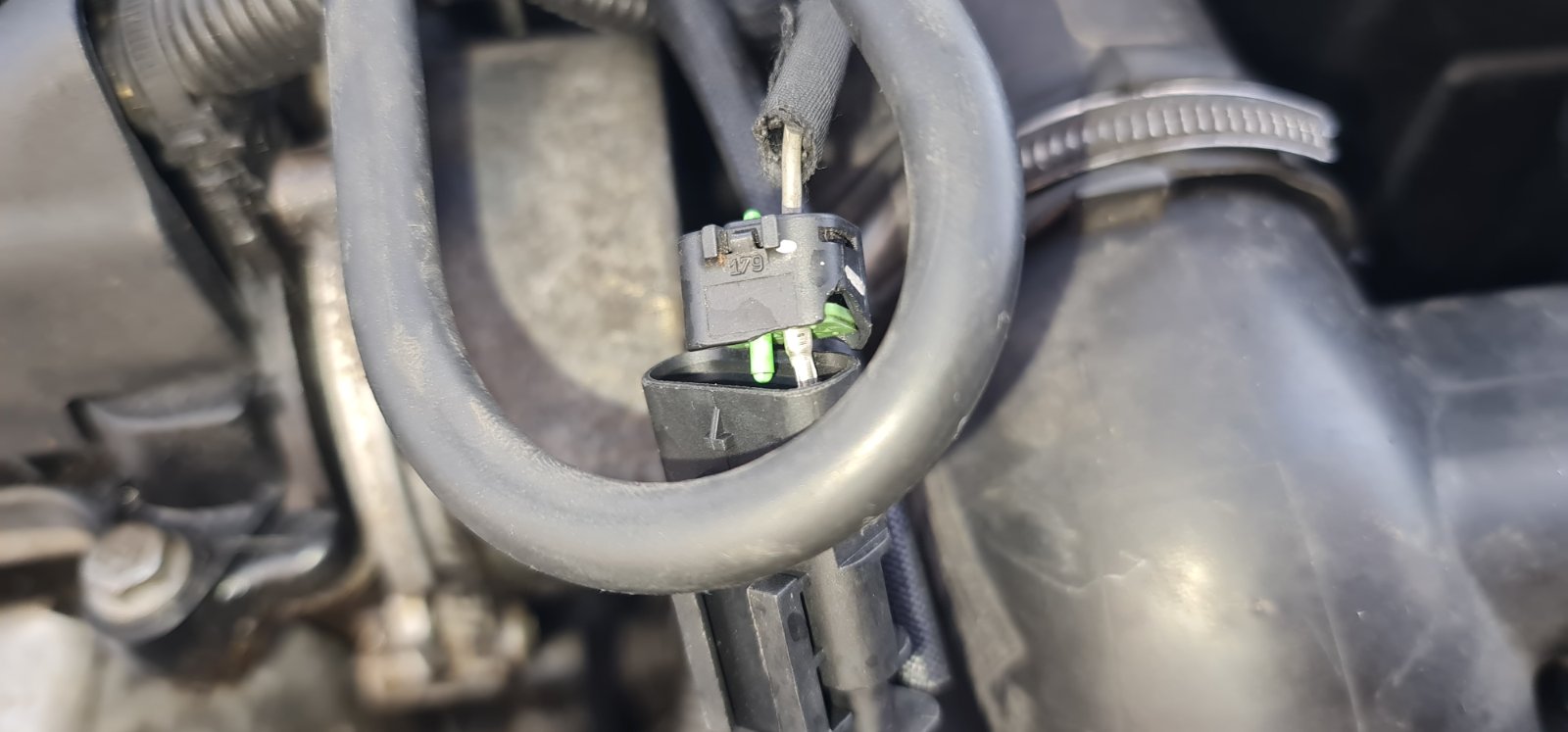

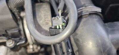

Harness adapter used to extend the wires, old crumbling connector which is currently onto the corresponding pin on the adapter.
If I understand correctly, I now need to earth the other pin ? Any suggestions where a good earth to splice from might be ?

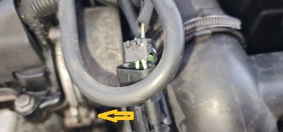

I would fit a ring spade to your earth wire and clamp it under the nut just below and to the left of the connector in your picture as arrowed below. Just make sure it offers 12V between it and the positive battery terminal but it looks like it will to me.
