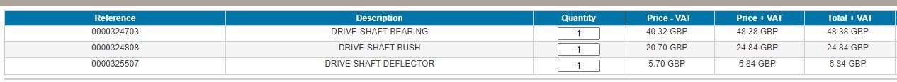

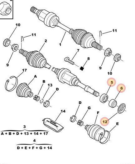

Cit show it as 30x55-13 - I would take that as 30mm id, 55mm OD, 13mm wide. I imagine it's a metal shielded bearing. They want £48.38 for it - imagine it will much cheaper from Simply Bearings or equivalent. There is also a bush and deflector on the gearbox side that will need to come off - these may or may not be recoverable... See below diagram, and part numbers and prices
