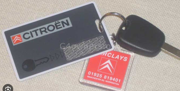

Re: Xtools D7 and programming C5 2006 key fob
It would originally been on a car that looks like the one below, you need to scratch off the panel to see it.
Your tool will likley be able to read this from the car though, make sure when reading the pin code if there is an option that you have a working key, dont select all keys are lost.
When reading the pin code your tester will likely get you to cycle the ignition on & off about 10 times. once you have the code keep a note of it.
