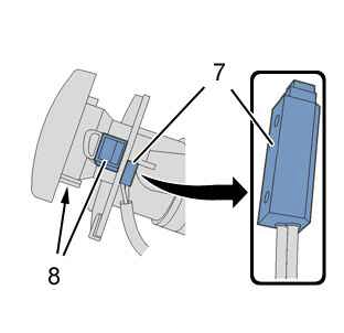

Would you be able to offer more advice please, we have a fault on the fuel cap now. I know this will cause an issue with the diesel additive so would like to fix sooner than later. We have checked the presence of the magnets so presume it is cable or sensor. Do you happen to know the part number/s I would need to replace?

The plug detection Harness itself is no longer available from Citroen, but you should check the actual cap to check the magnets are still there, but again having said this there are 2 variations - vehicles with and without a fuel cap presence sensor, so it's possible you may not have one.
The magnet (8) will line up with the sensor from the top end of the plug detection harness (7) when the cap is closed as shown above.
As this is only used to inform the Engine ECU that fuel may have been added, it is not crucial to the additive level or operation of the metering of the additive, as this is still done once the fuel level is checked to see if any additional fuel has been added.
It's one of the reasons why I think it was removed as it's not really required seeing as the fuel quantity is measured regardless, but the annoying thing will be the warning if still present.

What vehicle is this fitted to Marc? I'm intrigued as to why it would be fitted if it makes no difference to the additive being used. I agree the ECU would still pump additive regardless. Is it a money making scheme to get vehicles in a garage and on diagnostics that isn't needed? Or could this of been practice for the now very common AdBlue?
