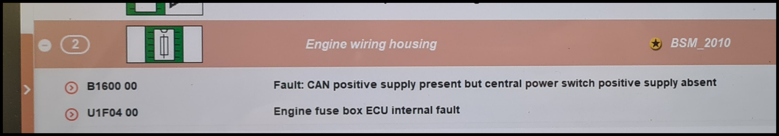

Observation:
• Whilst looking at the other open faults, I saw this:
• I cleared that code and nothing has returned even after a 45 minute drive.
• Not sure if this occurred as a result of me fiddling at the road side or if it was the cause of the original injector failure.
• Have visually checked the fuse box but all looks fine. Also checked the injector leads, which look normal.
