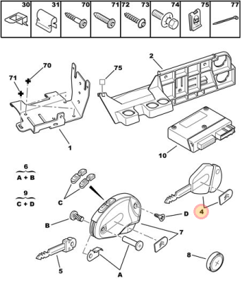

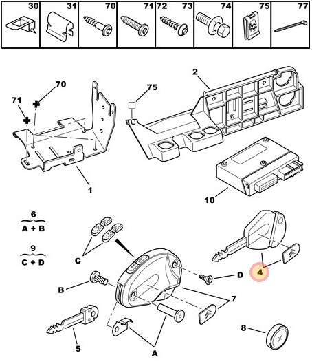

If you just want a spare key with integrated chip ready to be programmed to the vehicle, then Citroen still do an uncut key (they no longer supply combination cutting on order given the year).
(4) Lock Key (Uncut), part: 9926GX, £35.26 inc. VAT
This is the spare key non-fob type.
