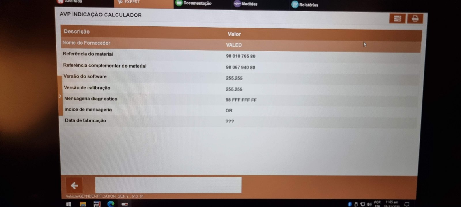

On the VPA module details page (image below), I saw strange information related to the SW version, calibration version and fabrication date. This is normal?
In your opinion, could this bad information be related to software problems (including the lack of sw loading in this module) or is it more likely related to a HW failure?

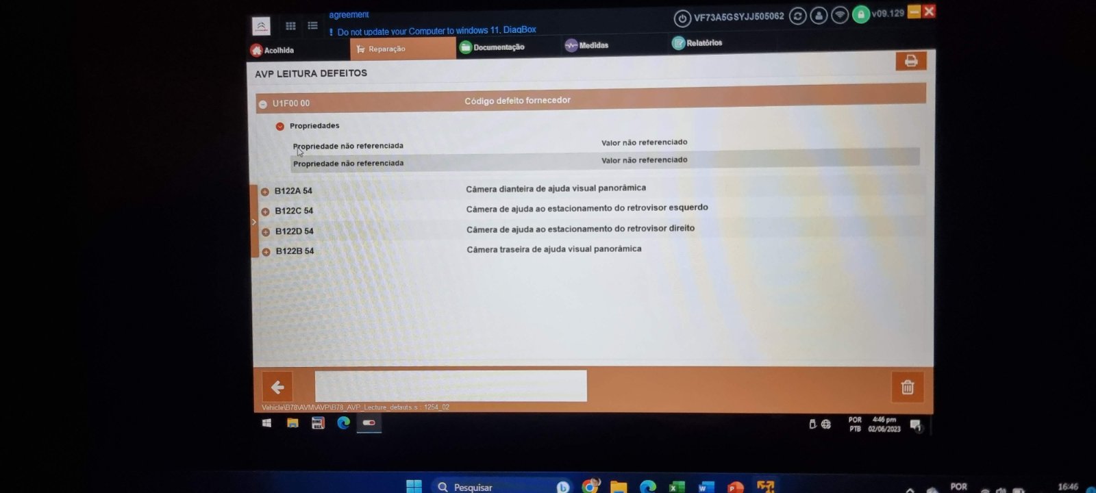

This is the list of faults related to this module:

Re: C4 spacetourer 2018 Visual Parking Assistance INOP
The faults all point to the calibration information being missing and this has to be done when the front camera is replaced for sure, but may apply to the system overall.
B122A 54 Front panoramic visual assistance camera fault: Calibration missing
B122B 54 Rear panoramic visual assistance camera fault: Calibration missing
B122C 54 Left-hand mirror parking assistance camera fault: Calibration missing
B122D 54 Right-hand mirror parking assistance camera fault: Calibration missing
So the first thing would be to recalibrate the camera system using Diagbox. Whether you will need any external equipment other than Diagbox I can't say. Or get your dealer to calibrate the system for you.
Good morning!
This problem was solved! Just to share...
The issue was in the Visual Parking Assistance control unit (PN 9806794080). I found a used part and after the replacement, all the cameras and 360º view back to work.
regards,
regards,
- Posts: 42019
- x 6955
Of course, if the calibration procedure does not work, then it's likely to be the ECU which you have found. Thanks for the update.
