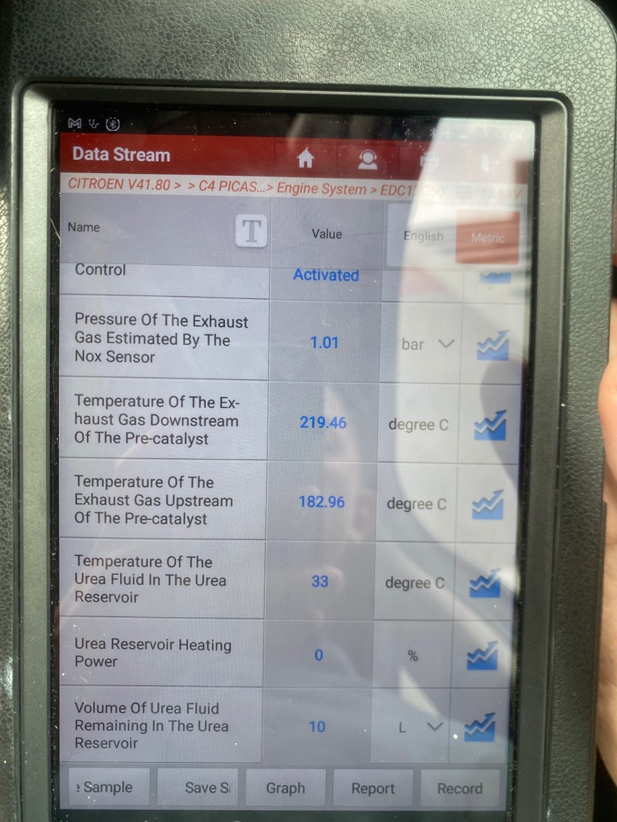

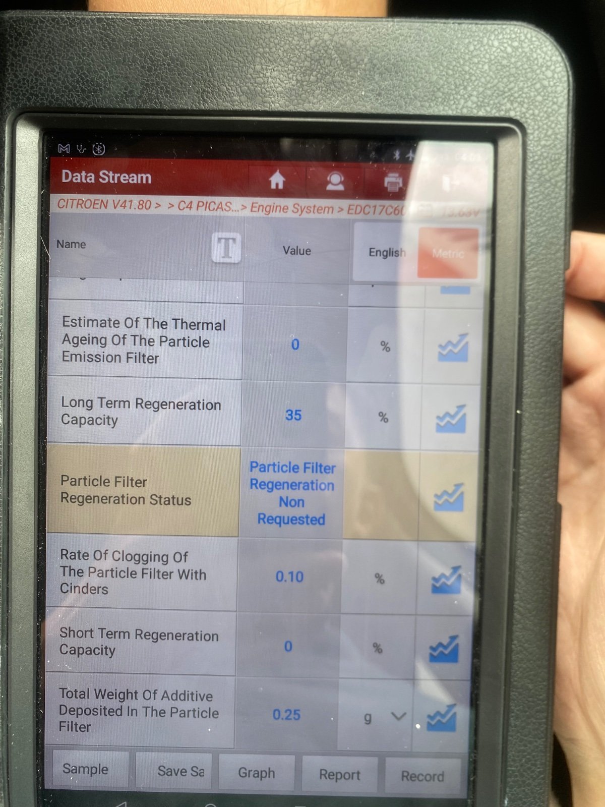

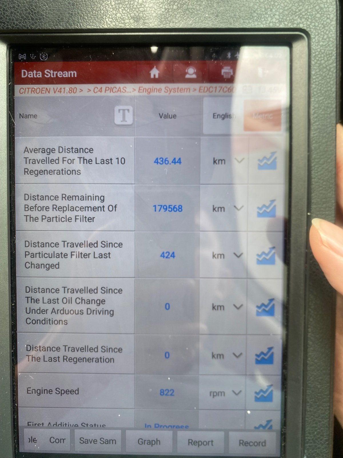

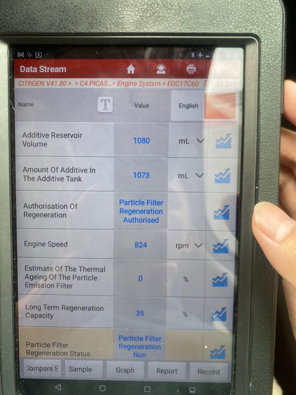

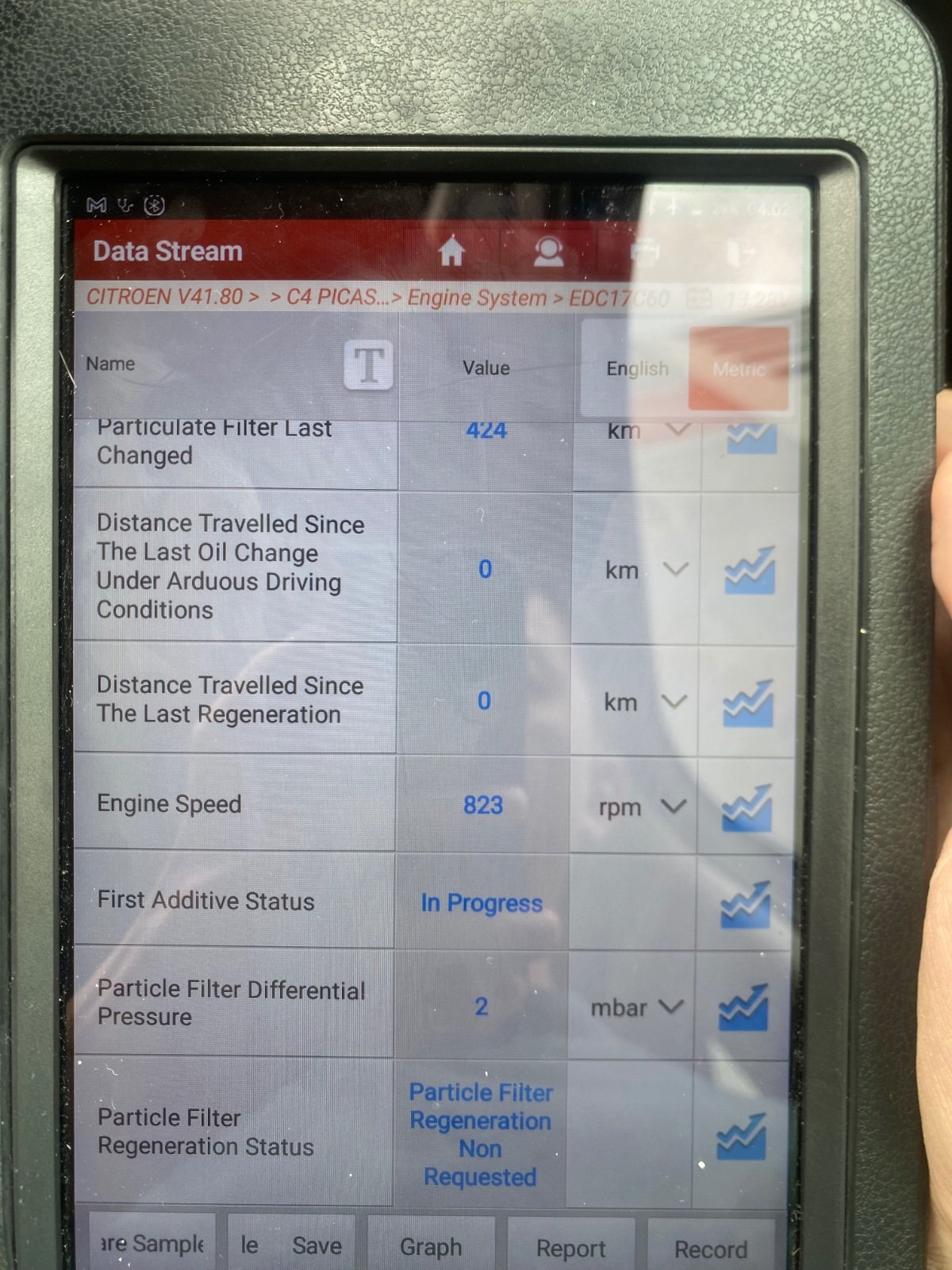

You never mentioned when you cleaned or replaced the DPF whether you had notified the Engine ECU that you have replaced the DPF under 'Pack Repair' options in Diagbox? If you do not do this, then the system will still think you have the original filter. You should also reset the DPF additive counter to zero (top it up first) as this needs to be done in order for it to reset the amount of Cerine that it estimates has passed through the DPF.

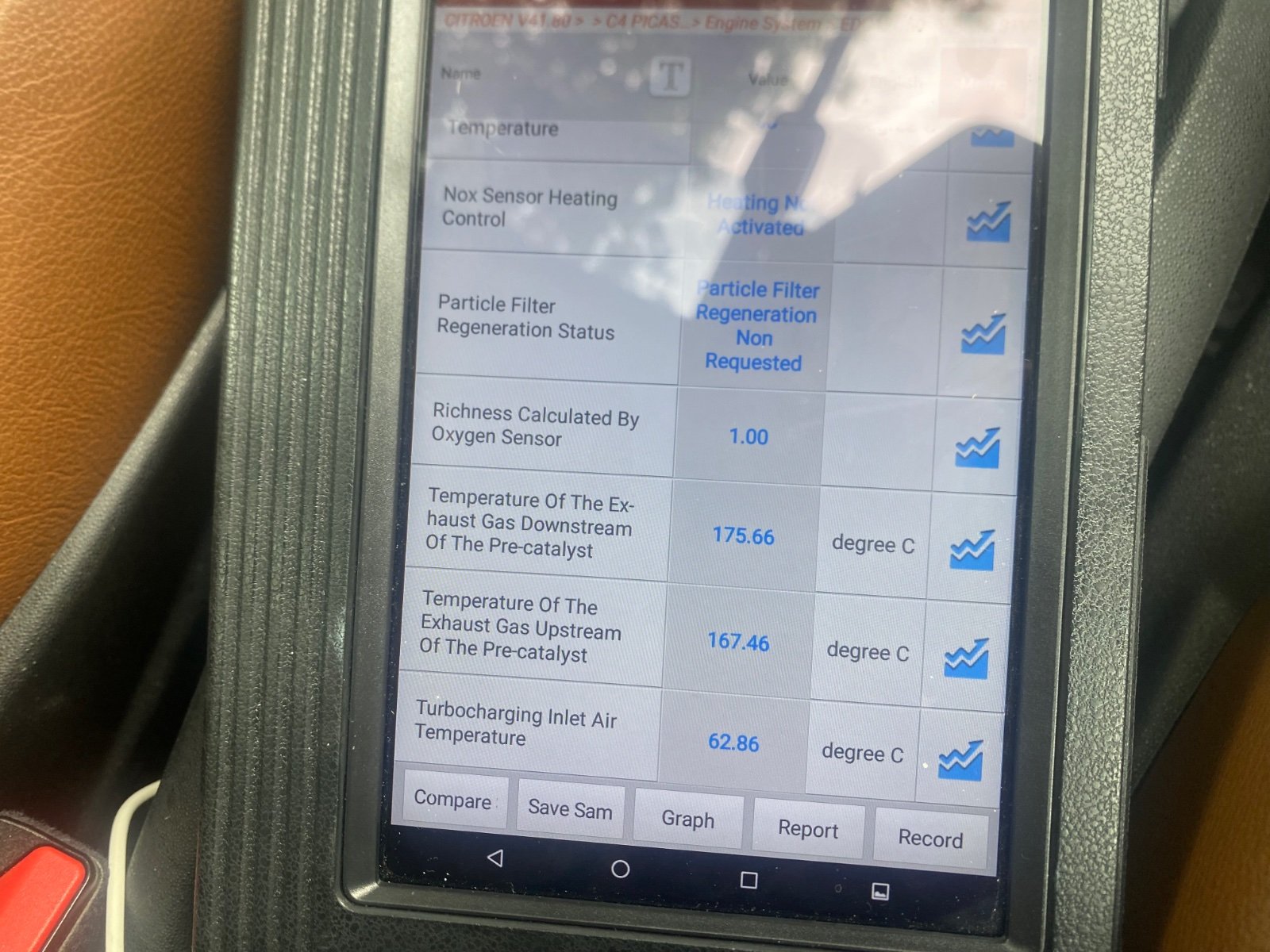

btw sorry i do not know how to check exhaust temperature, its downstream catalyic temperature that cannot go beyond 400 degrees .. i was driving 110kmph while reading the temperatures.. im so lost n stressed

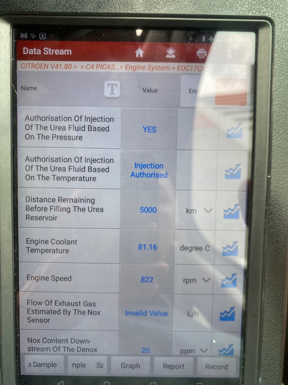

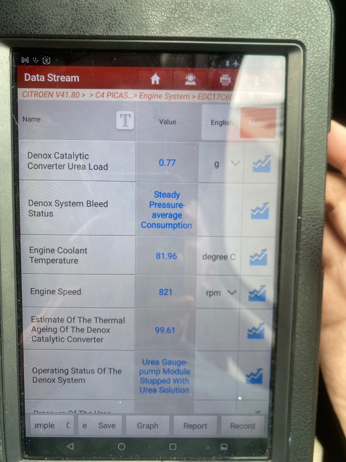

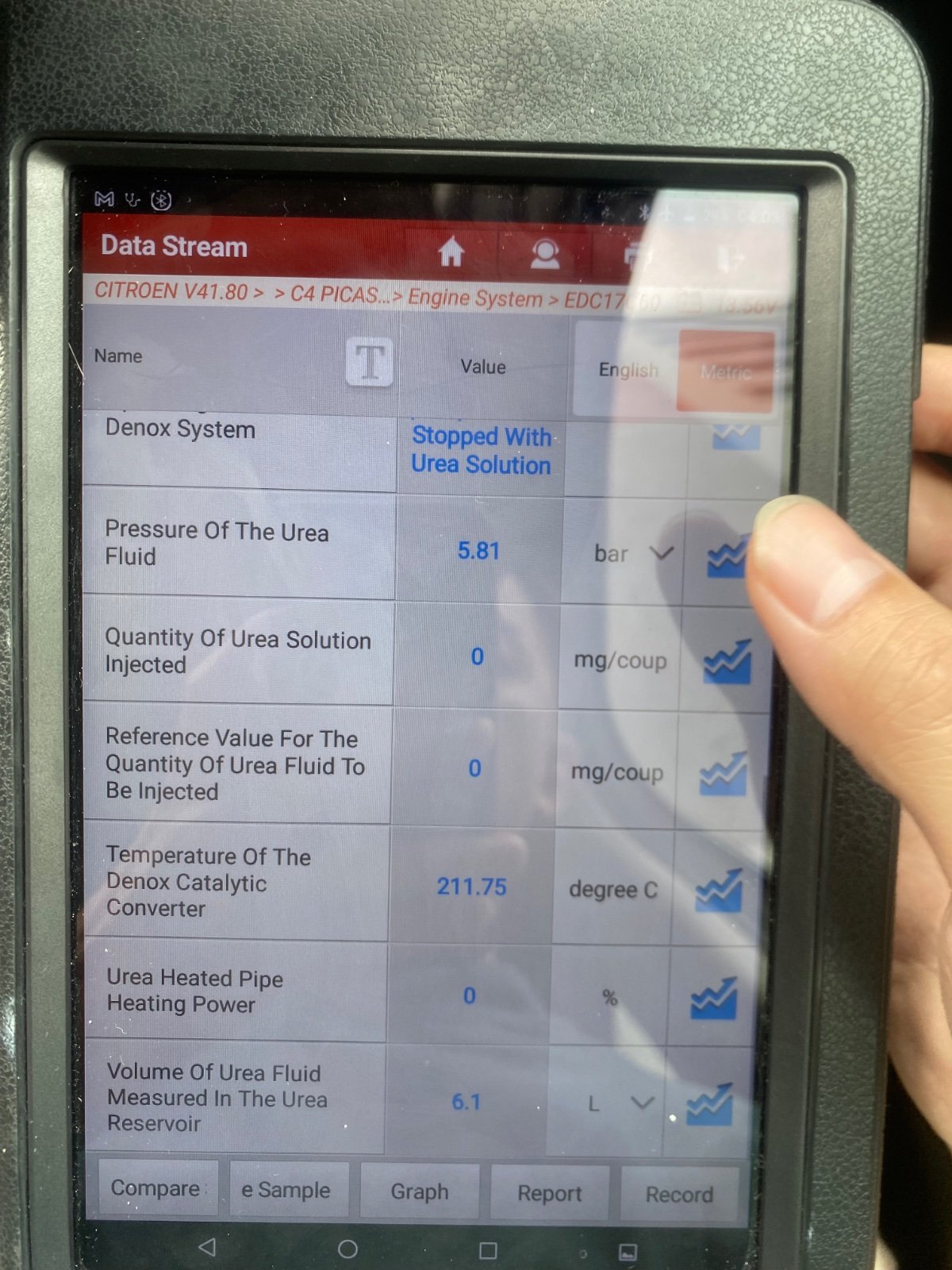

So I can see that the garage has told the engine ECU that the particle filter has been replaced and the additive level is reported as a litre, so all good on that front.
The only reason you would get a 'risk of clogging' message now is if the vehicle has been unable to regenerate the filter because of things like short journeys and interruption of the regeneration of the filter.

The DPF filter will naturally regenerate without assistance if the exhaust gas temperature is high enough (about 550°C), so to do that it would need to be on a good run like on a motorway / Autobahn. Assisted regeneration will be attempted at lower exhaust gas temperatures (circa 450°C) assuming there is additive fluid in the fuel system and that the engine ECU has all the conditions required to perform the operation when it is needed.
But check the additive fluid was topped up, as Wheeler suggested, as the additive level is only estimated - and will report full if the additive ECU setting has been reset without any actual fluid having being added. I only 'assumed' it had been topped up from the data reported in your pictures and had no reason to suspect it had not been.
