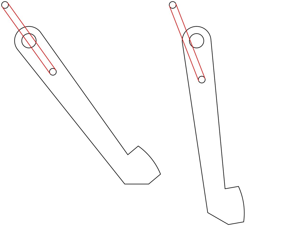

I cannot help much, but one thing to check is if there is a clutch assist spring on the pedal. As the clutch is pressed, this would progrssively add to the foot pressure. If the wrong spring has been fitted, or has been hooked on the wrong point, it could interfere with correct operation. See diagram, spring shown red (it is a tension spring).
