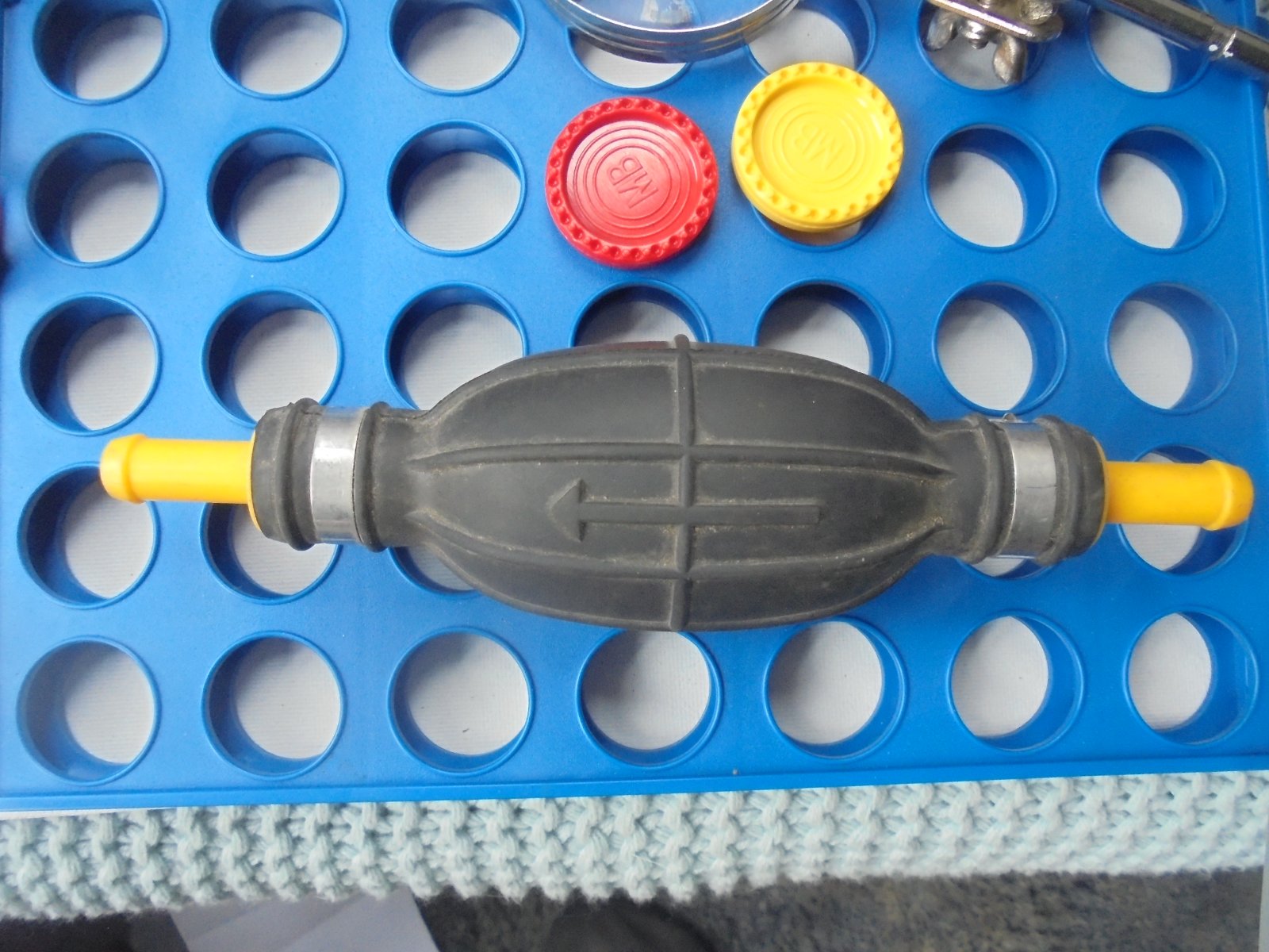

- Posts: 26422
- x 7163
Re: Hand bulb fuel primer before Filter housing
You may extract some useful help from the "punchline" to a replacement of the primer bulb on the Dispatch here...
viewtopic.php?p=685182#p685182
I think that would be more productive and more likely of long-term success than chasing round trying to find cheaper substitute bulb.
I bought one from a chandlers when having a flirtation with a biodiesel/svo conversion many years ago. I think it could well be an Evinrude part and it looks like this, totally unused. You are quite welcome to have it gratis but no recommendation from me as to longevity or effectiveness.
Have a read of all of the thread here, where members with greater knowledge than me made contributions and the original poster had a successful outcome.
