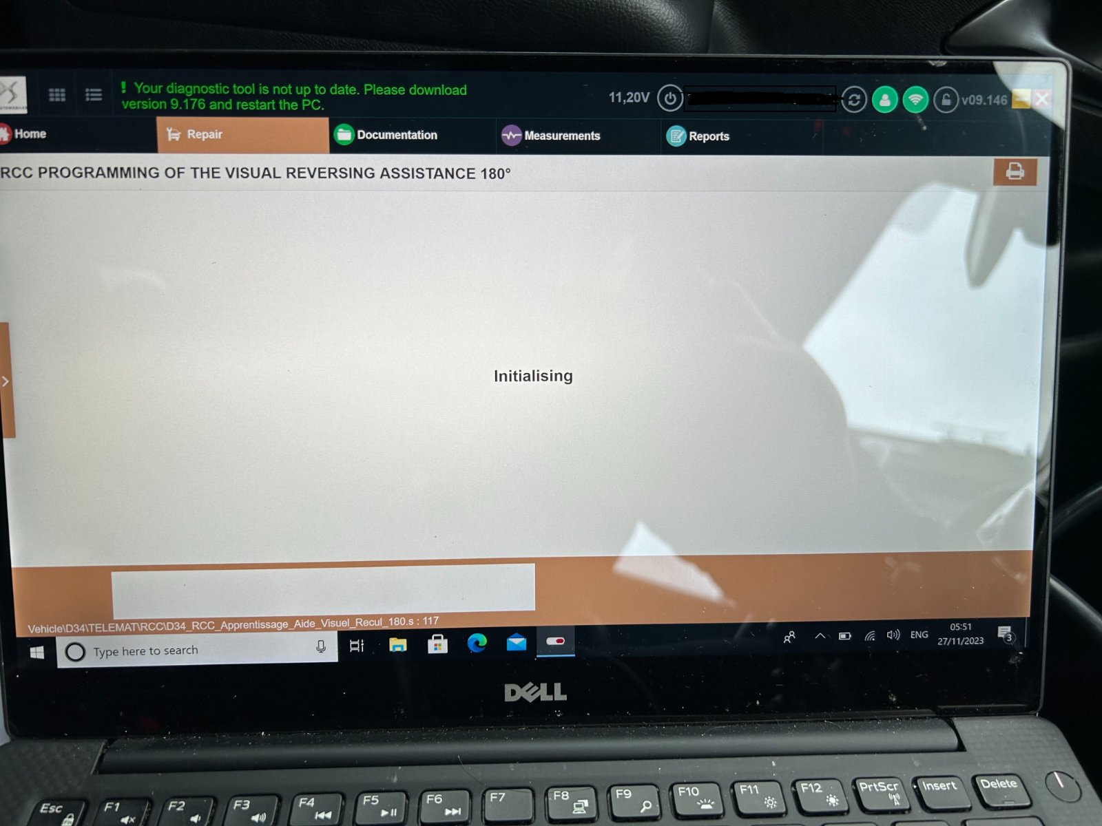

Figured the issue with the camera.
The camera needs to be activated in the vehicle delivery section of Diagbox, and that is the part I have completed.

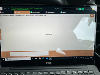

But also the camera needs to be enabled in the telematic Unit. (Repair->Telematic Unit->Repair->Pack Repair-> Initialising->Programming of the visual reversing assistance 180.
I have a problem where after clicking the program I am stuck on the Initialising screen, I waited 15 minutes, and nothing was happening, the lock icon in the diagbox is always flashing at the same intervals.
Am I missing a step here? is there a reason the screen is stuck?

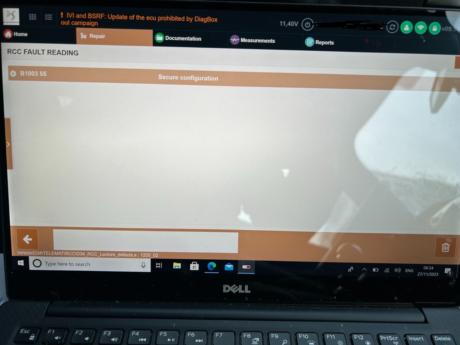

Can this be because I have a RCC Fault code? B1003 55 Secure configuration.
Thanks in advance!

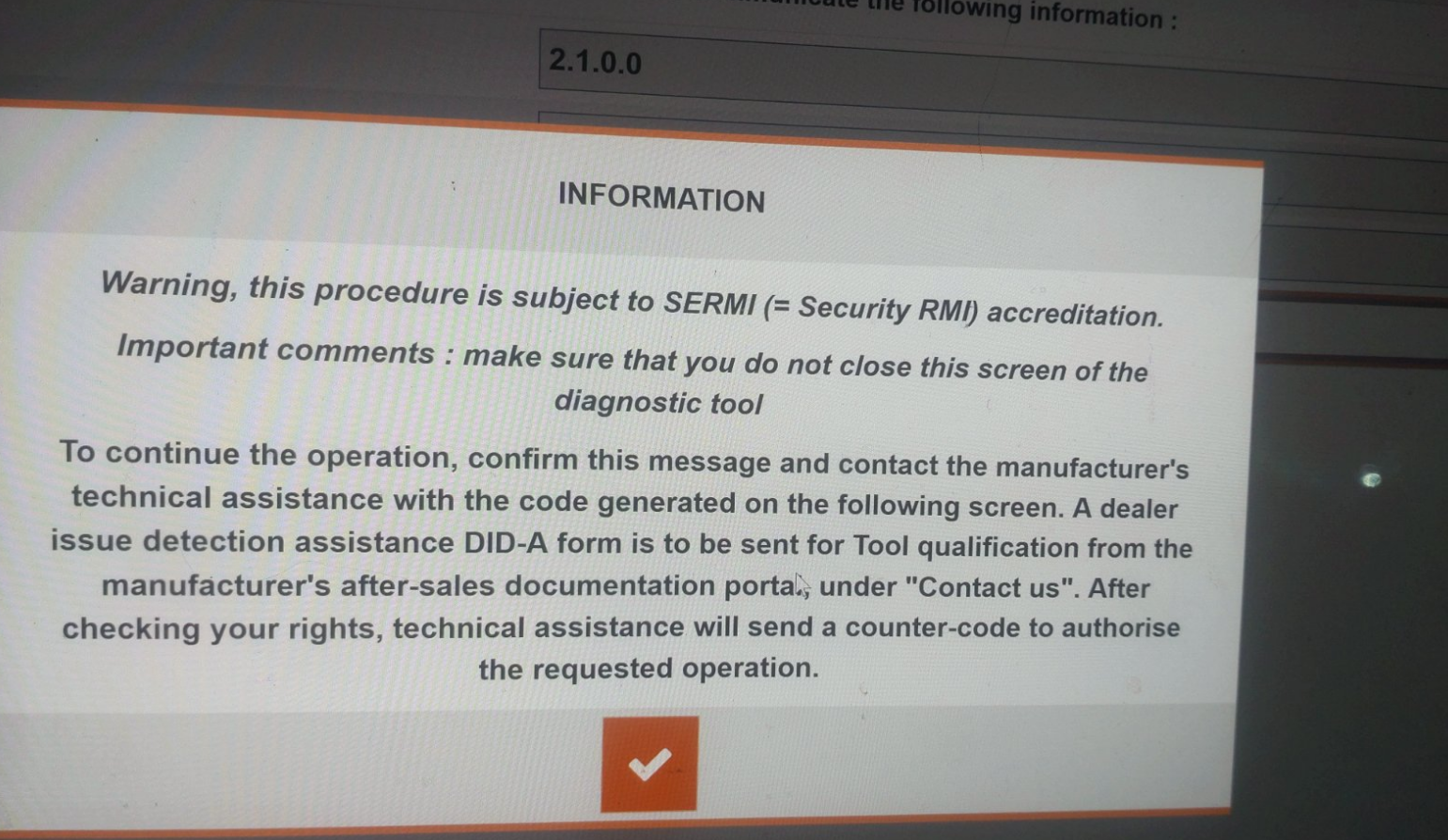

Re: DS3 Crossback Front PDC, Reverse Camera
This means it is in secure mode and needs authorisation before you can programme it - probably a token and authorisation code.

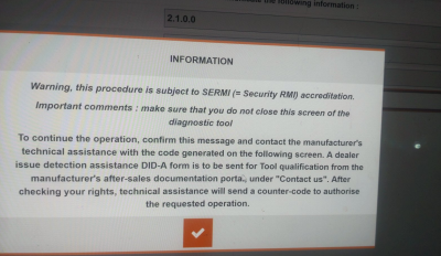

I believe you have to use their official version of Diagbox (and I see you aren't using the up to date version from the screenshot), and assume when you go to programme it that you will be given a reference which you provide and they authorise it in real time. I may be wrong but that is the way it's going now:
A member recently has a request that looks like this:
It's to prevent tempering with sensitive or safety devices for example on cars and only accredited individuals will be given access as far as I can see.
