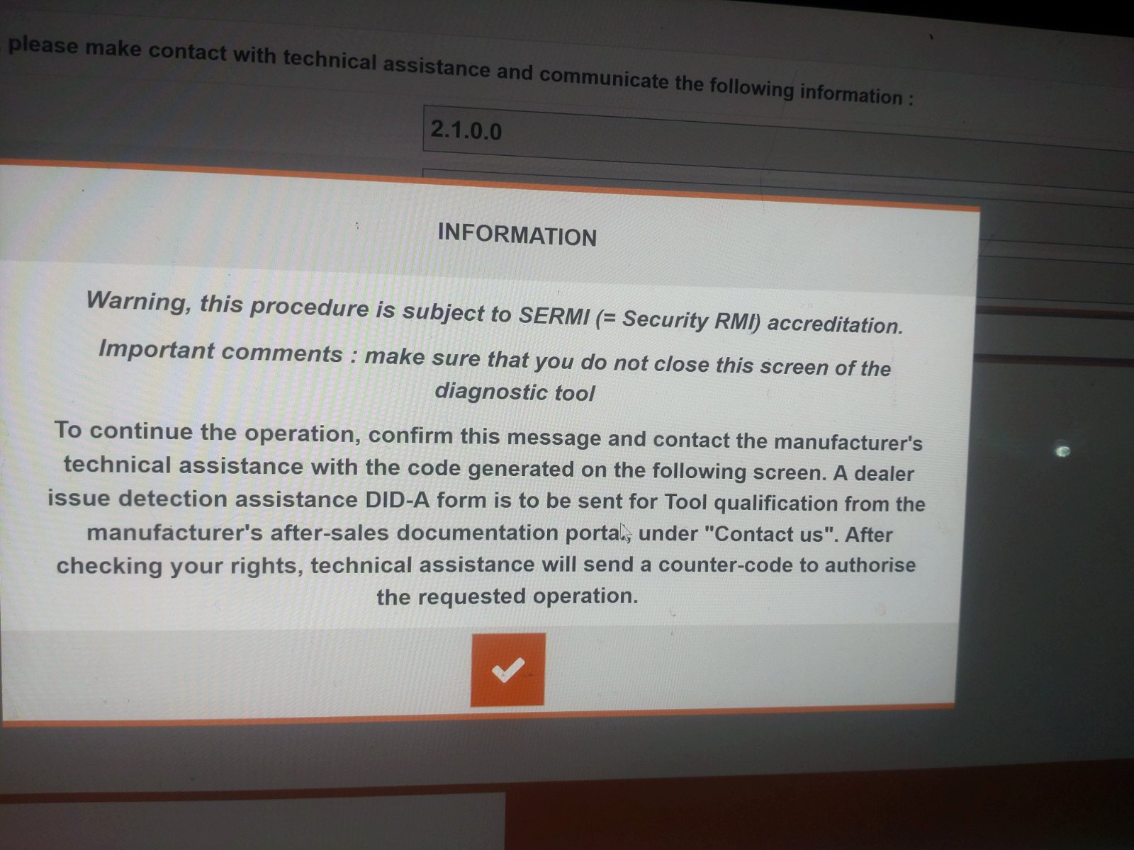

Re: programming new keys
I have tried today and its giving code which needs send to tech support to get login to next levelwheeler wrote: 20 Nov 2023, 07:31The key programming procedure hasn't really changed at all since the very first Citroen cars with coded keys, The only real difference on earlier cars you would go directly into the immobiliser or CPH menu to do it, now you go in via BSI. Apart from that its the same. Enter the 4 digit security code then input the total amount of keys you are programming & cycle each key with the ignition on when requested. After you have checked the vehicle starts if you have remotes, switch ignition on with each remote & press the lock button 4 or 5 times & repeat for each remote, this should sync the remotes.Peter Palmer wrote: 19 Nov 2023, 15:31 I've heard that its not that simple anymore. I can get the remoke key and blade from ebay no problem, its just the programming I'm now unsure of.
Do you have a pic of the screen? Never seen that before.
That's not exactly what you asking but it's will give you idea, to access key programming console you need MRI code generated from Citroen or buy online which will be generated after payment, in my case I have original cable, and account but dealing with Citroen technical support it's not easy, I bought the code online and it's worked
PS. This is for cars/vans 18+
Ah, i understand now, I did not realise you were using the legit version of Diagbox with tokens.
SERMI regulations have just recently started (but still not fully completed) requiring anyone working on vehicle security systems to be verified or have certain verification, its still ongoing at the moment & dont think it has been fully implemented yet.
This is actually the first example i have seen of it being used.
As far as the actual key programming process goes its just as i said above.
