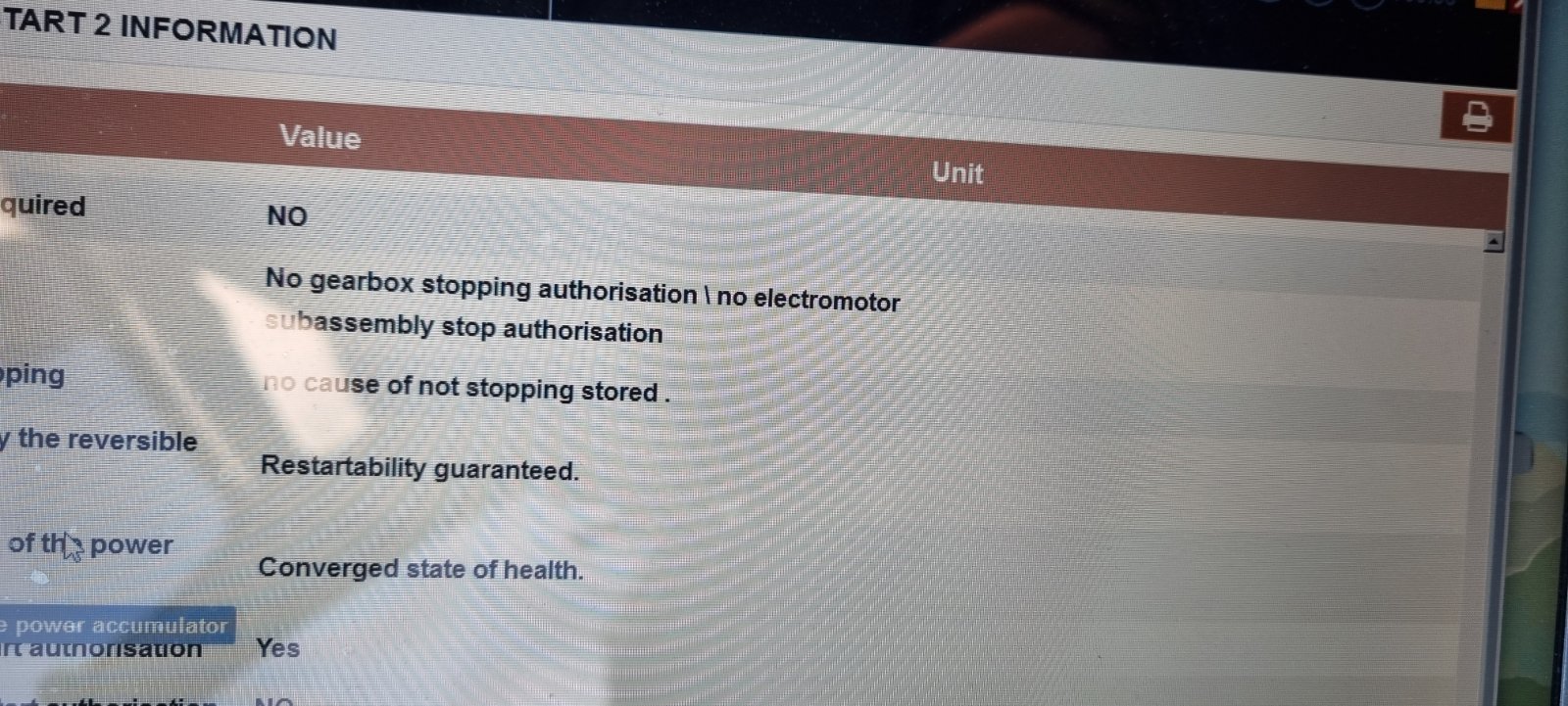

Im trying to figure out why my car is not stopping with start/stop. First issue was that the robot gearbox was not programed when the cluch was changed in a workshop (Peugeot Workshop 😔). I tried to talk to them about it but woth no success. I fixed that but one myself with diagbox.
The reason i dont understand is this:
no electromotor subassembly stop authorisation
Can anyone shed some light on this one.
Whats the electromotor subassembly?

No no error codes this authorization
"no electromotor subassembly stop authorisation"
Is shown in diagbox under ecu -> standard parameters -> start and stop 2 menu as a reason to why the start stop is not activating. Here is a picture before the hearbox was fixed.
So I just wanted to know what electromotor subassembly was but i could be the supply to the alternator the ultra cap assembly as you mentioned but im not sure.
It had previously been blocked by the programing of the robot gearbox but i solved that to day so only one reason left.
x 6945
Re: Peugeot 508 start/stop
I can see from that image that this is the live data you’re looking at. Have you run a full global diagnostic as yet?
