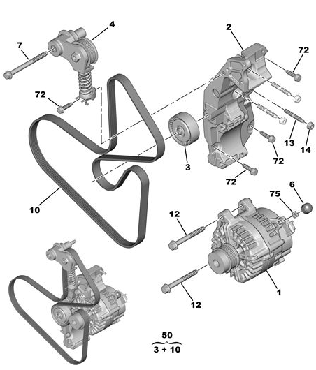

Morning all, just wondering if anyone has a diagram of the fanbelt routing for the C5 v6 3.0hdi?

Fans are electric Jay, do you mean the alternator belt?

I'm giving my age away using old terminology like "fan belt", but yes, it is the alternator belt I was after the routing for, so that diagram is spot on, cheers Marc.

Re: C5 (X7) v6 3.0HDI fan belt routing
:rofl2: No worries
Just remember not to compress the dynamic roller tensioner completely (risk of damage).

What other gubbinses does that belt run around?
Well on your engine you'll have a Coupled Power Steering pump that's also driven by the accessories belt and the A/C Compressor IIRC
