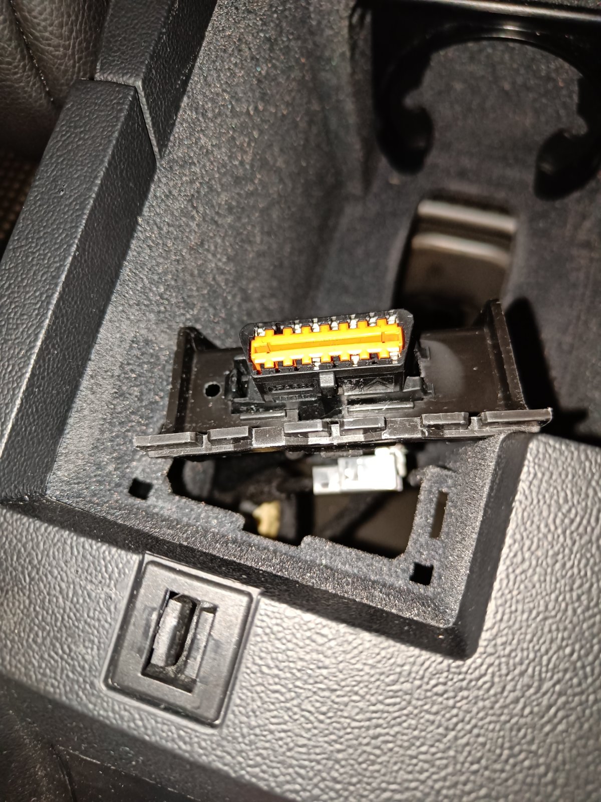

The purpose is to put an additional light panel in my car. Everything needed has been acquired: CAN relay, wiring harness, bracket, bandit connectors, plate connectors, pliers, etc. Information has been dug up here as well as from other forums and the internet. There seemed to be very little previous experience from people about installing additional lights in the C5.
Everything was planned to go well from start to finish. However, this rarely happens. The problem turned out to be that I can't find out from the OBD port to which different wires I should put the t-shaped bandit connectors. CAN-HI and CAN-LO come from the CAN relay, and the car's CAN bus also has its own HI and LO wires where these should be connected. As a guide, I had received that these HI and LO wires come from pins 6 and 14 of the OBD port.

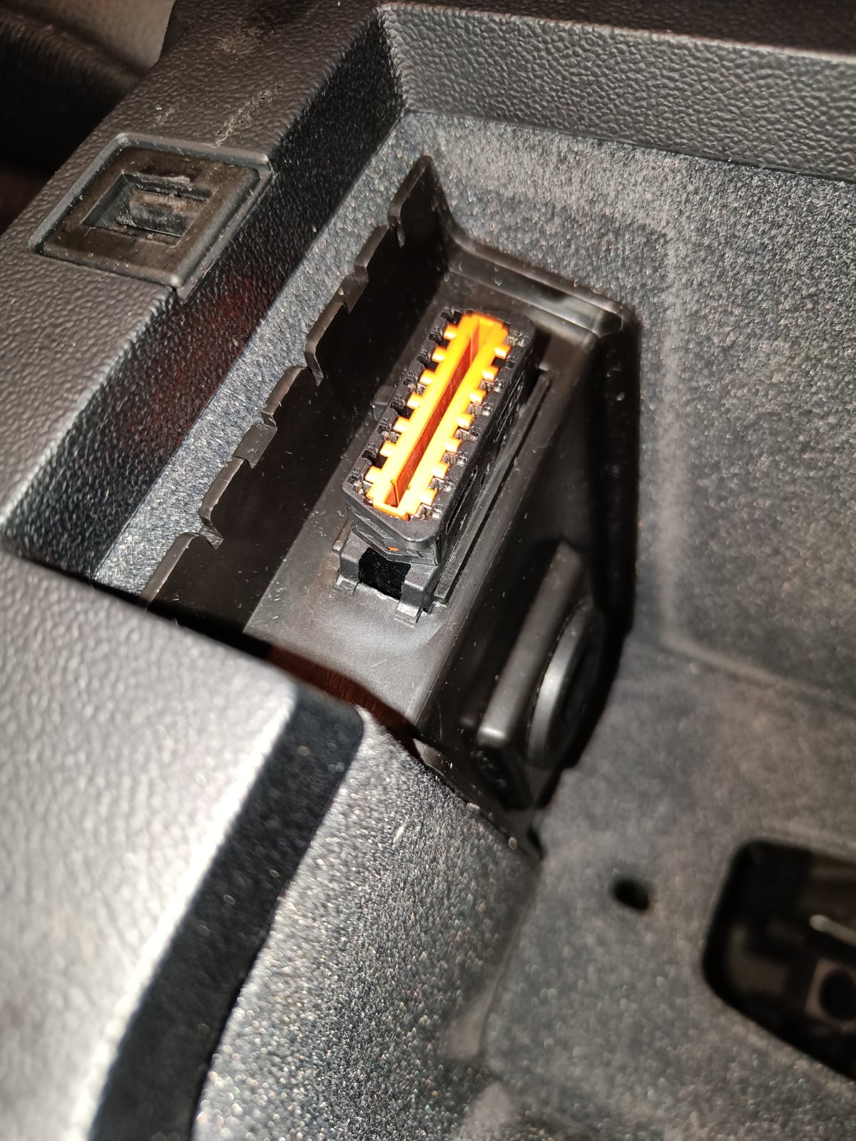

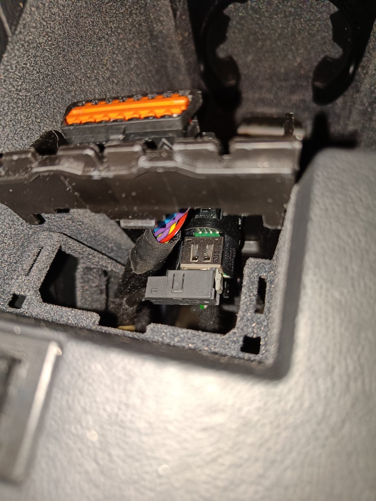

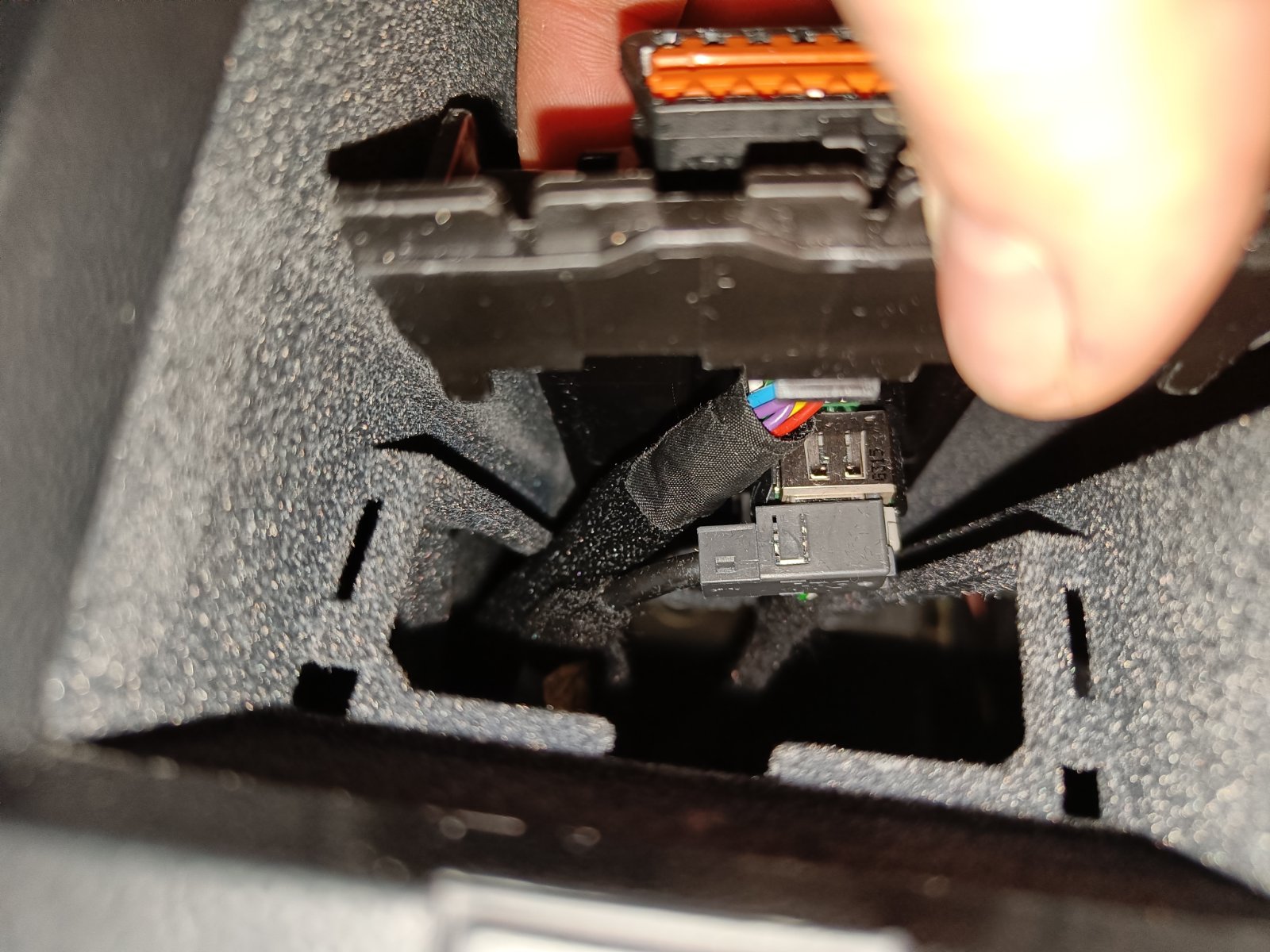

So I took it upon myself to remove the protections from the center console in order to expose the OBD port. With the strip tool I lifted the plastics off the console and tried to remove the plastic around the OBD port. For a few hours I watched and tried my best, but to no avail. It didn't help that the wires were dimensioned in such a way that I could only pull the plastic strip five centimeters outwards. It was absolutely impossible to see the wires coming from the pins, I tried to use the phone's camera to help, but I couldn't get the picture to be focused enough to do anything with it.
So the question is: is there any way to get the OBD port out of that plastic strip? The only way I could figure this out in my opinion. Does anyone have experience with putting additional lights in a C5 yourself with a CAN relay?
I included pictures just to be sure.
Thanks for the answers in advance!

Installation through CANbus, finnish subtitles only.
In this video you can see mechanic working on Benz ja the Canbus network going throught the passengers feet area, it was same in the my C5. I could see through the plastic covers caps that there was the same kinda wire set.
The installation seems pretty straight forward and simple but problem is how i can know the right cables if i dont see the other side of the OBD port.
I'll try to updste if get some progress on this thing
