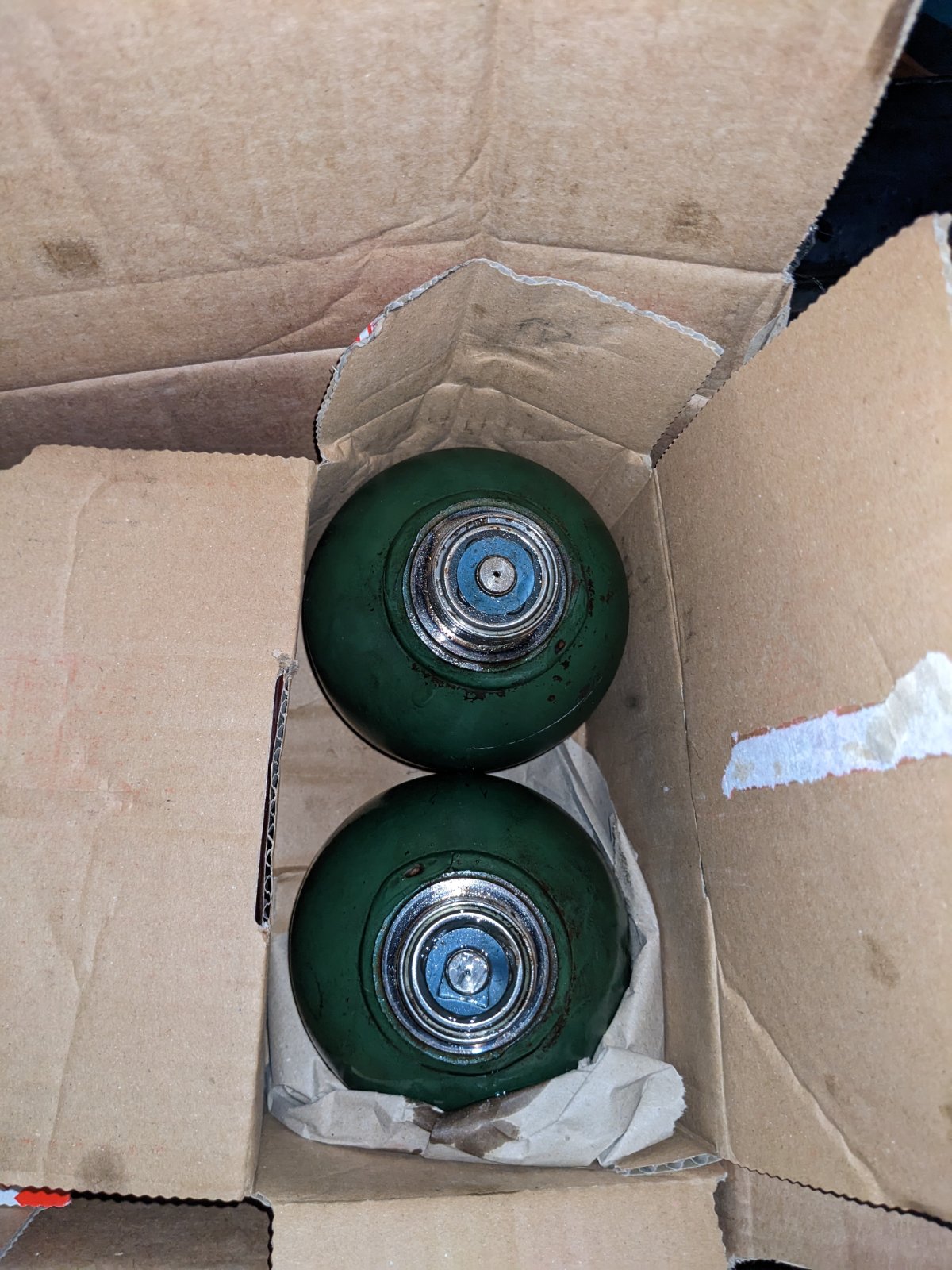

Good morning, bought New sphere's and fitted them no issues,my problem is the old one's had the inserts but the New one's didn't but only realised once fitted, it's cured the problem of hard suspension but now very bouncy,can the inserts be transferred,I can get them to turn but don't seem to want to come out, thanks. The picture is of the old one's.

Oh gosh! That's exceedingly dangerous... Those inserts are the dampers (shock-absorber analogues) so the ride will be very bouncy and boat-like...
What you were supplied with are accumulator spheres and definitely not to be used as corner spheres...
Get the correct ones on ASAP and I recommend you don't drive the car again until you have... If you must, put the old ones back on...
EDIT: You cannot move the damper inserts between spheres, they're pressed in and then a lip is formed on the end of the threaded part...

Thought they were wrong, very bouncy, Will put old one's back on tomorrow. Maybe that's why there's a couple of other issues I'm experiencing.
Thanks for your help.
Will see if autodoc will take them back.
