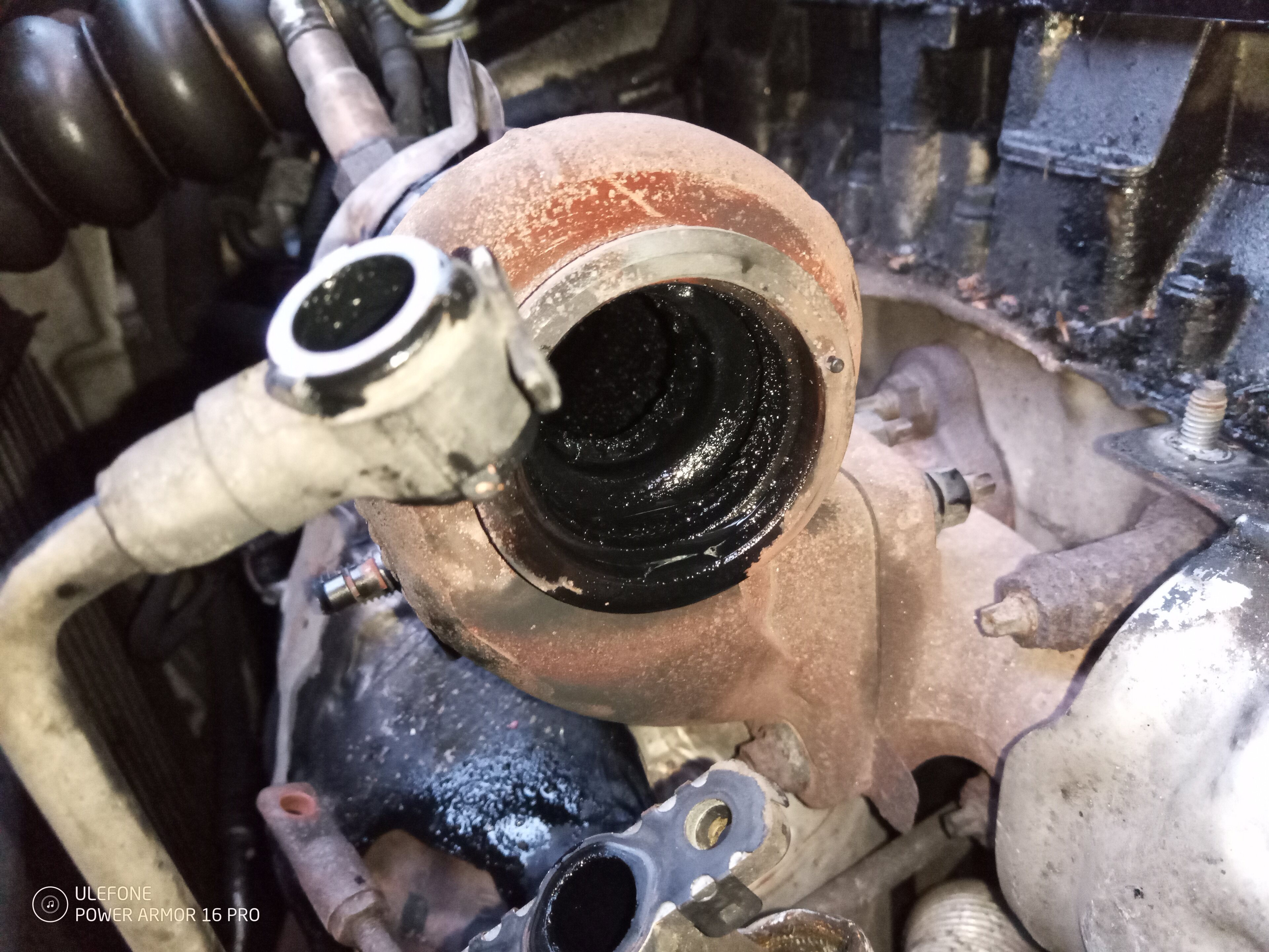

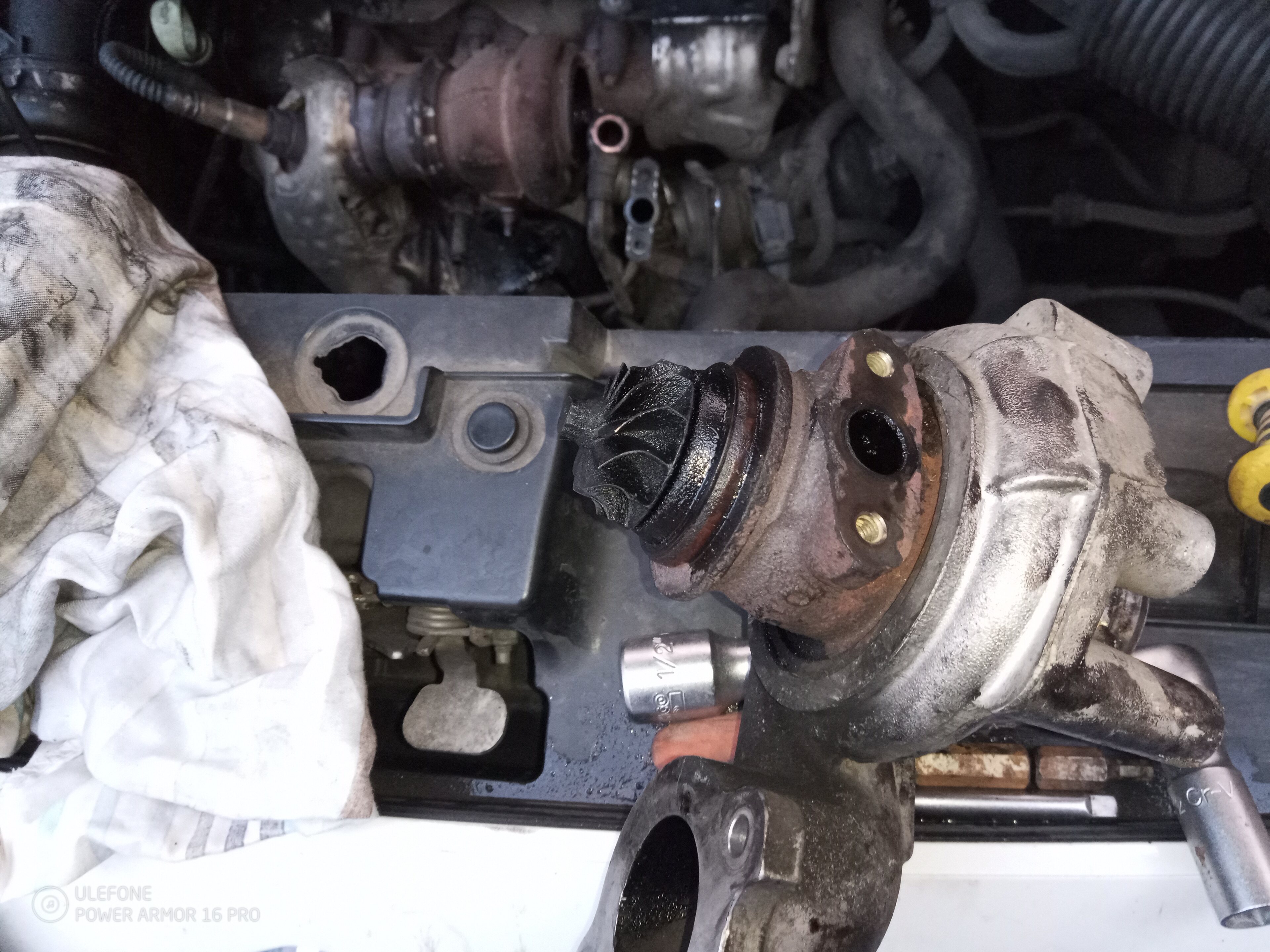

Ok, I've had a quick look at this today and removed the turbo.
Plenty of oil in the exhaust.
Turbo feels fine though, no play in the shaft or anything, oil seals must be knackered though to let that much into the exhaust. Oil looks like its still getting to the turbo no problem though.
It also seems that its only the exhaust side that has leaked so no chance of a runaway luckilly.
So next question, I've found plenty of turbo cassettes on ebay but most of them list compatibility for almost all the HDI's ours is the slightly later 8 valve unit, maybe a DV6C I think, are the cassetted different from the 16 valve or are they all the same? I don't understand all the different part numbers.
