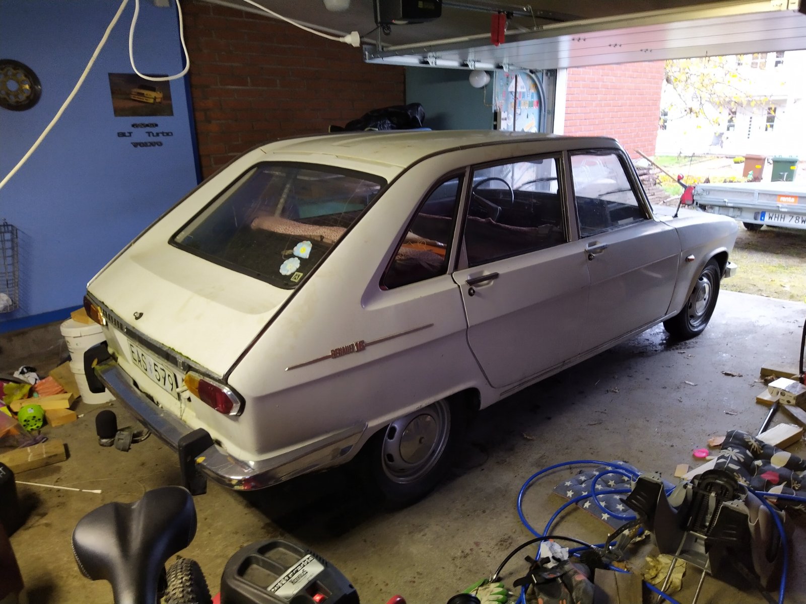

As a present for my 40th I got my brother's old car that he's had for about 15 years; a 1969 Renault 16 base, but with a TS engine. It was last MOT:d in 2013 and doesn't have a spark. The plan is to have this as a project for me and my 9 year old, with the goal of getting it through its final safety inspection. (I live in Sweden where cars over 50 years of age are MOT exempt, provided they have passed once after turning 50).
The car was sold new in Sweden, and has only had 4 previous owners, counting dealers and -obviously- my brother.

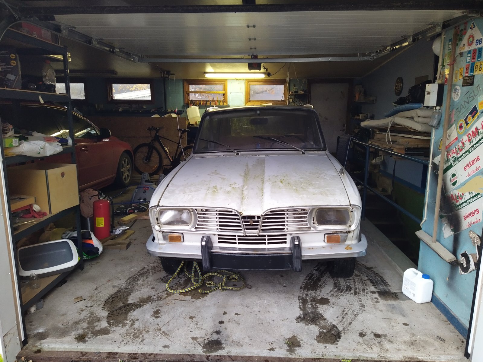

Its new home for the foreseeable future

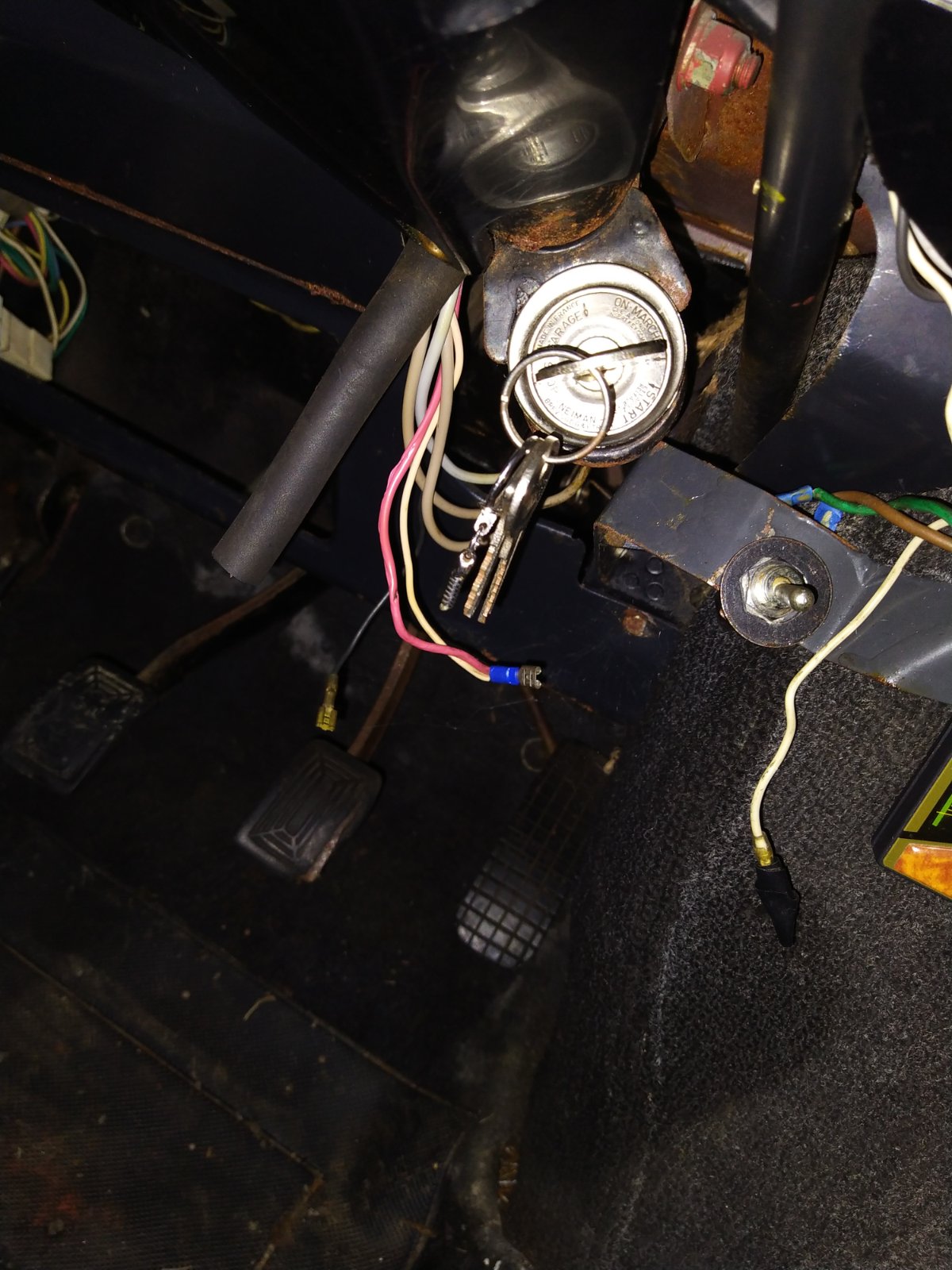

Initial troubleshooting revealed I don't have +12V to the coil with the key in the 'on' position, nor do the alternator warning light come on when I turn the key. Further investigation revealed these loose wires dangling by the ignition switch:
According to the wiring diagram, the yellowish cable should go to the coil. The red (and slightly melted) cable is in the diagram too, but I can't make out what it does.

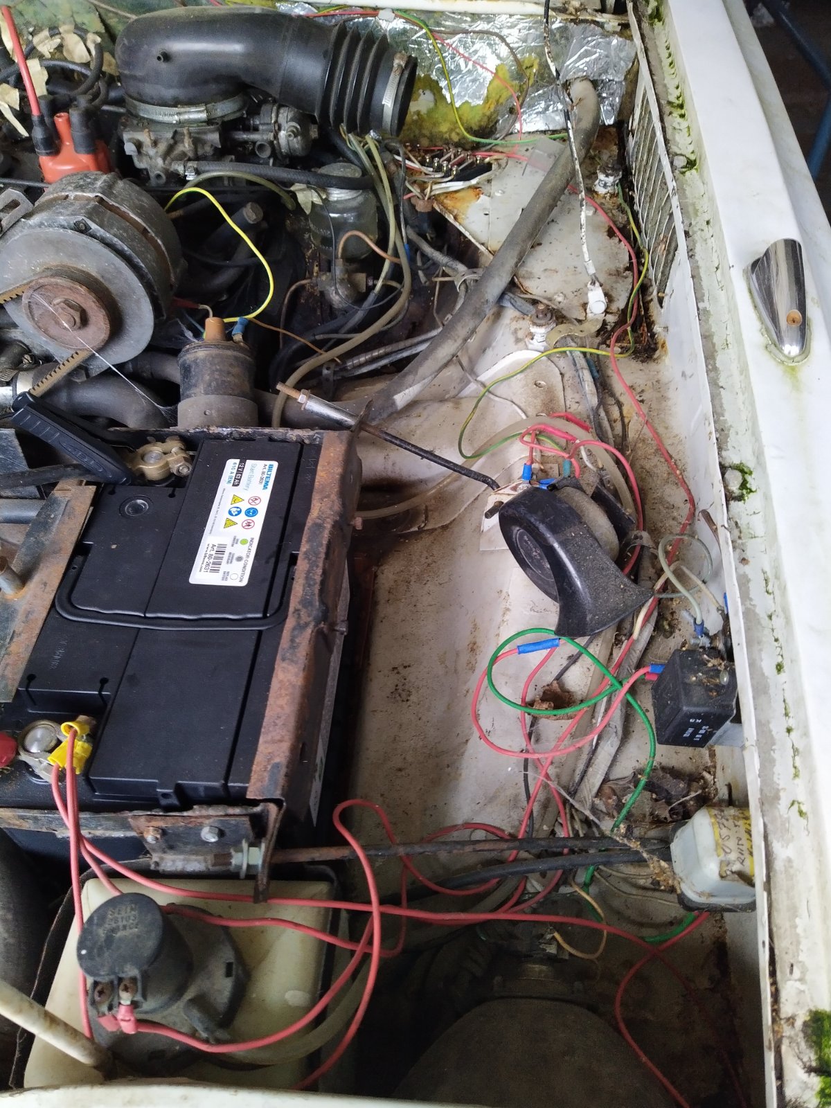

Troubleshooting the electrics isn't made easier by the fact that some previous owner (hopefully not my brother!) has gone to town running new cables in the worst way possible:

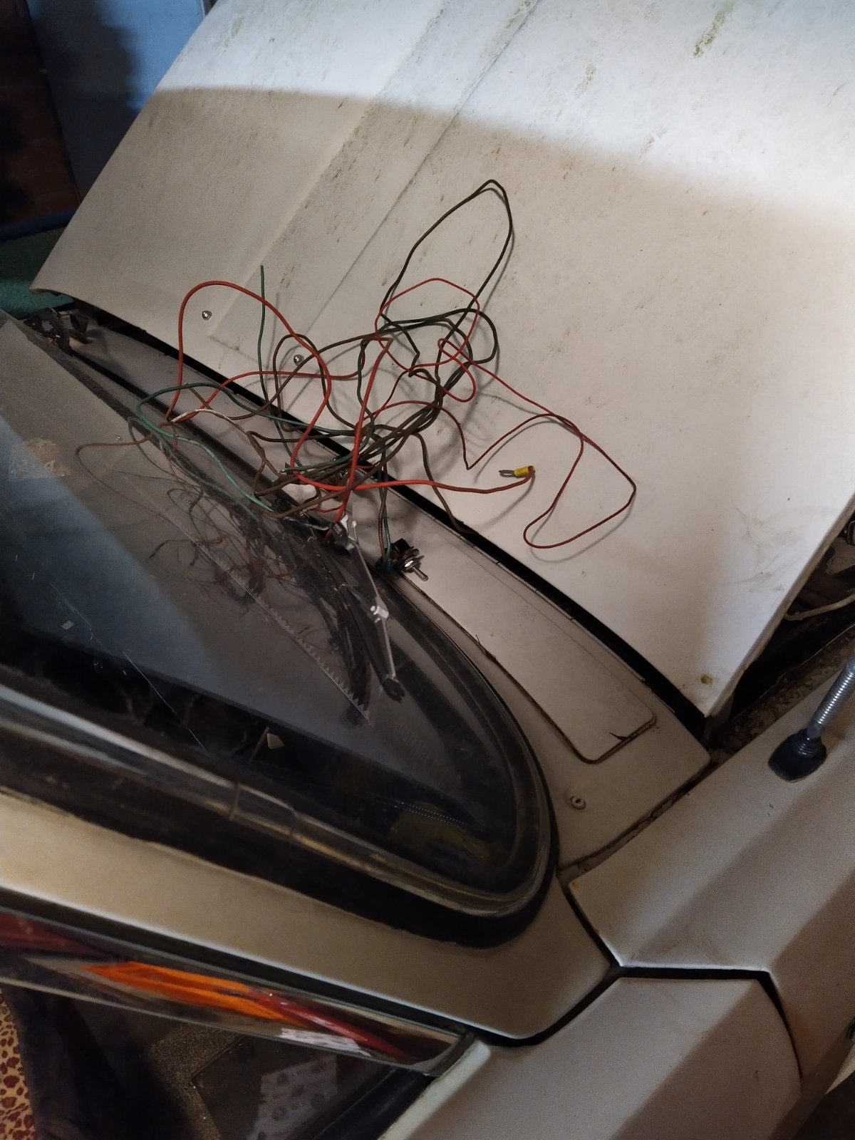

The troubleshooting continues. The lighter of the two cables did indeed go to the coil, so I cut the red wire to prevent it shorting out and connected the coil wire to the ignition switch. Hey presto, I've got +12V to the coil with the key on and when cranking.
You would think that should suffice to get a spark, but no. So more troubleshooting required, I suppose.
All's not lost though, as I at least got to rip some of the shoddy wiring out of the car. Most of it was for a manual switch for the cooling fan and the rest was for a radio which is no longer there. If I get the car in working order I will fix the electrics for the fan correctly, as I can't stand those manual toggle switches in my cars.
Wiring nightmare material
