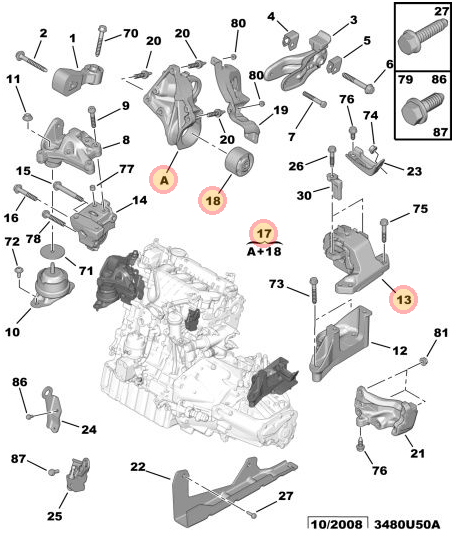

Is Anti-torque link 1806 H4 the right part for my engine?
On the website where I bought it from it says that it is compatible with my vehicle but looking at the diagram for my engine, this engine mount is not there. I Have only found it for a 2.0hdi 120kw engine.
I have also found this engine mount: Engine flexible bush 1809 21 :shock:
So, I'm a bit confused right now, about whether 1806 H4 or 1809 21 is the right part for my engine. Or do they both fit only in different places? :oops: :oops: :oops:
Also, what is the part number for the manual gearbox engine mount?

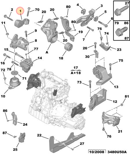

Ok, so If you could post future requests on the Parts Thread that would be helpful as I may not see the request otherwise (viewtopic.php?t=69962).
1) 180674 is correct
2) 188493 is NOT correct - this part number is not for your vehicle (did you mean 184493)?
3) 1806H4 is NOT correct.
So I hope you get a refund on those. Always check here first as we can provide the official part for your vehicle. Third party databases are not brilliant....
This is the diagram, let me know the item numbers you require and I will provide the part numbers:
I have marked item 1) already for you.

Yes, the part i bought is actually 184493, it is the part number 10 on the diagram.
So the part number 1806 H4 is not the correct engine mount for my engine as I suspected :oops: . Thanks for clarifying 👍
If there is total of 4 engine mounts I would need 2 more.
So numbers 13 and 18 from the diagram should be the other two engine mounts? Is that correct?
Thanks
x 6945
Re: Citroen C5 X7 2.0hdi 103kw engine mounts
It depends on what you want from the below:
(13) Engine Flexible Mounting (Left), part: 181394, £188.21
(17) Engine Mounting Bracket Right Side (which includes the bracket 'A' and the Flexible Mounting (18), part: 1807HT, £147.66
(18) Engine Flexible Mounting Only, part: 180921, £59.54

Numbers 18 and 13 is what I need, I think.
So Marc just to clarify, parts number 1, 10, 13 and 18 are all the engine mounts for this engine?
My goal is to change them all to Original parts to get rid of vibrations from the engine.
Number 13 is gearbox engine mount?
x 6945
(1) is the anti torque link (right)
(10) is the engine flexible mounting (right)
(13) is the engine flexible mounting (left)
This vehicle doesn't have (21) & (22) on the diagram.
(3) Is the Anti torque link (right), part: 180670, but is no longer available from Citroen
(8) Engine Mounting Bracket, part: 1839E0
(12) Is the left side engine mounting bracket, part: 1807X6.
(14) Is Engine Mounting Bracket (Right) Part: 1807HJ
(30) Is the Engine Suspension Limiter, Part: 180936
