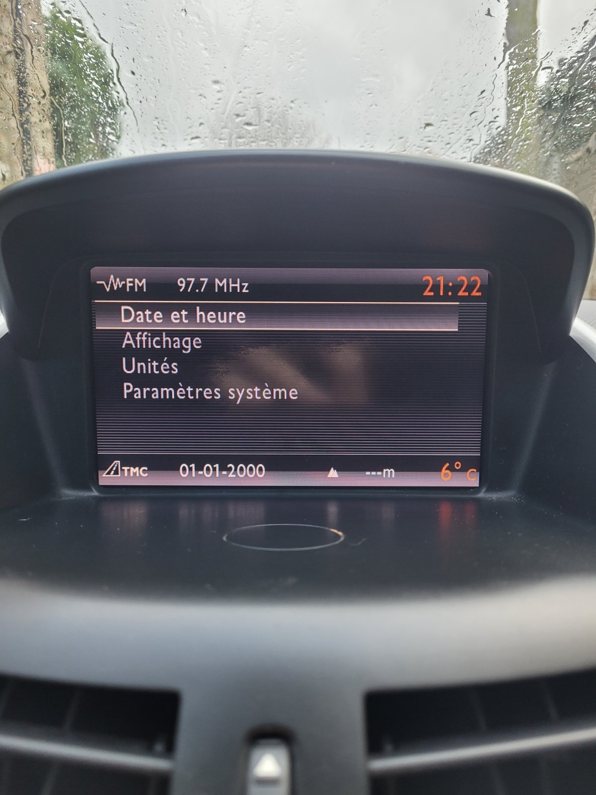

Re: RNEG MyWay Unit Display
Hi again,
These are the only menu's to choose from inside the SETUP menu. I've also figured out how to enter the hidden menu and couldn't find anything related to Language. I'll keep it brief because I have no idea what could cause those other menu's to be missing.
I will add that even the hidden menu's display in English it's literally just the setup menu that doesn't display in English. But the gauge cluster still displays in KM and I can't interface with the screen with the stalk buttons to check on economy or anything... The button on the indicator stalk also seems to trigger some French voice que that I can't make sense of.
Ok, so this looks like the result of a factory-defaulted unit, has it been replaced or reset using the hidden menu?
In this instance I don't think there's anything you can do except to ask the dealer if they can fix it by downloading the configuration from their servers and check the BSI is set up correctly. I've already checked the RNEG configuration data table and there are NO options for language or units, so something has reset it internally and I can't advise on how to restore the menu options.
