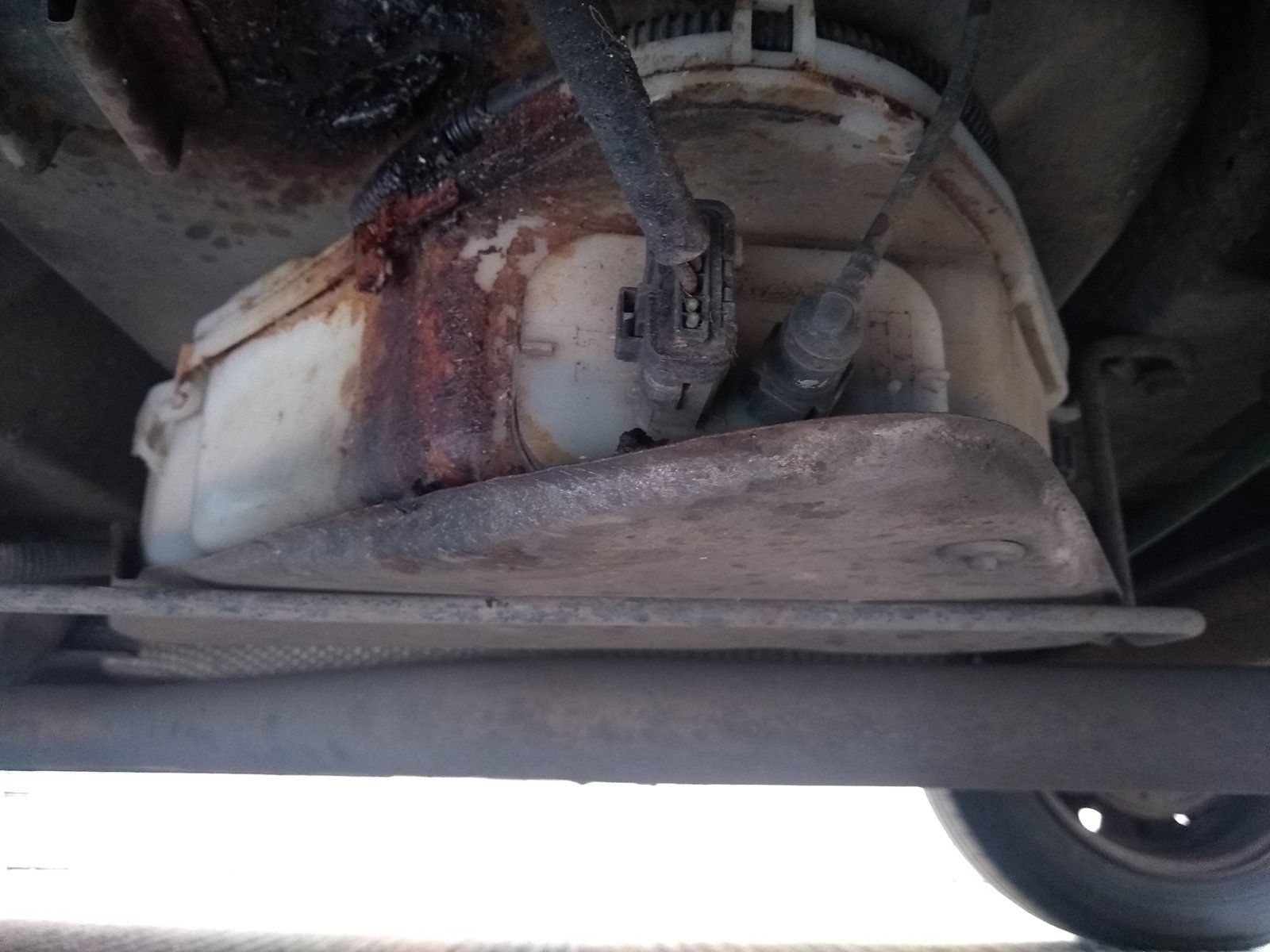

Thanks Marc again. The VIN number is VF7**************[VIN obfuscated, can be read by forum staff]. I am not sure to be honest whether it has a particle filter. I've tried to attach a picture of the tank in question (not sure whether this helps/adds anything though)?
- x 6950
Re: DPF & EOYLS Delete Query
Yep, this model does have DPF confirmed by your VIN and that is the additive tank in your picture. So the info in link I provided earlier is correct for this vehicle.

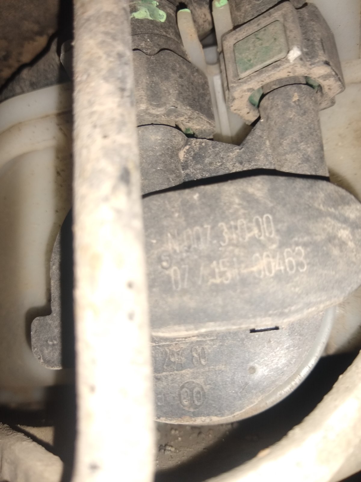

Again super guidance Marc. I looked at the ebay link and the 9 number (9640629480) in particular. I do not have access to a ramp for ease of viewing the number on my car, but managed to get a picture of some of the numbers that were not blocked by the metal bar and I could make out the final 5 numbers *****29480 (see picture). The other number starting N was an exact match too. I would be very hopeful this new tank is the same. I just now need to establish a garage that I have confidence in fitting it with the eoyls solution + doing the ECU reset you mentioned earlier. I'd be happy to travel (anywhere!) to find someone I could have this confidence in so any recommendations very welcome. Thanks again.
- x 6950
That's the one, so seems a perfect match.
