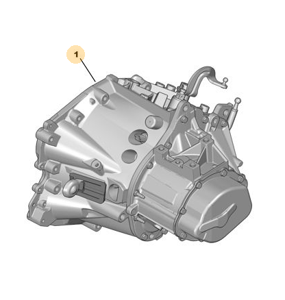

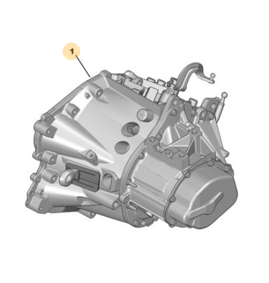

If this is for your vehicle VIN ending 475, then your gearbox is:
Original PSA Part: 2222FJ, (CP 17X77 -CT 19X17), Marking (DM4G) DM47
Exchange PSA Part: 2223LW (CP 17X77 -CT 19X17) Marking DM4G DMD7 (DMD7) DM47
You'll find reference to the markings above within the code you mentioned, but google on 2222FJ or 2223LW and you should see plenty of results.
