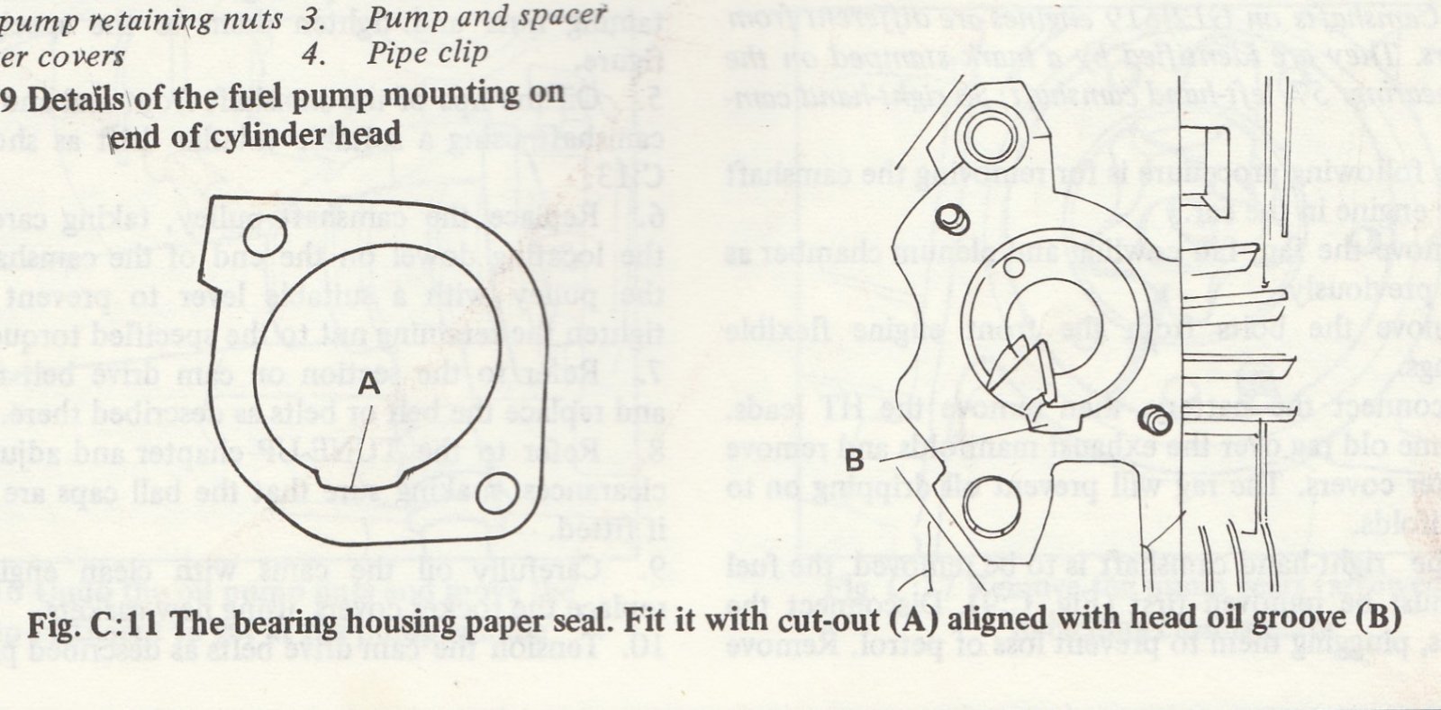

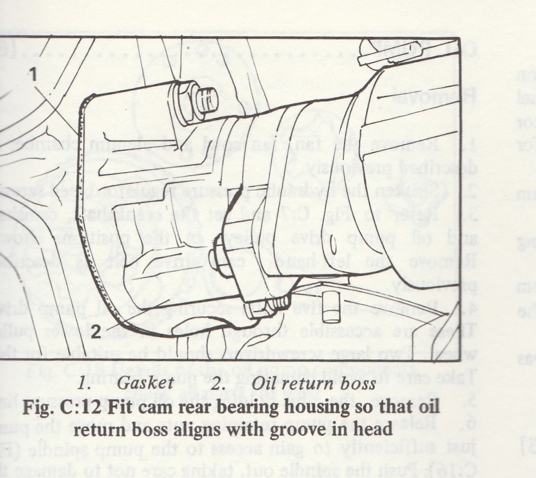

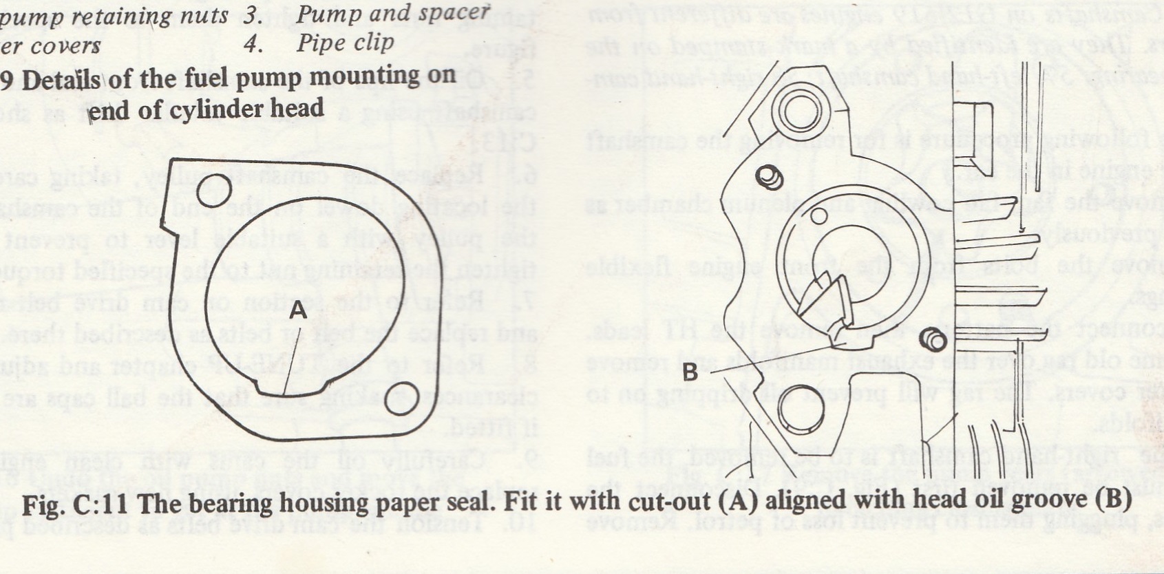

I cannot remember if the distributor has to be removed from the camshaft bearing housing, but access may demand it is.
It is important that the crankshaft (and thereby the camshaft) are NOT moved when the distributor is removed, and take note of the position of the rotor such that when returning the distributor it is in the same position. Otherwise retiming of the engine will be necessary.
Between the camshaft bearing and the cylinder head, there is a paper gasket which may be the cause of your oil leak. Is there a seoarate oil seal or 'O' ring in there? Hmm . . can't remember, and the manuals make only a reference to an oil seal at the front end.
Images from 'Autodata' book 278, Citroen GS from 1971. ISBN 5 013381 004159
Ignore the reference to 'fuel pump mounting' - it's for an image out of scan shot.
