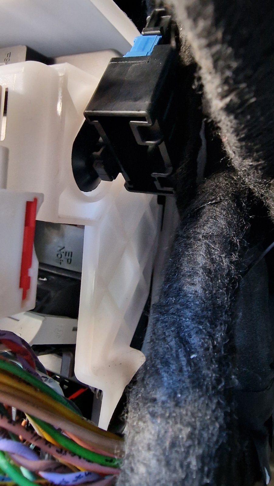

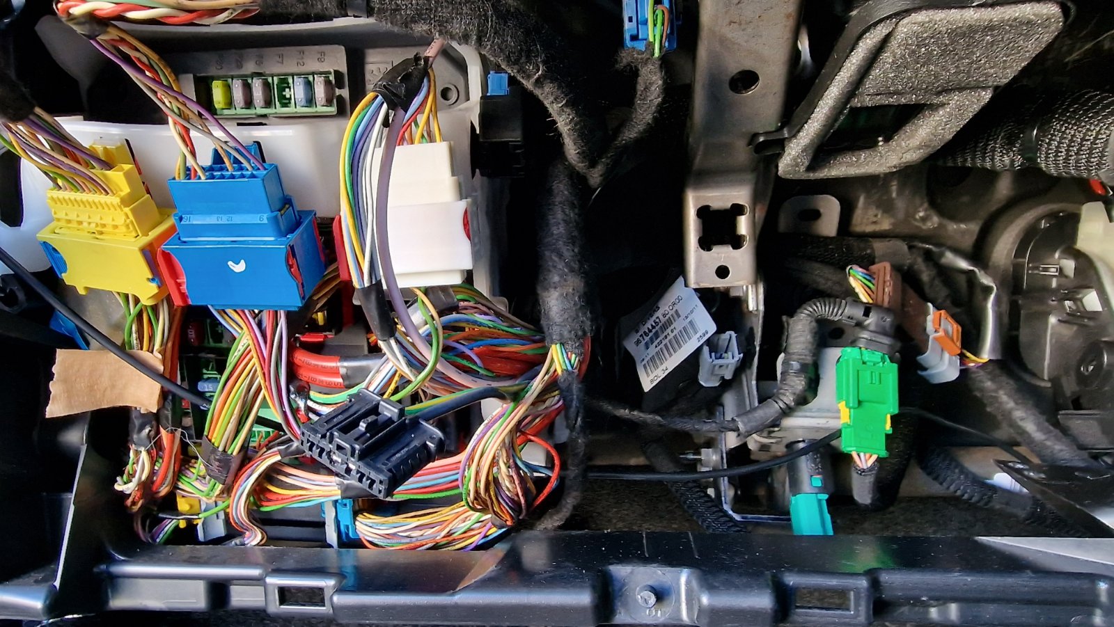

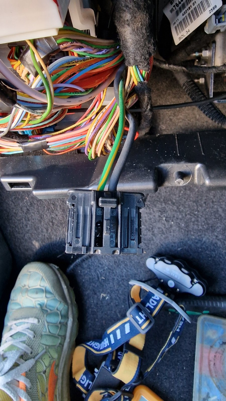

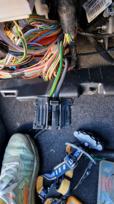

Behind the glove box is a connector, just 2 wires in it, these supply the control unit with the heatsink, which in turn supply the fan.

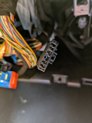

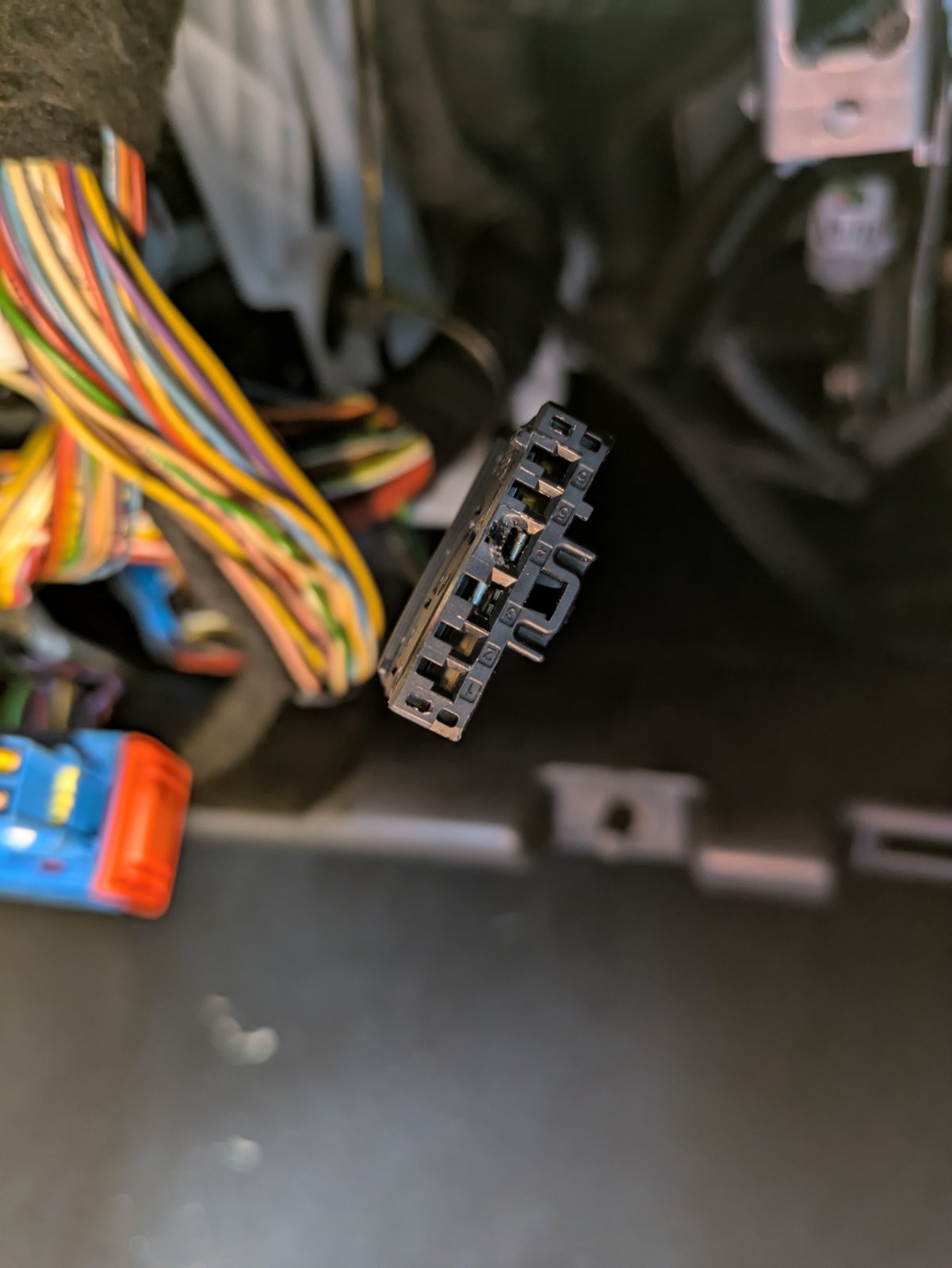

The wires going from the plug to the C.U. are fine, a good size, but the ground wire which is in the socket is thinner than it should be, which gets hot it the fan/aircon is used for a lengthy period, which in turn melts the socket slightly making the fitting looser than it should be.. which in turn gives a bad connection and the fan wont run.
I've attached pics of where the plug and socket are behind the glove box, hope it helps someone else with a similar problem.. I replaced the wire with a slightly thicker one and it is all working fine now.

Well, not sure if you are going to see it but after changing the resistor and checked everything and all seems working fine I found you post and voilà, that connector is melted, how you done it to replace the cable, it looks like doing that needs a lot of work

Thank you so much earthrob! My 18 year old daughter bought this lovely DS4 last week, but the blower motor wasn’t blowing… so I set out this morning to sort it out for her. When I took out the blower I knew that somebody had already tried, as the motor brand new. I was going to get a new resistor, but I just happened to find this post and decided to have a look, and there it was! A melted connector!!!
