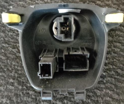

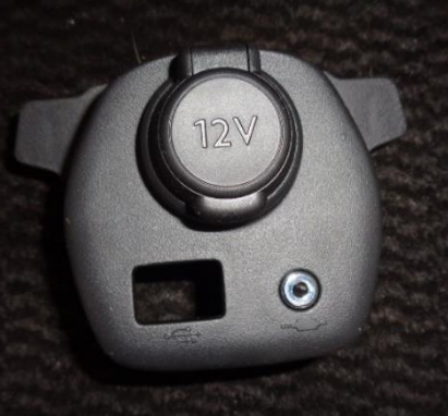

Re: Can I repair the aux socket in my Citroen C1 2018?
As you can see the plastic trim is just for holding the USB and AUX cables in place along with the connector for the 12v accessories socket. If the actual USB or AUX connector at the cable end behind the trim is damaged, you'll need a new connector harness.
