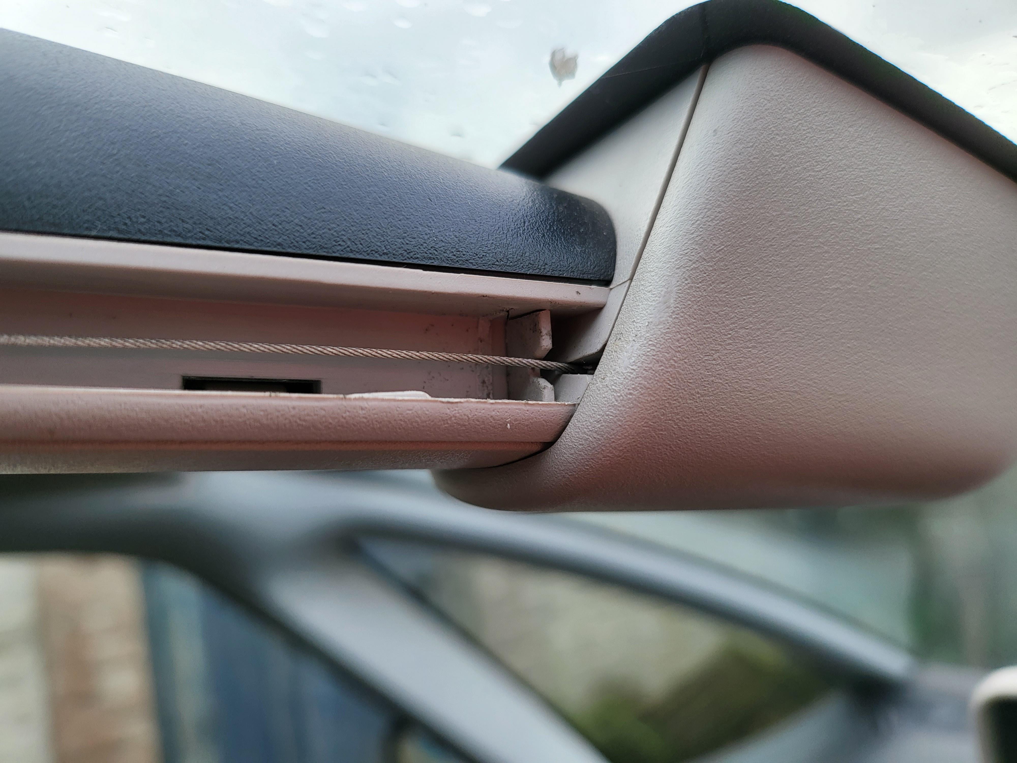

Another question for you - I've noticed that the sunblind on the drivers side doesn't latch in place, and won't stay down when driving. I think I've narrowed the problem down to a little plastic piece that's broken off - is there any way to replace it so the blind will lock in place?
Thanks!
