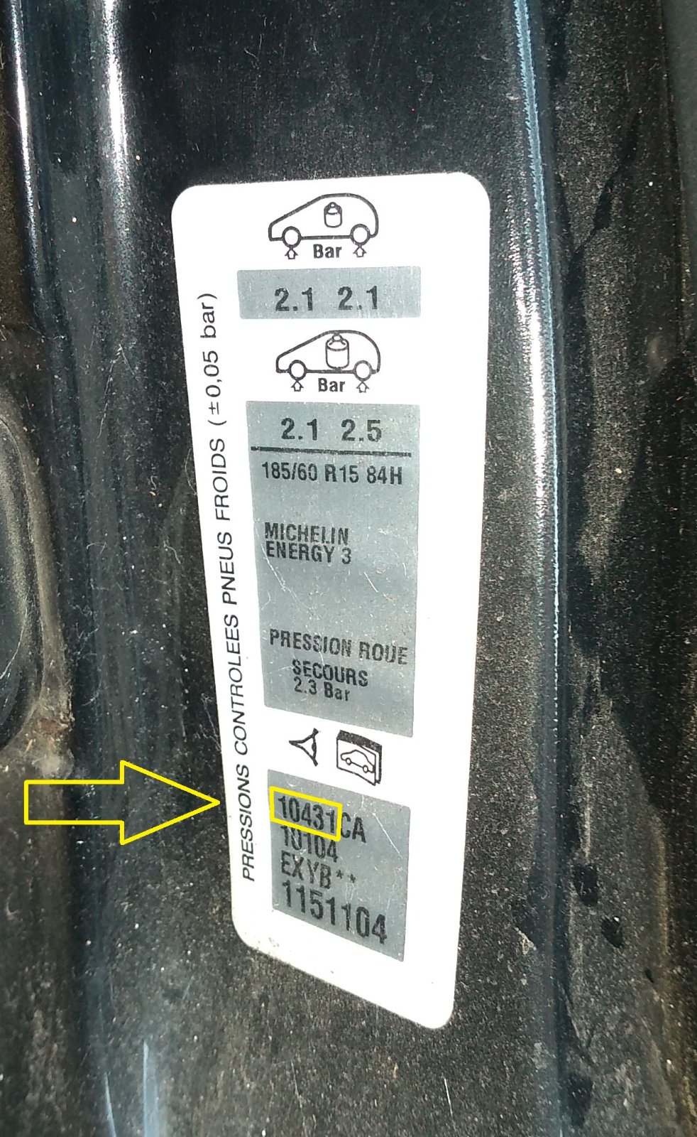

Where do i find the RPO number , in the door collum?

On one of the door pillars there should be a sticker with tyre pressures on. The RPO will be at the top of the sticker, then the paint code and then the pressures. It might also be on the Warranty booklet.

Location of RPO

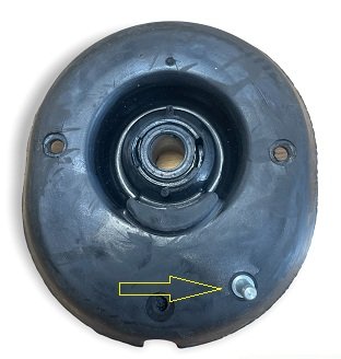

Here is a MK1 strut mount (note peg).

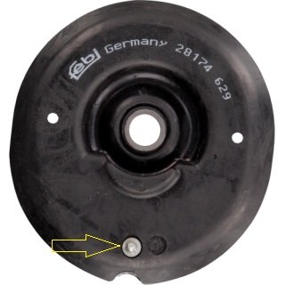

Here is a MK2 strut mount (note peg).

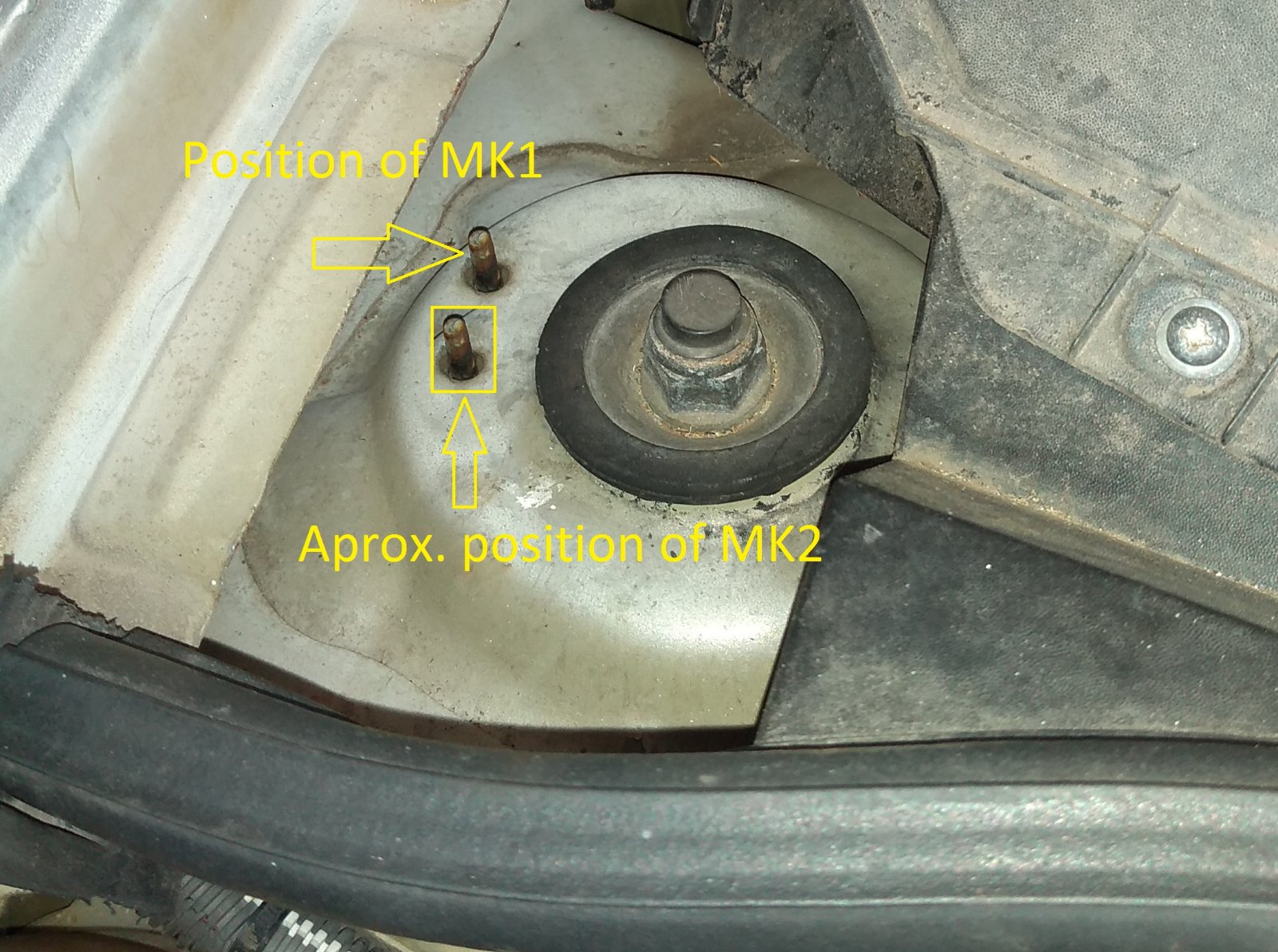

This is what the hole in the fender mount looks like (and my approximation of what a MK2 would look like). This pic is from a C3, so it's not exactly the same layout, but you get the picture.
In the MK2 both the left and right mounts are the same, meaning the holes in the fender for the pins are NOT mirrored. So when you look at the fender mounts from the front of the car, the left mount hole (looking from the front) is at the 8 O'clock position, whereas the right mount hole is at the 2 O'clock position!
