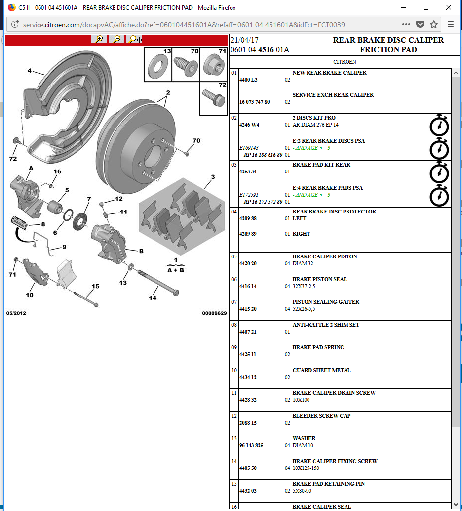

Is the battery loose ? That is in the gearbox area if it is your 2005 C5 and it might take 20 km/h for it to move slightly. Maybe there is a problem with the starter motor.
The rear brakes on the C5 to 2008 models can clunk and there is a shim that Citroen do (440721) which clips over the pads but is not part of the brakes when the car is made. I fit this to our 2004 and 2007 C5s. It can be seen here as part 8 download/file.php?id=8893&mode=view

The battery is firmly secured, and the sound is definitely coming from the front left side, where the gearbox sits, so it couldn't be the rear brakes. I hear those when they get stuck and it's definitely not that. 8-[
