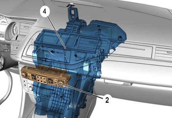

Hi!
Been having issues with the aircon leaking out within a week of regassing.
Mobile mechanic said the centre vents are leaking, he picked it up with a sniffer.
Thinks it might be the evaporator.
Does anyone know how easy this is to access?
He thinks it'll be an entire dash removal, which makes it not viable...
Thanks!
Paul
x 6950
Re: C5 x7 evaporator location
Hi Paul, unfortunately that is the case as it is part of the heating / Air-conditioning unit itself and the fascia has to be removed to get it out.
So I'd make sure I had a thorough diagnosis first - and maybe a second opinion from an A/C specialist first?

Yeah he was an ac specialist unfortunately.. He put dye in the week prior too and couldn't see it anywhere, so seems likely to be the evaporator
