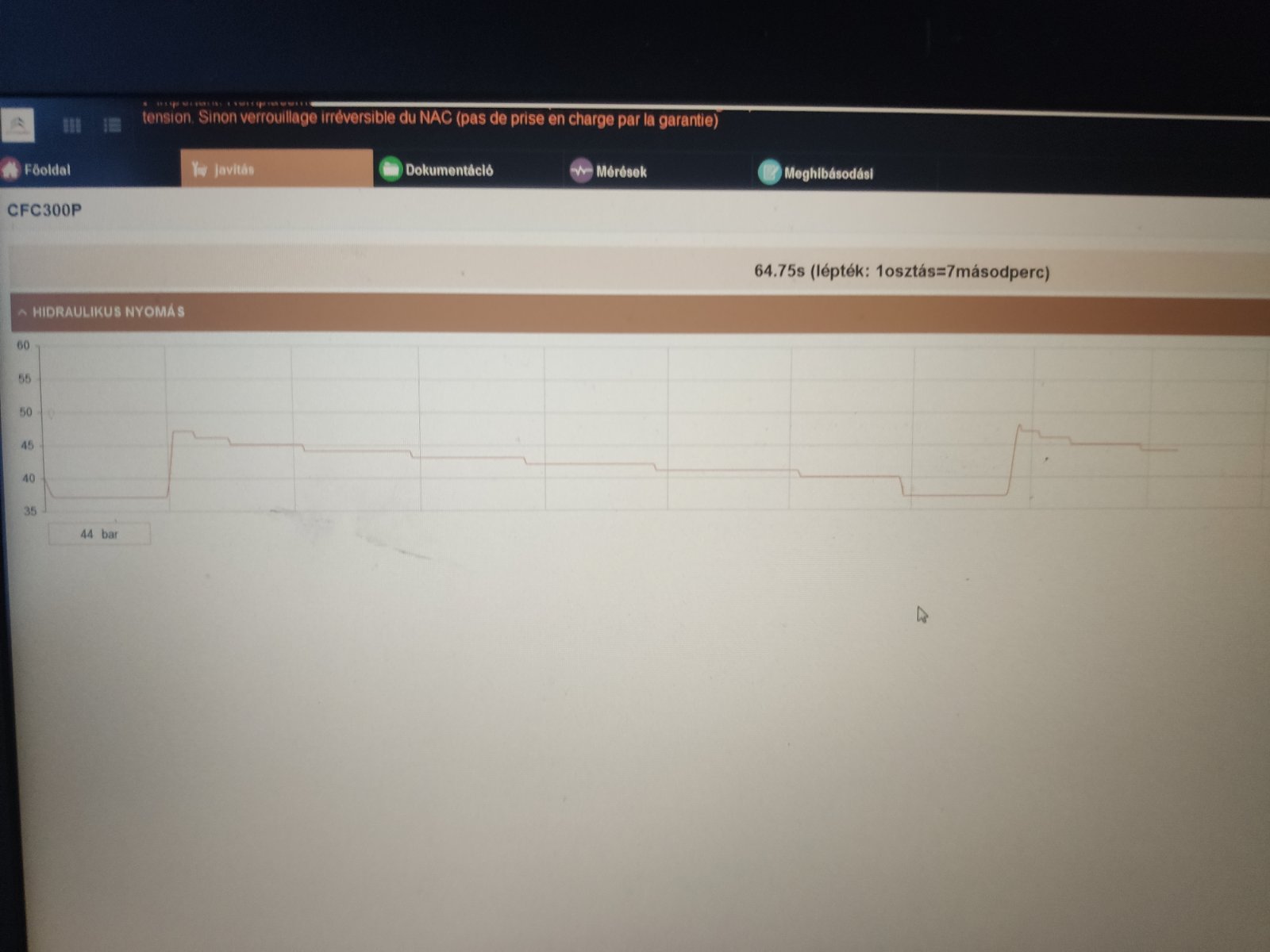

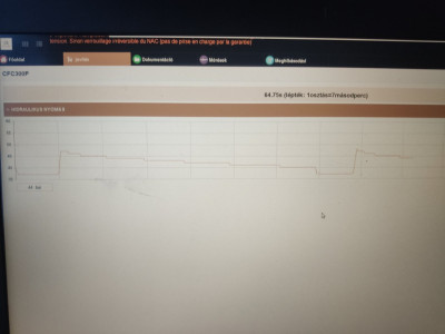

Today I made some test with diagbox. Firstly I got a new error code. P0868. Too low pressure. I searched this error code on the internet and I found a russian video. He had this problem. He disassembled the control unit and he replace the actuator accumulator and the problem was solved. I think I try this method.
Sorry it is contain hungarian language. Hidraulika nyomás= Hidraulic pressure.
Continuously it is losing the pressure and the actuator motor working when the pressure is too low. The actuator motor make a normal pressure and right after the pressure fall slowly when the pressure is good.
You can see this process on the picture.

I solved the problem. Currently the MCP6 gearbox is working. The problem was with hidraulic pressure holder. I had to change this part and the oil because it was very dirty and I washed the oil reservoir. Tutela cs speed is the proper oil for the activator.
