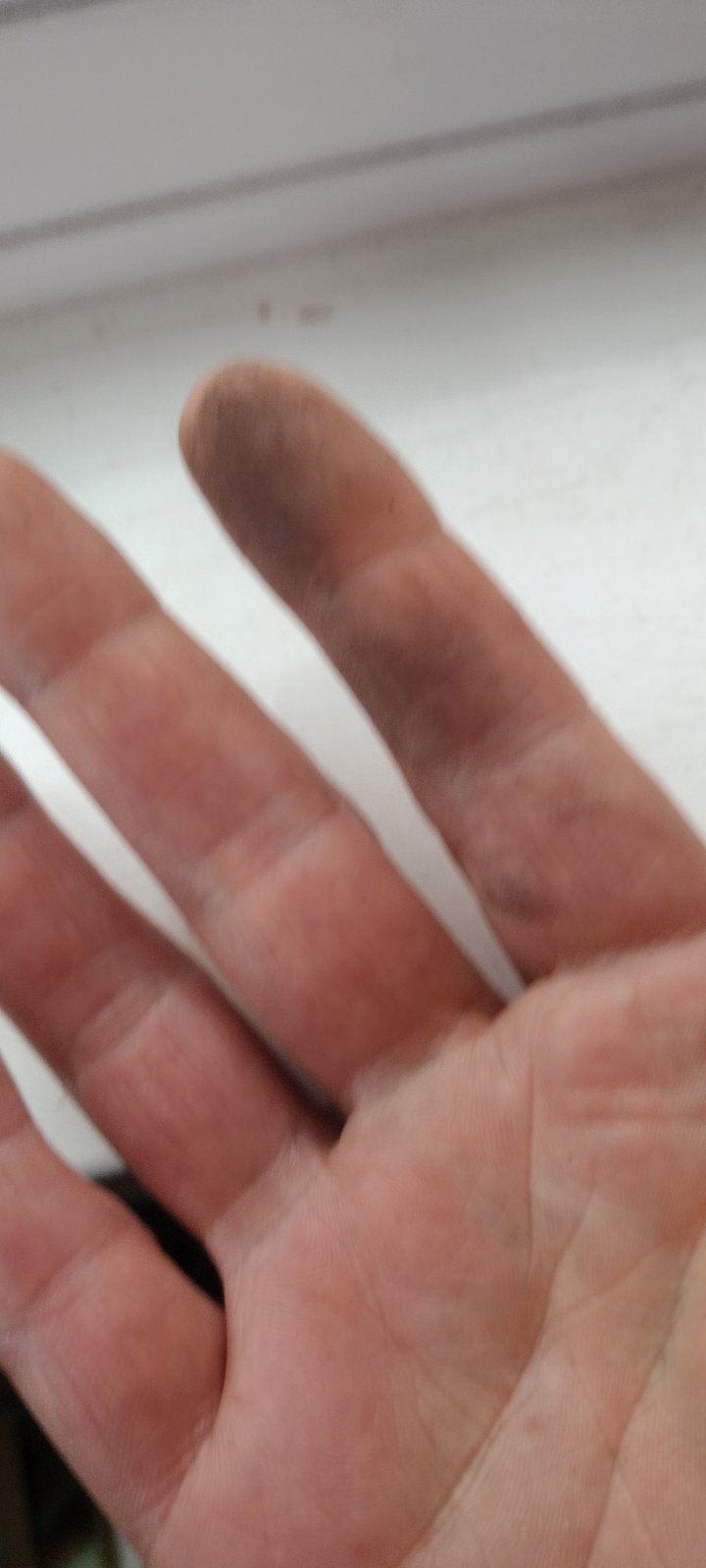

Stick your finger in the tail pipe, if it's got more than a light covering of grey soot in it, the DPF is shot. Best to get an OE used one - aftermarket ones can be (very!) poor quality.

Many thanks to James, Marc and Richard for your valued advice. For reference, when I put my finger up my tailpipe it comes out very black indeed

DPF broken then. Get another one put in!
